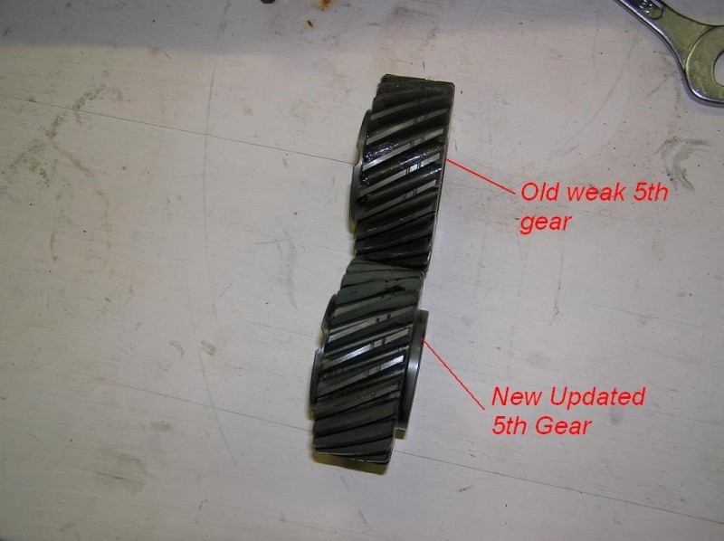

PS: A number of the early Y61 shape (say between 1998 and 2000) models had a weak 5th gear. This was fixed in later models, but if you do get hold of such an early vehicle I'd suggest limiting the boost (no more than 0.8 bar) and not using 5th gear for towing unless you KNOW that you have the uprated gear. A quick check (according to various forum discussions) is to drain the gearbox oil to see if it is reddish-brown in colour. If it is, you may have a weak gearbox! Here are some pictures of the weak & the improved gears & splines - thanks to the unknown person who posted them originally!

5th gears - new and old
