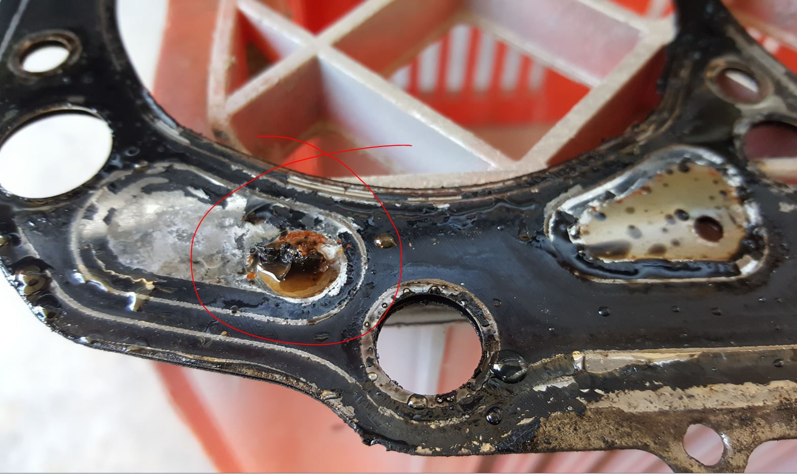

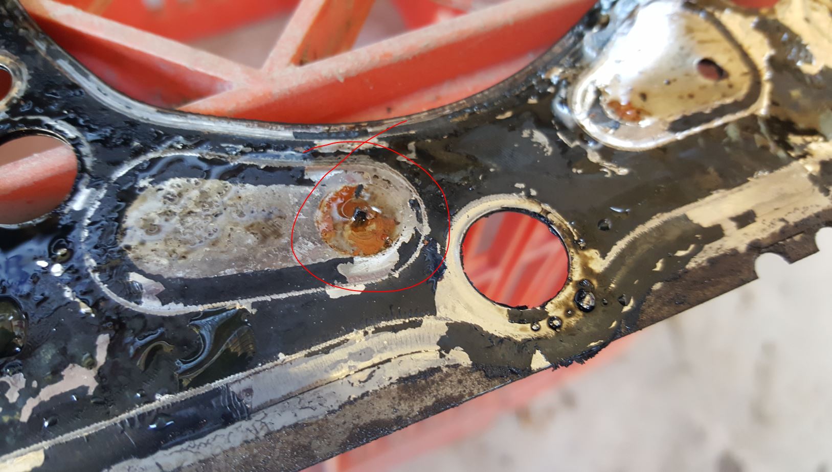

Re: ZD30 Pressurized cooling system

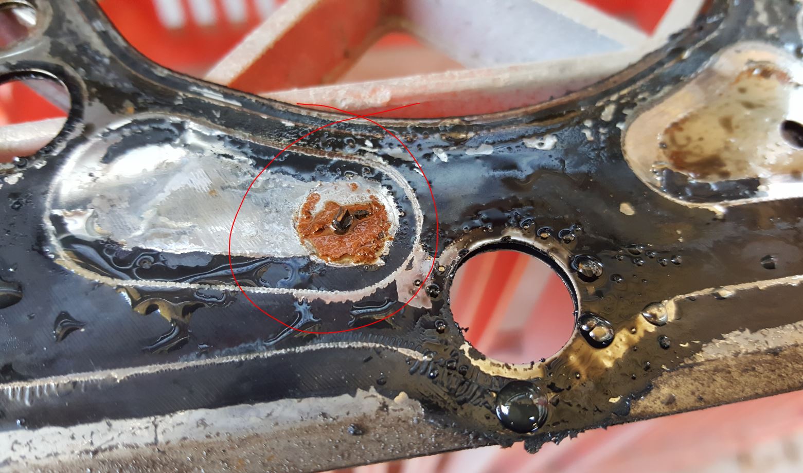

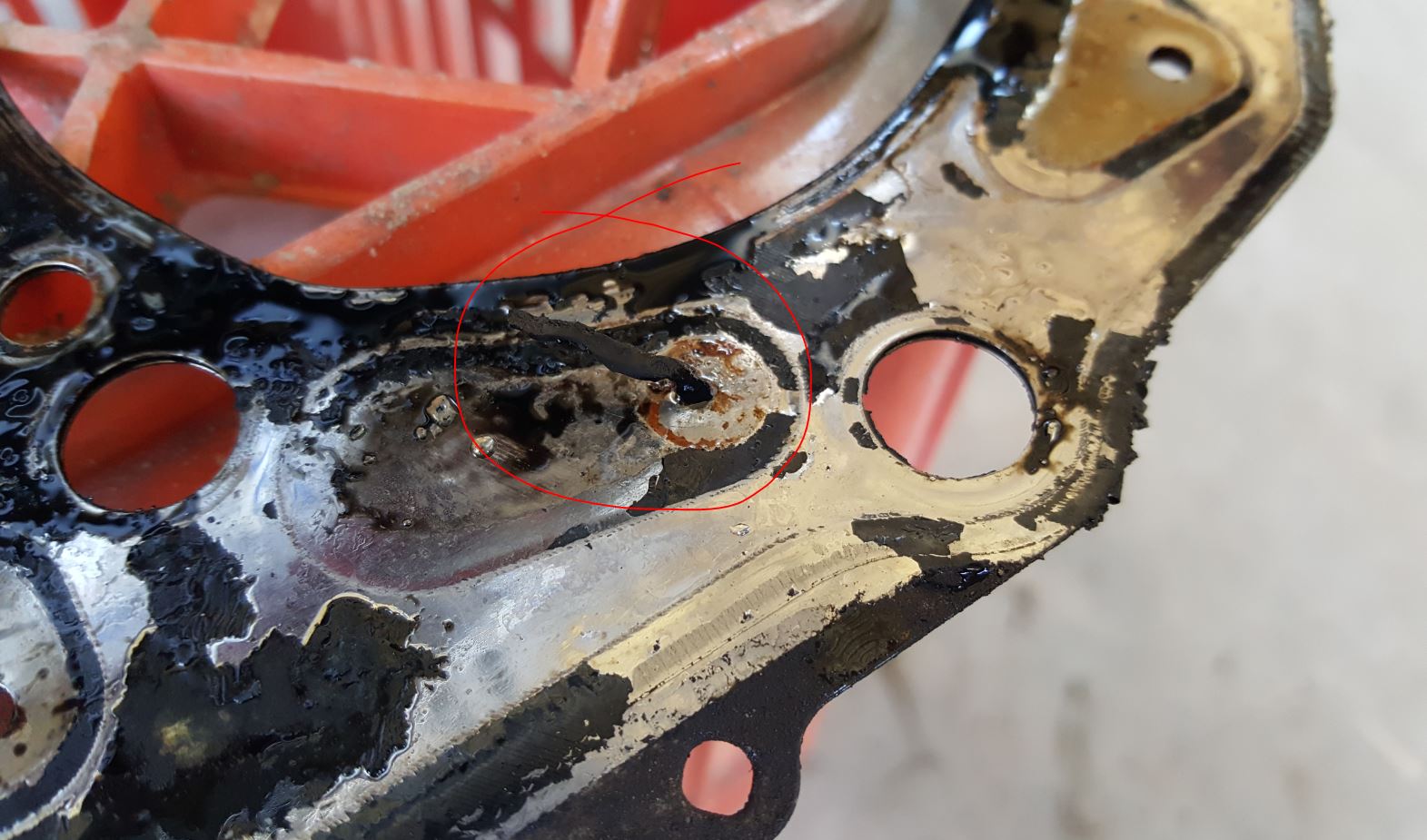

And here is what I have found on this engine....... silicone have blocked 4 of the water holes in the gasket between the head and block.
So for everyone that is using silicone on anything to do with the cooling system, be very careful on the amount of silicone you use. If you use to much the excess silicone will come loose and will be in your water system.
- Clearly you can see a long piece of excess silicone here
- Head Gasket 4.JPG (189.12 KiB) Viewed 6346 times
- Head Gasket 3.JPG (201.61 KiB) Viewed 6346 times
- Head Gasket 2.JPG (220.4 KiB) Viewed 6346 times
- Head Gasket 1.JPG (199.56 KiB) Viewed 6346 times

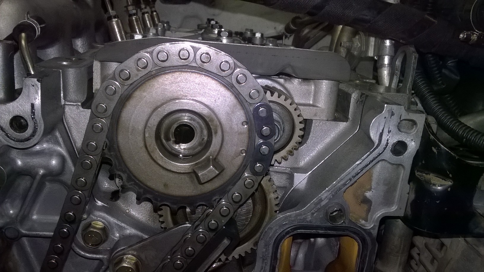

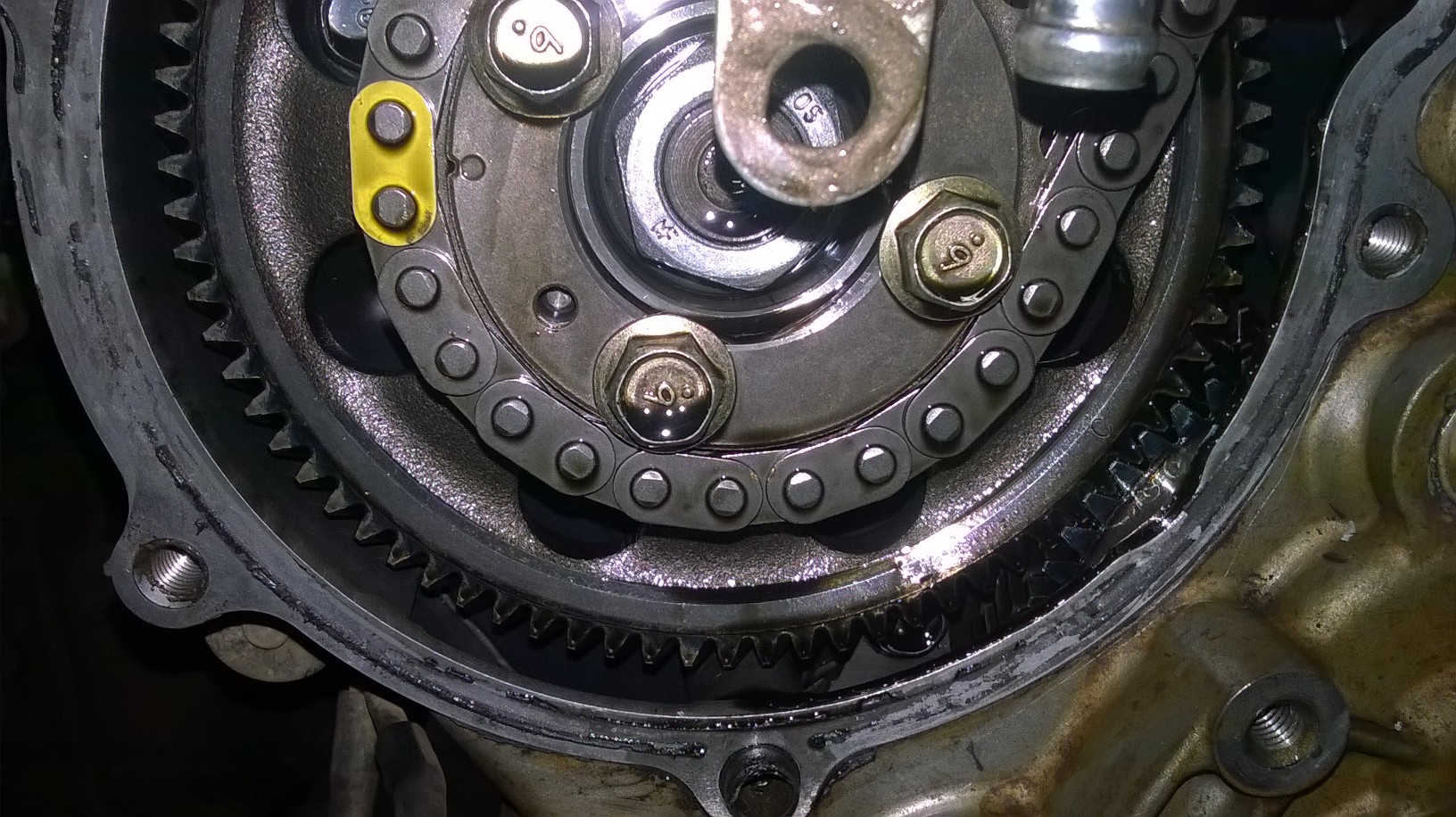

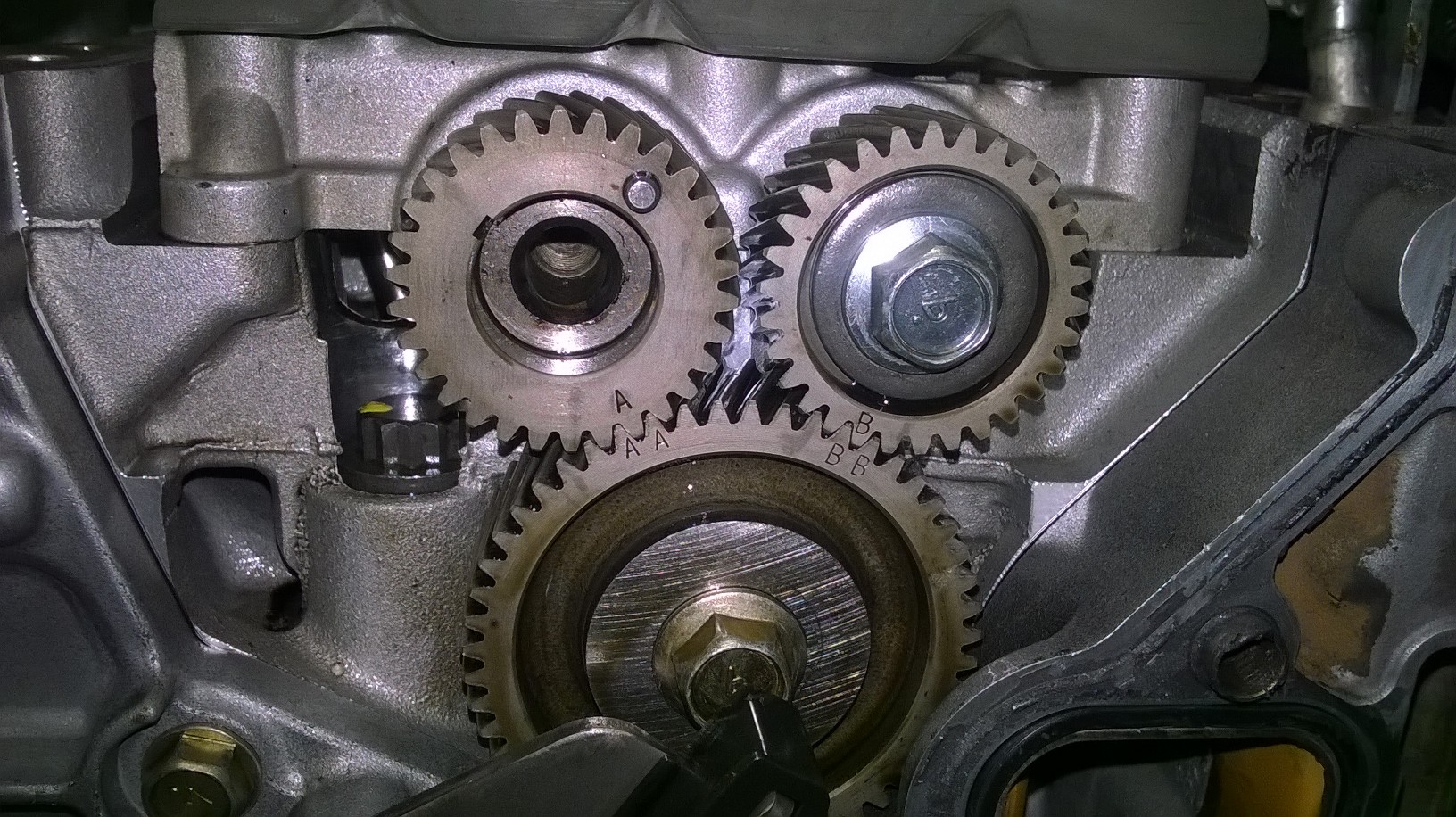

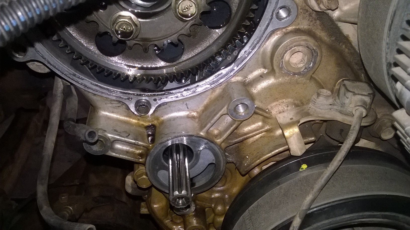

Ok. Got e erythema back. Reassembled but can't get her started. Pulled apart again to check timing, setup again put back and still not starting. Need some help here guys. Here are some pics.
Will check compression tomorrow. So far I'm pretty sure timing is right. Glow plugs work. Not so sure I'm getting diesel although she smokes a bit so should be getting Diesel!
Argh!
Argh!
Dale
Your timing is 100% so no problems there.
Did you bleed the injectors properly? Loosen the injectors where they enter the valve cover and crank the engine till a good amount of diesel flows out.
If your fuel is blead then maybe double check if you connected the right injector to the right place at the pump. Its pretty hard to screw this up, but I once swoped injector 4 and 2 at the pump by accident.......
Last thing, the one I was working on also also had some trouble starting. I actually had to push the accelerator open to get it going.
Please keep us posted
Thanks Michael.
Gonna give it another bash this morning. Will try bleeding injectors and the accelerator trick as well.
Like u said it's pretty hard to get the pipes wrong but will triple check that again.
Running. Battled to bleed injectors. But running now. Just waiting now for my new tensioner... then can test drive but all seems good.
