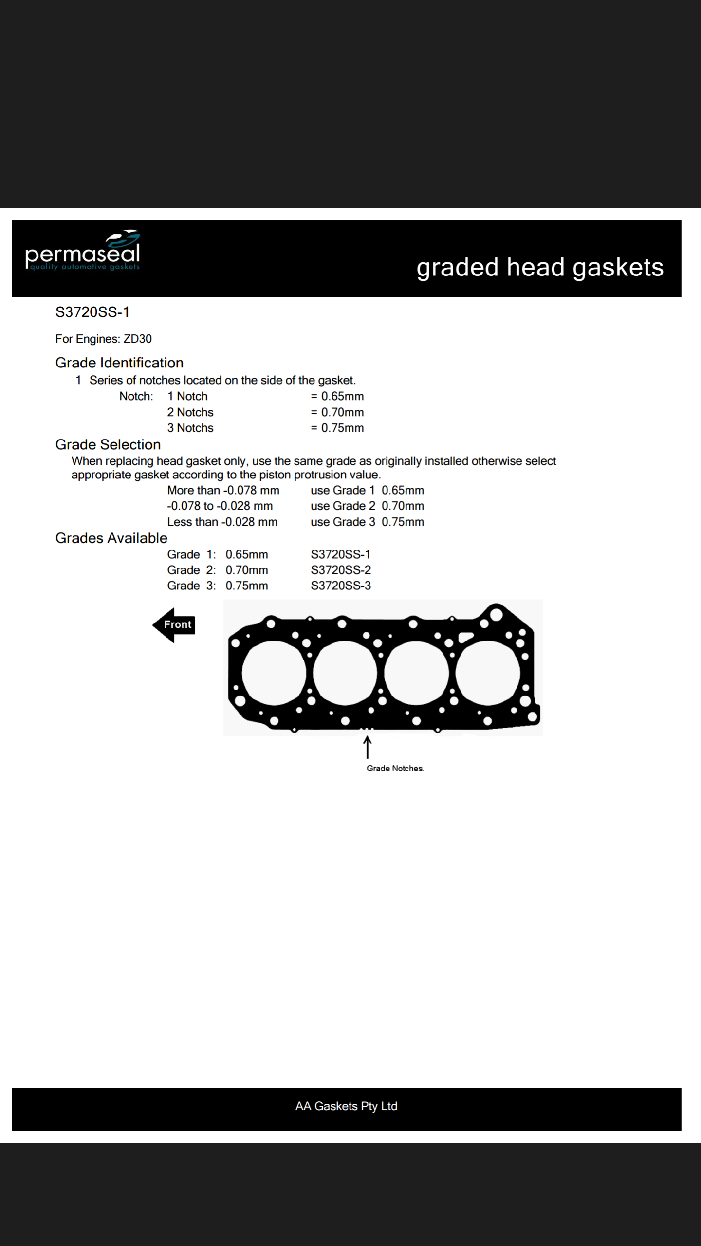

Dale, you will have to get a dial gauge and measure every pistons maximum protrusion above the block. This will determan what thickness gasket you should buy.

Yip. Looking for the measurement. More I look more I find dodgy. Seems previous owner pulled a fast one...

Here is a screenshot of the available gasket sizes according the deck hight.
I dont think the valves need to be replaced unless the engineers think they are worn to much on the guides or burnt where they seat. Valves usually last forever and rearly need replacing.

Michael wrote:Here is a screenshot of the available gasket sizes according the deck hight.

Picked up my head and gaskets from Alert today and dropped at engineers. Will have everything back next week. Quality looks good. Do yourself a favour and just get the full gasket set. It has everything I can see I need. Top end set was missing a few bits. Doing this with no time is taking Forever!
