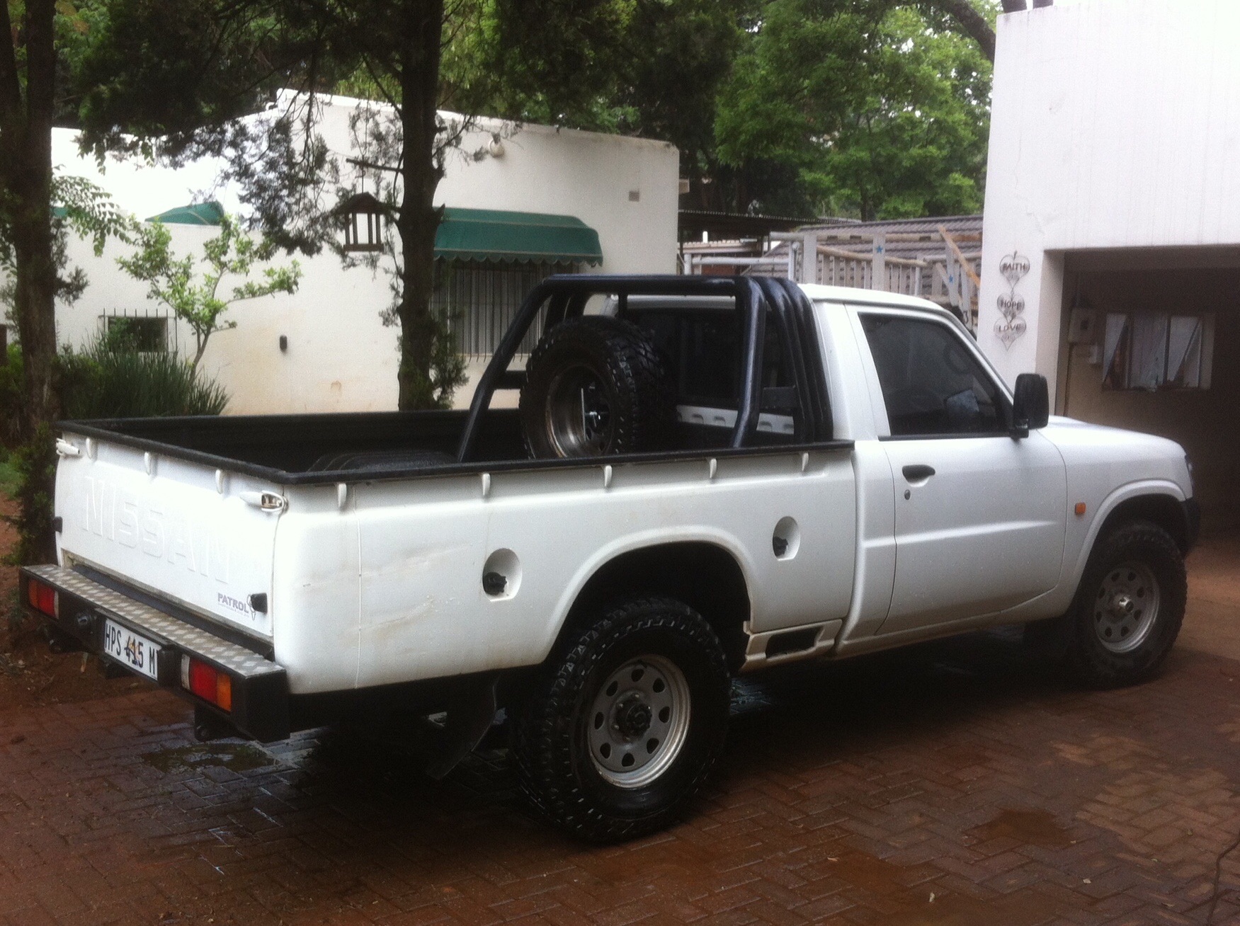

Installed window smah & grab today. 35% side windows & 20% on rear window. Cartrack got a 50% discount promo running for the month of October, it cost me only 500 bucks.
Next on my to do list:
1. Install madman (egt + oil pressure) - already have the unit and senders.
2. Snorkel.
3. Turbo boost gauge. (Still looking for one)...

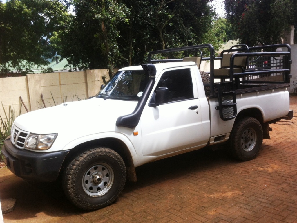

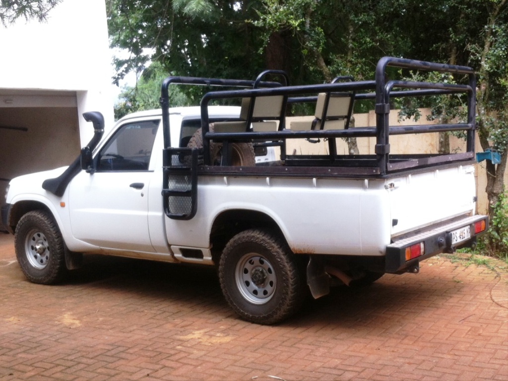

Snorkel is in (einde laas jaar gedoen).
Jag raam/tralies wat op landcruiser was, 11cm weier gemaak en gister gefit.
madman is ook in - moet net oil pressure sender se earth uit sorteer en pod laat maak.
Volgende op wishlist:
boost gauge - klaar online gekoop, in die pos.
rims swart plastidip.
bucket seat - swop with Russ's 3/4 bench seat.
canvas canopy
suspension upgrade - sodra budget dit toe laat. :redface: :lol:
replacement bumper
rock sliders..
