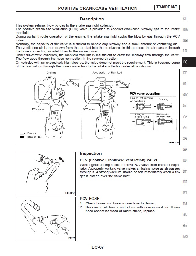

Maybe you can also clean the PCV to get better fuel consumption - I did this with my 4.5 Patrol and get better fuel consumption.
- PCV-48.jpg (171.16 KiB) Viewed 6101 times
