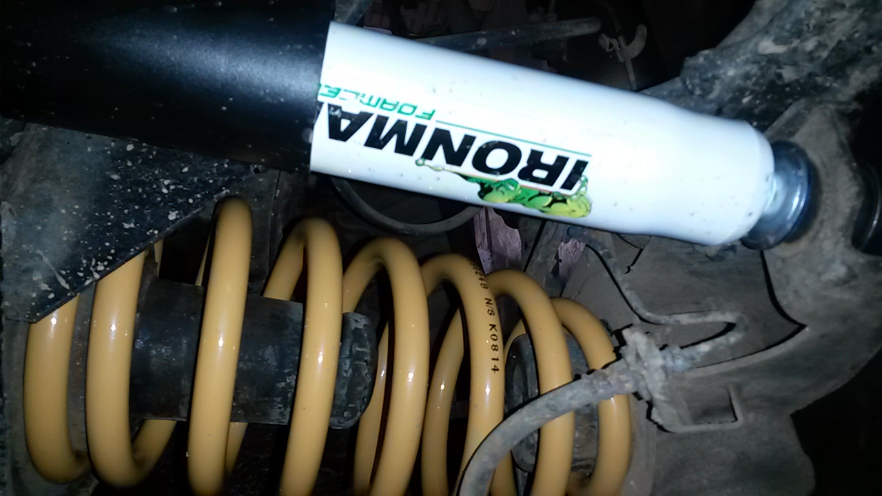

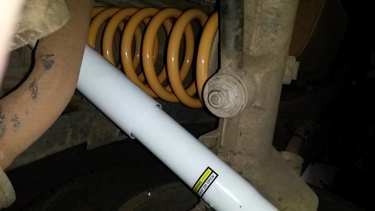

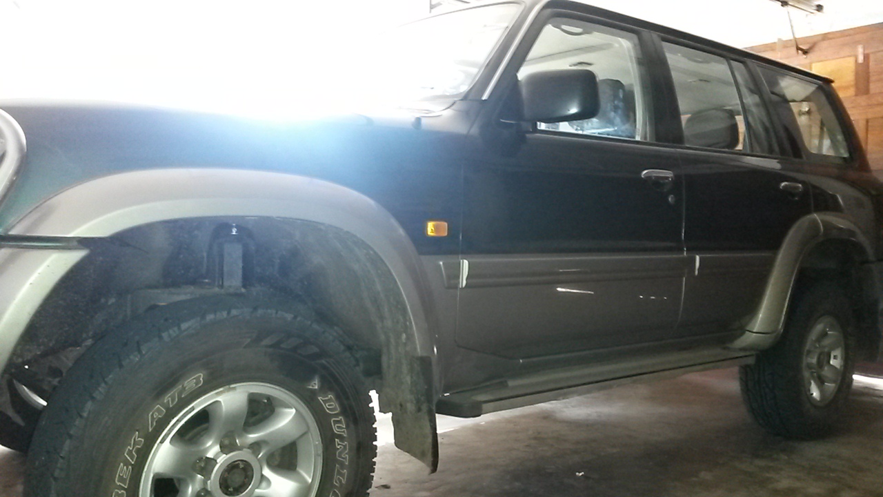

Upgrade done yesterday, and I gained about 60mm in terms of lift. The distance from the bottom of the rim until the bumper is now 820mm... Truck feels huge. :)
Ride is a little harder (I was expecting this) but fantastic.
A few photographs (as per Tinus request). They're not very good, as the Trol is currently in the garage.
The 'trol as she stands now.
Front coils and shocks.
Back coils and shocks.
