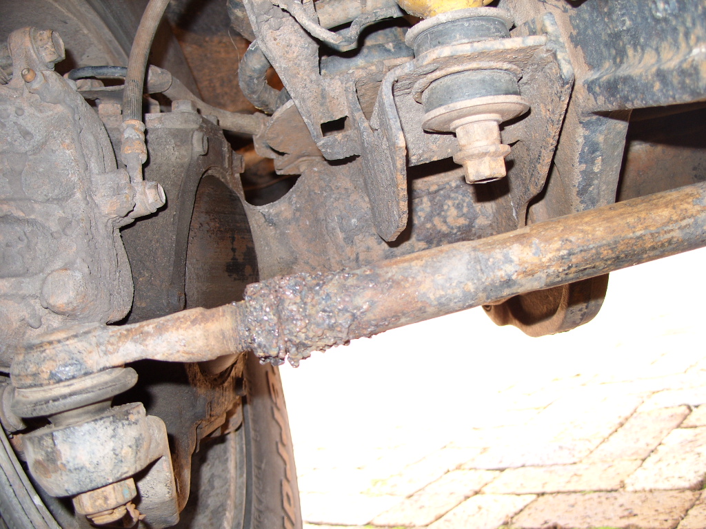

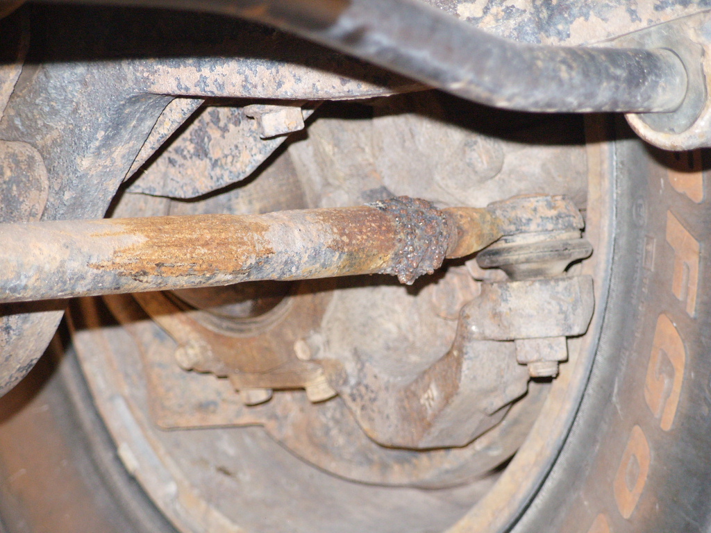

As luck would have it, we were in Deception and at the end of the trip when the steering rod arm ripped off of the tie rod end. It was the first thing in the morning and suddenly it felt as if we were either in very thick sand or had a flat tyre.
I was just trying to figure out what to do when a Landcruiser pulled up with three maintenance guys from Maun in it. They had just done some repairs at a lodge in Tau pan the previous day and were on their way home. They very kindly set about to assess the damage and see if they could repair it with thread tape. I was quite surprised to see that the thread tape was nothing more than PTF tape and suggested they use my Pratley steel instead, which they did. I said I would try and make it to Rakops and find someone who could weld it for me to get me back to SA. They told me that just 37 Ks away was the lodge and they had a working welding machine.
We waited the full 1.5 hours for the Pratleys to set and I drove very slowly to the lodge where they successfully welded both ends just in case. On the drive there, I figured that if the Pratley did not hold, I would use one of my ratchet straps tied around the tie rod ends hopefully holding the arm in place.
Now I pose a question. Should I have left the Troll in 4x4, or set it into 2 wheel drive as I did? If the strap failed, would the front wheels have tracked better if I reversed, pulling rather than being pushed? These were all options that went through my mind on that very long 37Ks. I look forward to your opinions.
As to what happened to cause the threads to strip I am not too sure. I agree that the nut might have come loose to allow the threads to wear away, but the Troll has always tracked well with no toe in or out issues. Before my 2013 trip up West Africa, I had the toe in adjusted. They had to take the car to a garage to heat up those nuts in order to loosen them to do the adjustment.
I always carry a spare set of tie rod ends but knew if I fitted them in the worn out steering arm, we would have no way of setting the toe in and how far would I be able to travel before they too wear away.
I am rubbish at taking picks but am going to include ones showing the welding and perhaps some that Kenda took.

Hi Barry, what was the cause? Surely a very abnormal event in any vehicle!when the steering rod arm ripped off of the tie rod end

Barry
Those tie rod arms are very strong on the patrols and will only fail under extreme conditions.
In your case I suspect the heating when trying to loosen the nut , damaged the metal and most probably was not fastened properly afterwards.
When loose , it would rattle until the thread is no more. I would go and have a chat to the people responsible.
Generally , welding on any critical component is not permitted and renders the component unusable. In this case , it was an emergency.
The female end is cast iron and the lock nut is steel. Not compatible with normal arc welding. That will explain the "hoenderkak" welding. It would not be something I would trust my life on.
I trust you have replaced the whole tie rod.
Chris.
