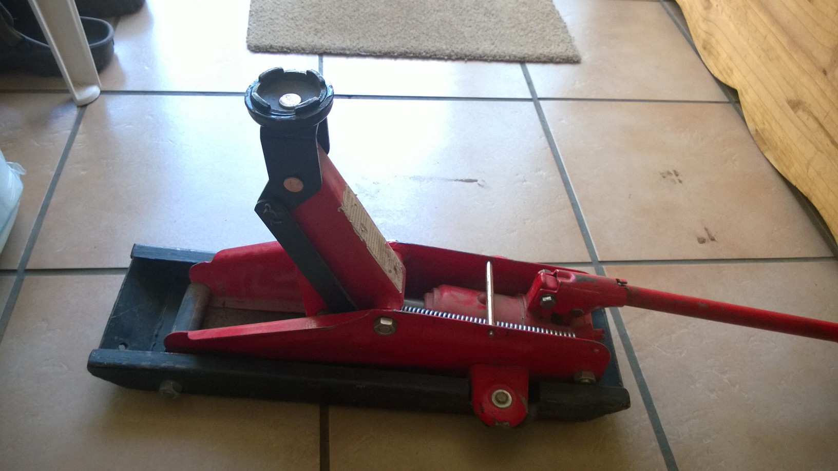

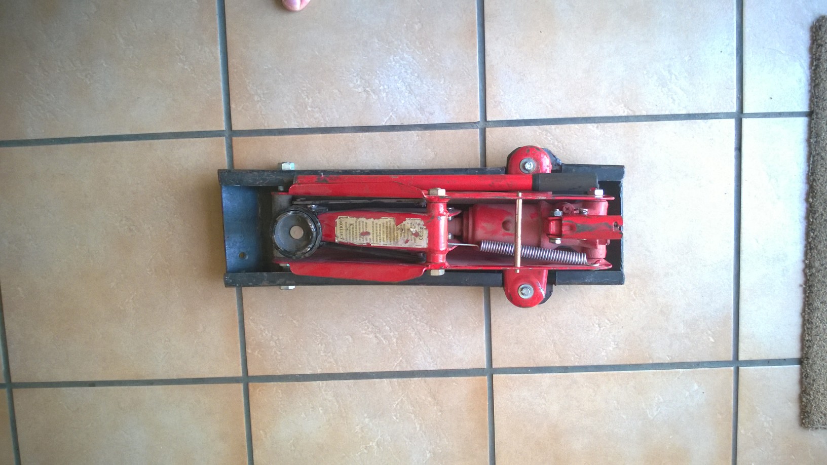

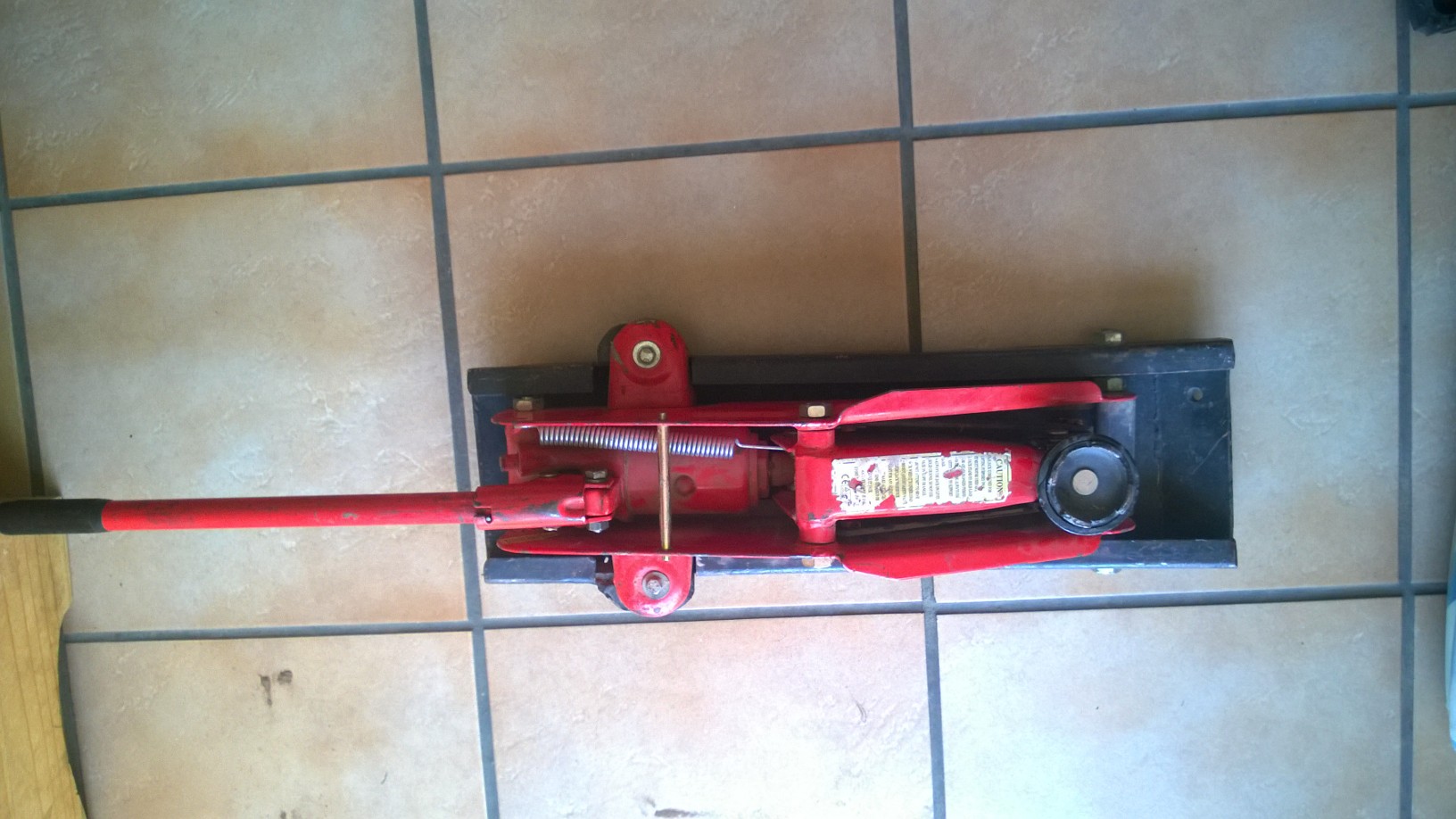

What I do take with in the event of ??? kokko .. are the air jack and then I have a TWO TONNE Trolley Jack [that Pietpetoors converted for me when he was still a NISSAN man [before he went South and now owns & runs Hi Lix forum .. sies piet
I also carry planks to give the trolley a bit of hight. I fit it under the axle, near the wheel an UP she goes. On the Prado I sommer jack on that SUPER bash plate P C made for me and the Prado [Dankie weereens mnr Connan
It is MUCH safer than the notorious "tumbling sideways" hi lift jack. - It works baie makliker
- You can even work underneath the car with it on the trolley jack [and 2 tonne is enough for my use]

The car I do the Outreaches with, the Prado, has only hi lift points on front bumper .. so the hi lift is stored till LOBO comes out of hospital ..
