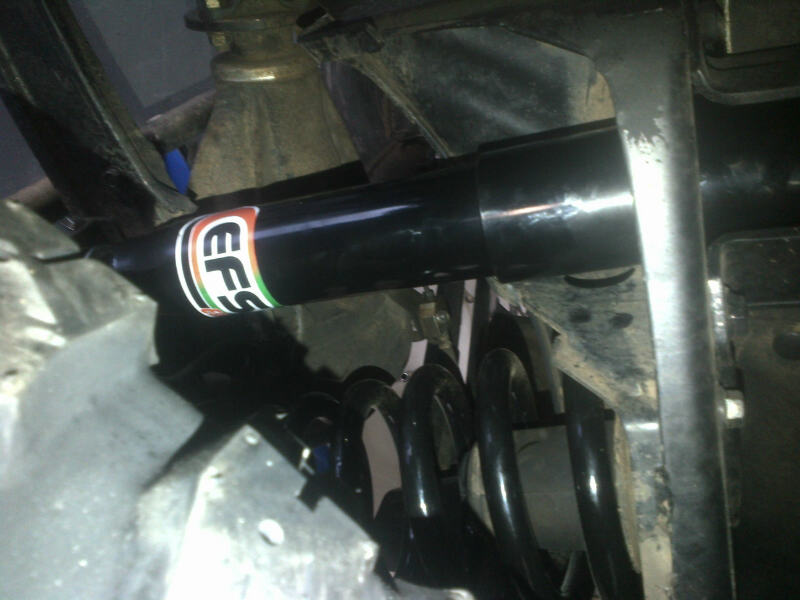

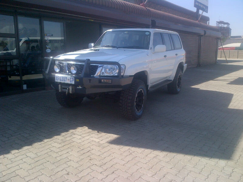

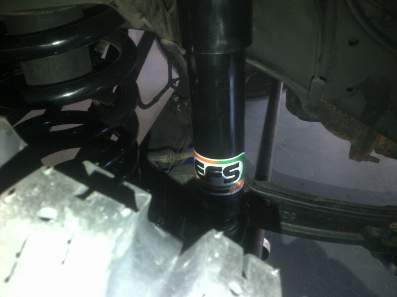

Patrol fitted wit EFS suspension and 285/70R17 Maxxis MT762
- EFS Suspension
- Meyerton-20140503-00169.jpg (57.55 KiB) Viewed 12734 times
- EFS Suspension
- IMG-20140503-00168.jpg (48.44 KiB) Viewed 12734 times

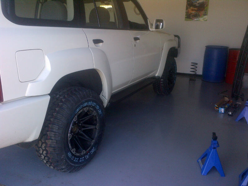

- After Fitment
- Meyerton-20140503-00175.jpg (73.78 KiB) Viewed 12734 times
- After Fitment
- After Fitment
- Meyerton-20140503-00170.jpg (58.09 KiB) Viewed 12734 times

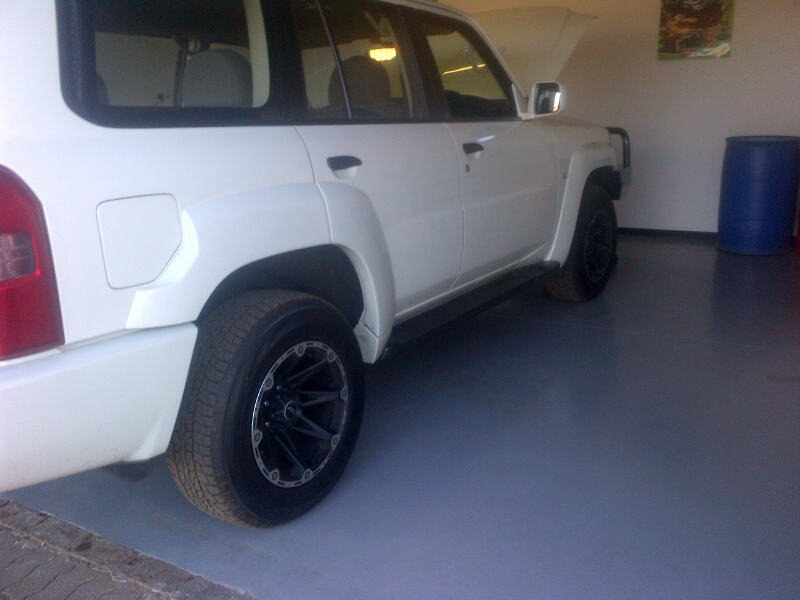

- Before Fitment
- IMG-20140503-00167.jpg (50.72 KiB) Viewed 12734 times

Looks great, how's those Maxxis noise, etc and cost wise? I've currently got 265/70/17's Yokos, are the 285's much worse fuel and performance wise? I've only got about 3-5k tread left

Morning all, thats my new baby so let me answer the questions quick.
Lift was more than expected, about 100mm at the front. But this was because the front springs were shagged. I had about 20mm clearance to the bump stops!! this was the main reason for the new suspension.
It was however a medium EFS kit that was installed so as to cater for the bumper and winch. At the rear I went for +100kg as I dont really load the car. I pull a trailer for all the camping junk.
She rides quite a bit firmer that I thought she would. But I am quite sure she will settle and I will grow accustomed to the setup.
The tyres... have a chat with Riaan. The price I paid was very competitive. Size is 285/70/17. We are just looking for a rim for the spare so I can sort that out.
All in all I am very happy.

To answer the otehr questions, fuel wise I suspect a drop in economy but have not got enough miles under the belt on this car to quantify.
Noise, yip they are noisy.
Size wise, well on the 3 litre diesel I actually have to use 1st gear now. Previously I had no need to use first other than on an incline.
Speedo is not close to correct. About 4% under. 110 on speedo is about 115 on GPS.

Thanks Dale and congrats! To be more specific with noise, I know all muds hum, no problem but with the 285's do they make a knock knock / clapping sound? I had a pair of muds at that profile and they were "clapity", my 265/70's no such noise just humDaleB wrote:Morning all, thats my new baby so let me answer the questions quick.
