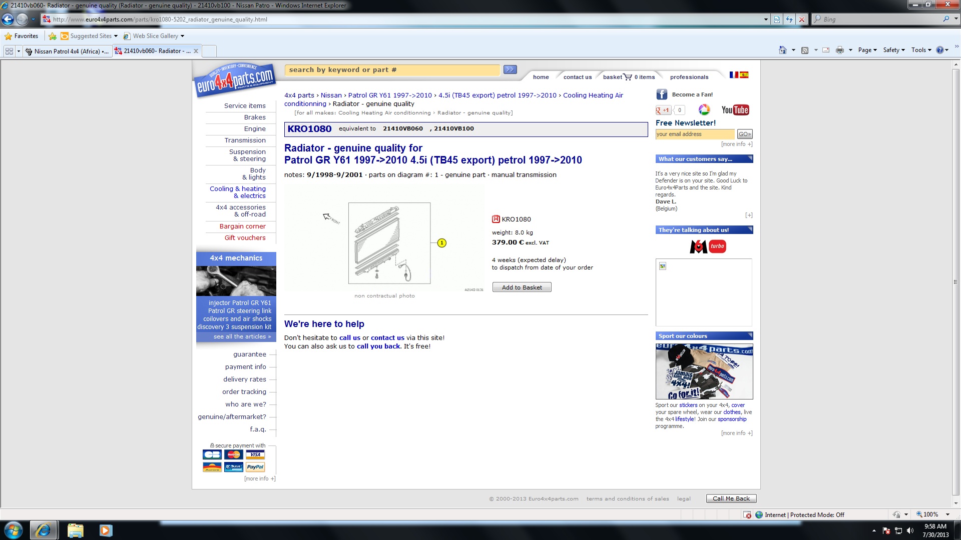

Hi Marinus,Marino4x4 wrote:Johannes
Another option is Euro4x4parts.
The big problem is to get it to SA.
