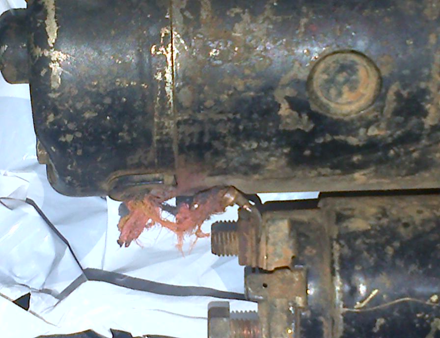

elk geval ek het so kort tydjie gehad die naweek(eers laat gister middag net voor donker) en gou na die starter geloer en toe kom ek op hierdie af....die krag kabel hang letterlik aan 'n draadjie so ek is seker daar kom nie genoeg krag deur nie
ek reken dit kan die probleem wees, en as ek reg is lyk dit darem of ek hierdie rondte kan wen sonder te veel $$$$
sal ek hom heeltemal oopmaak en die kabel vervang of kan ek maar net soldeer soos hy daar is

Re: GQ Starter advice please
Wow.... I've never seen that before... Don't know how to successfully repair that. I would assume you would have to open that up and replace the cable from inside.... but like I said, I really am not sure what the insides even look like. At least this looks like a cheap thing to repair !!
Post by Stefan »
Leander, If you can do it, remove the lug(?) and replace with a new one, solder is just going to give you hassles.
