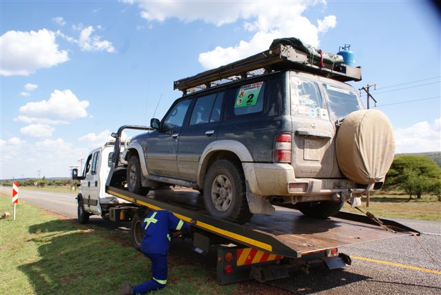

After we left the border post, we were in the mountains on the way to Zeerust and the missing became worse and the speed reduced to 70 km/h. I decided to stop and switch the engine off for a while and just before I stopped the engine died!
I removed the fuel pipes at the manifold and found no fuel to the engine - so the pump does not work! I cheched the fuses and it was fine. We found that there is a Nissan Dealer in Zeerust and I arranged with TuffStuff to get us to the Nissan Supreme Dealer. With the rollbed truck on the way, Mac asked my to start the Patrol. It started quickly and we started driving. We I noteced the truck I decided to stop and discuss it with the driver but when I took my foot off the eccelerator, the engine died again and I could not get it started again.
When we got to Nissan I explained the problem and they also suspected the fuel pump to be the problem. We had to unpack everything oot the Patrol and remove the kitchen and drawer system to be able the get to the fuel pump.

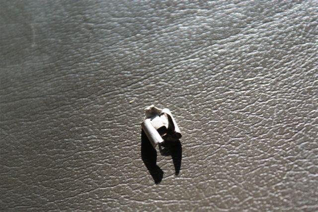

When the remove the fuel pump they found the one female connector (the positive one) disconnected. When we inspected the connector, we found some parts of it burned away :surprised:.
They expected that this was the problem and that the pump was still fine - it was to late to try and replace the pump. They replaced the connector, put the pump back and we took the Patrol for a test drive and everything was fine :thumbup:
That bad connector was sparking/burning and that caused the fuel pressure problem and heated up the fuel in the tank.
