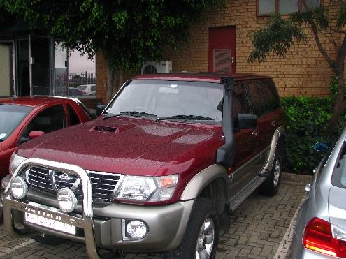

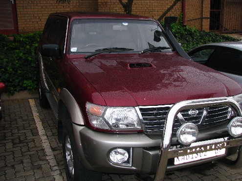

JUST See ho fortunate and lucky you are - Right here is the Patrol of your dreams:
2002 Patrol 3.0Di GRX
233000 km
(engine redone by Steves Auto Clinic )
Economical
7-seater
Automatic
New tyres [265 / 75 / 16]
Full length roofrack
Original Nissan Radio & 6-CD Changer...
Just look - His Bumper was upgraded to the 2003. The spots are directional sensitive - it swing in the direction you turn. EGT fitted; 3.0 Diesel, 4-speed Auto WITH overdrive. Leather seats.
SAC did a superb job on that engine - it's a gem, goes like a dream and pulls like a lokomotive.
Agarob ad2.jpg (181.18 KiB) Viewed 4561 times
