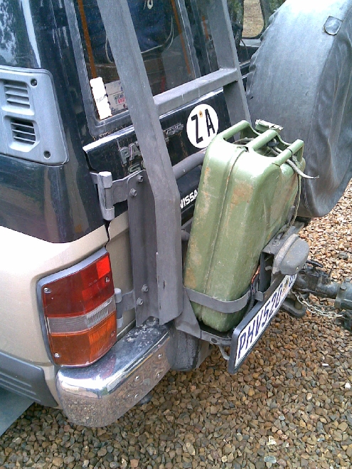

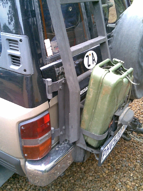

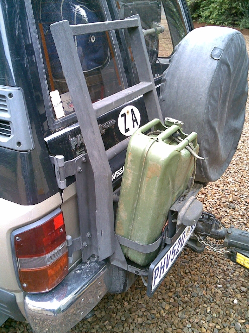

Why you need a ladder to get on Patrol roof? what you wanna do up their, You kids up to mischief again? - Just stand next to the car and put up what you want and take down what you need ...[of i sjulle von die kort oukies?]
I'm looking for the picts, will post it asap - Friend Japie vd Westhuizen has a "home made" on his 'Trol and beats anything else I've ever seen, hands-down
OuuuuKyyyyy - found 'em:
