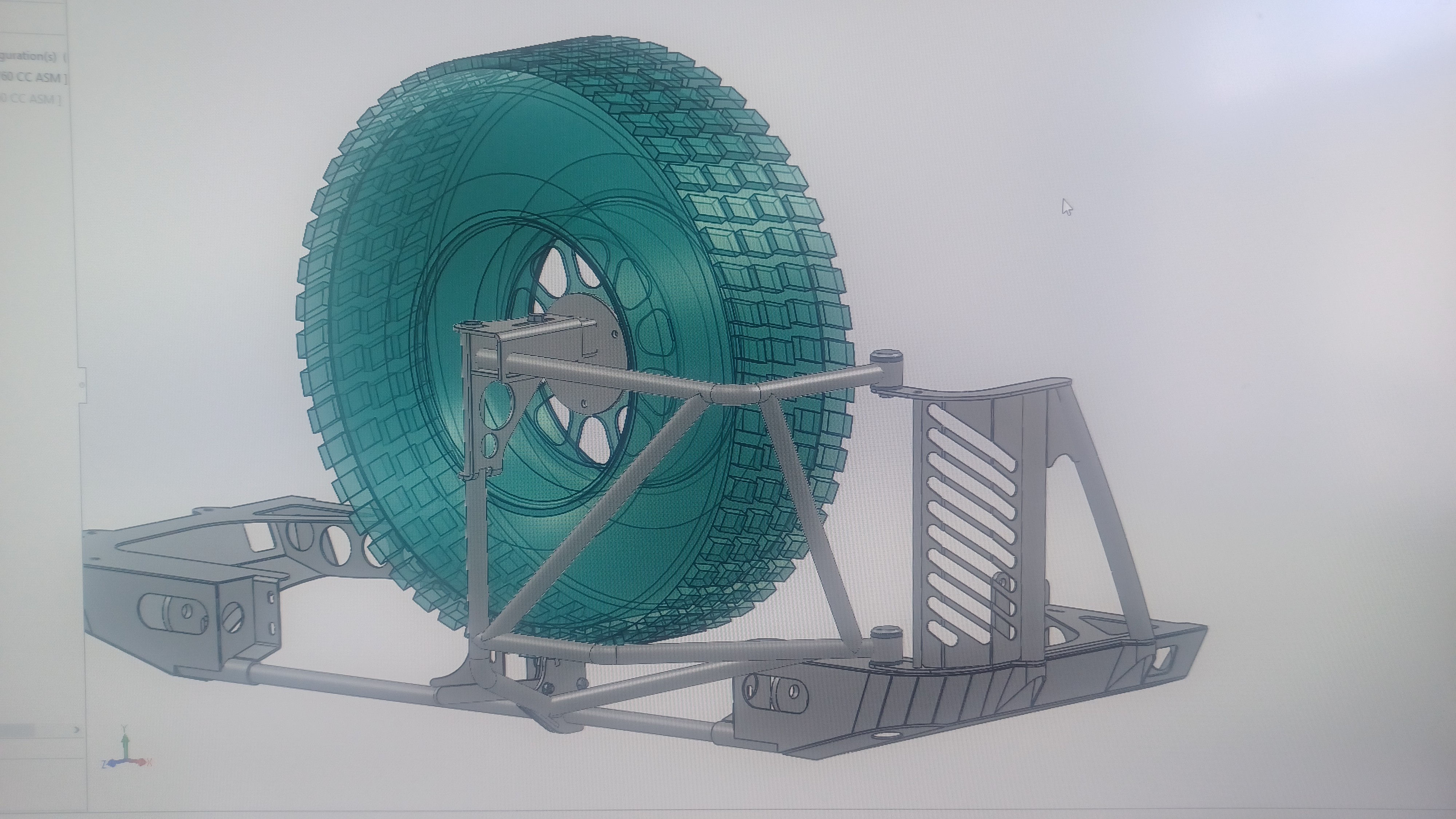

A teaser for the swing arm:
However, note that only one spare can be carried, as there isn't really room in the bumper for lights. There isn't enough room between the body-mounted lights for two spares.
The main reason I am putting the carrier around the back of the wheel is to get the wheel as close to the body as possible, to keep the weight as close to the axle as possible.
