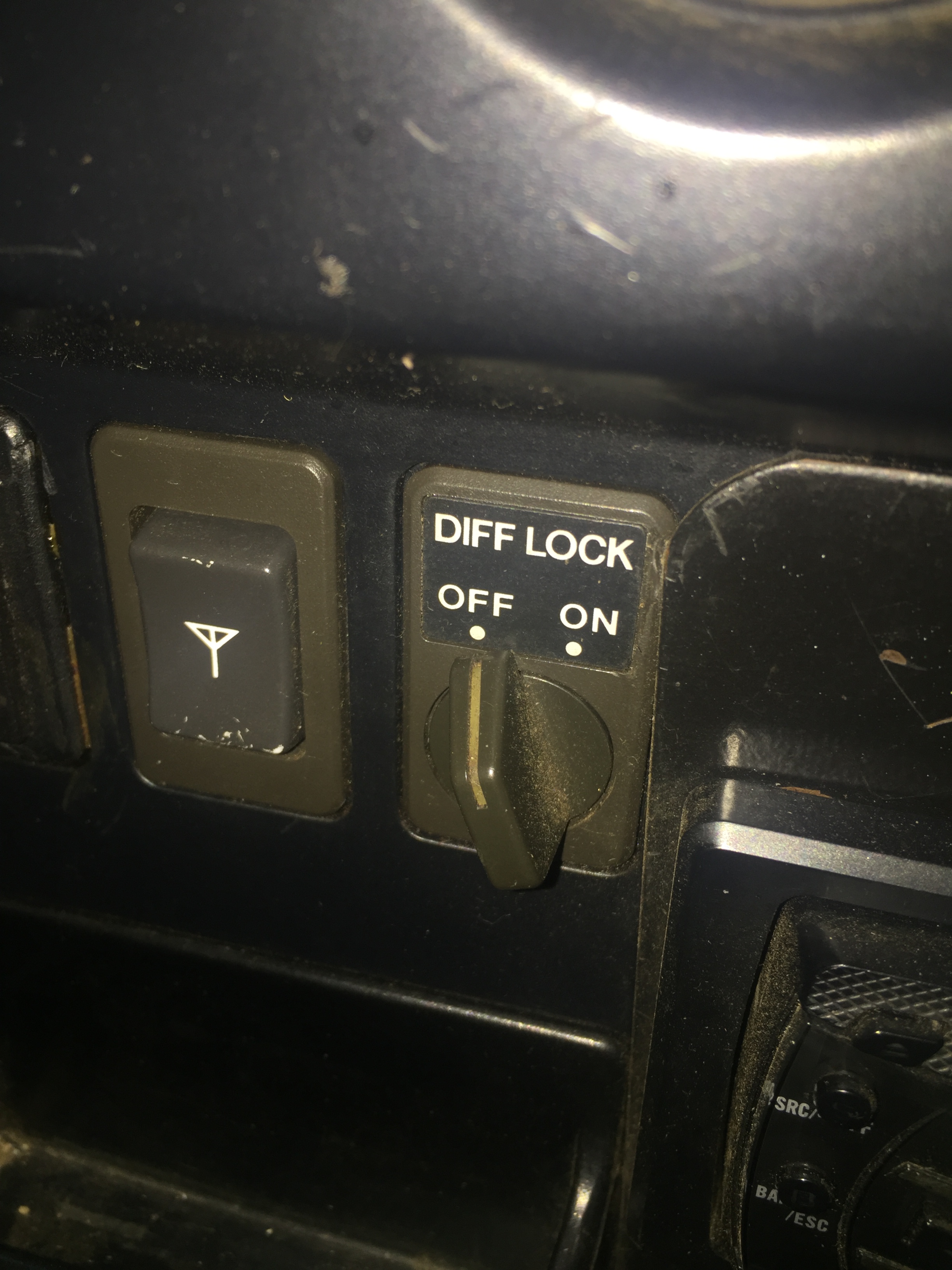

SJC wrote: 11 Oct 2023 10:22 Do you know what brand front locker is installed. Does it have a button on the dash to engage/activate the locker?
Hi again, SJC. Unless I'm misremembering, the button was actually on the central console. Unfortunately, I didn't enquire about the brand. :rolleyes:
Posts: 3356
Has thanked: 244 times
Been thanked: 217 times
Re: Value of a 1998 4.5l Patrol GRX with over 400 000km
The OEM rear diff lock will have a diff lock switch similar to the on in the pic. (this one is from my gq/y60, gu/y61 might look slightly different).
If there is an additional switch then there is most likely another (front) diff lock installed.
Unless an auto locker eg lokka is installed, then there will be no switch.

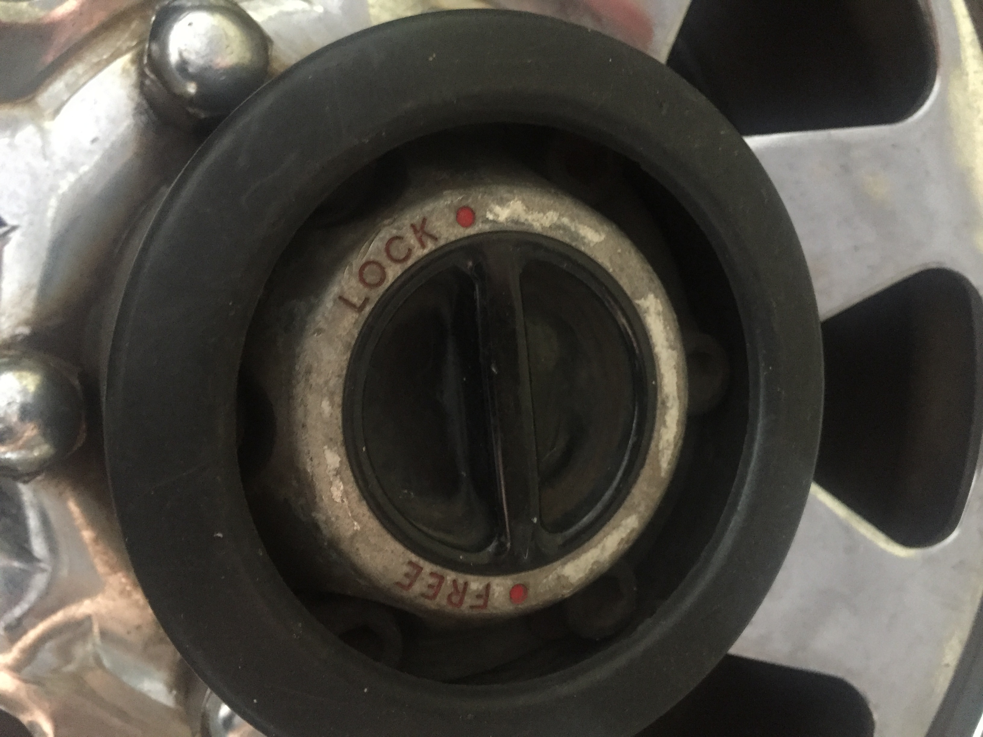

MarBar wrote: 11 Oct 2023 11:18 What I was "surprised to see" was precisely the hub lockers like those in the photo. From what I understand, which is admittedly next to nothing, the front hubs have a lock function, which I was confusing with the diff lock proper in my first post. I used the plural form because this lock function is on both hubs, but I see know it's used in the singular. :doh: When going under the car, I have to admit I just searched for oil leaks and checked the state of the driveshaft, so I didn't even notice the diff lock.
But yes, as you mentioned, the Y61 Patrol got auto locking hubs, which can also be "locked". It is usually better to lock them when driving trails to prevent them from unlocking.
The y60 Patrol and Y61 pickup got manual locking hubs. They must be locked in order to enable 4x4 drive. (yes it is does not lock the diff).

SJC wrote: 11 Oct 2023 16:26 If there is an additional switch then there is most likely another (front) diff lock installed.
I'm 99% sure there was only one switch, so this seems to settle it: most likely no front lock on that Patrol, unfortunately.

Ok, those are locking hubs, which have nothing at all to do with a diff lock.
The purpose of locking hubs is to dis-engage the drive shaft at the wheel. When these are dis-engaged and the transfer case is placed in the most forward position (2H), then the front prop shaft, front diff and side-shafts all remain stationary when the vehicle is driving.
This is done purely to save fuel. These MUST be used together. Locking one with the other un-locked can damage the differential.
However, those particular hubs are automatic hubs with a manual override in lock. In other words, if you leave them in the Auto position, and select 4WD, they will sense when the side shaft turns faster than the wheel and will lock up. They will then remain locked until the wheel turns faster than the side-shaft again, at which point they will un-lock. This primarily happens when the transfer case is put back into 2H, but will also happen if you reverse, and can happen in very rough terrain if a wheel lifts off the ground or if a rock moves under that wheel. For this reason, it is recommended that the hubs are manually locked when doing heavy 4x4 work, or in a situation where you are reversing direction. If you are just crossing some sand or mud, you can leave them in Auto.
The recommended practice is if you have used 4x4 but not manually locked the hubs, you should reverse a little bit after going back to 2H just to make doubly sure that the hubs have un-locked. If you locked them manually before engaging 4wd, this should not be necessary but on the other hand it can't hurt anything either.
Most modern vehicles that are part-time 4WD do have auto locking hubs, they just don't have the manual override into locked position and are typically covered over so you don't see them.
A diff lock positively locks one of the two side-shafts to the diff carrier housing, and since that holds the spider gears from turning, it effectively ensures that both wheels on that axle will always rotate at the same speed while the diff lock is engaged.
You are still using the plural "lockers". Is there just one diff lock switch, or two? If just one switch, this vehicle only has a locker in the rear axle. Not a train smash, still a very capable vehicle but not quite as capable as we might have dreamed.

Peter Connan wrote: 12 Oct 2023 06:35 You are still using the plural "lockers". Is there just one diff lock switch, or two? If just one switch, this vehicle only has a locker in the rear axle. Not a train smash, still a very capable vehicle but not quite as capable as we might have dreamed.
Almost certainly just one switch, I'm afraid!
