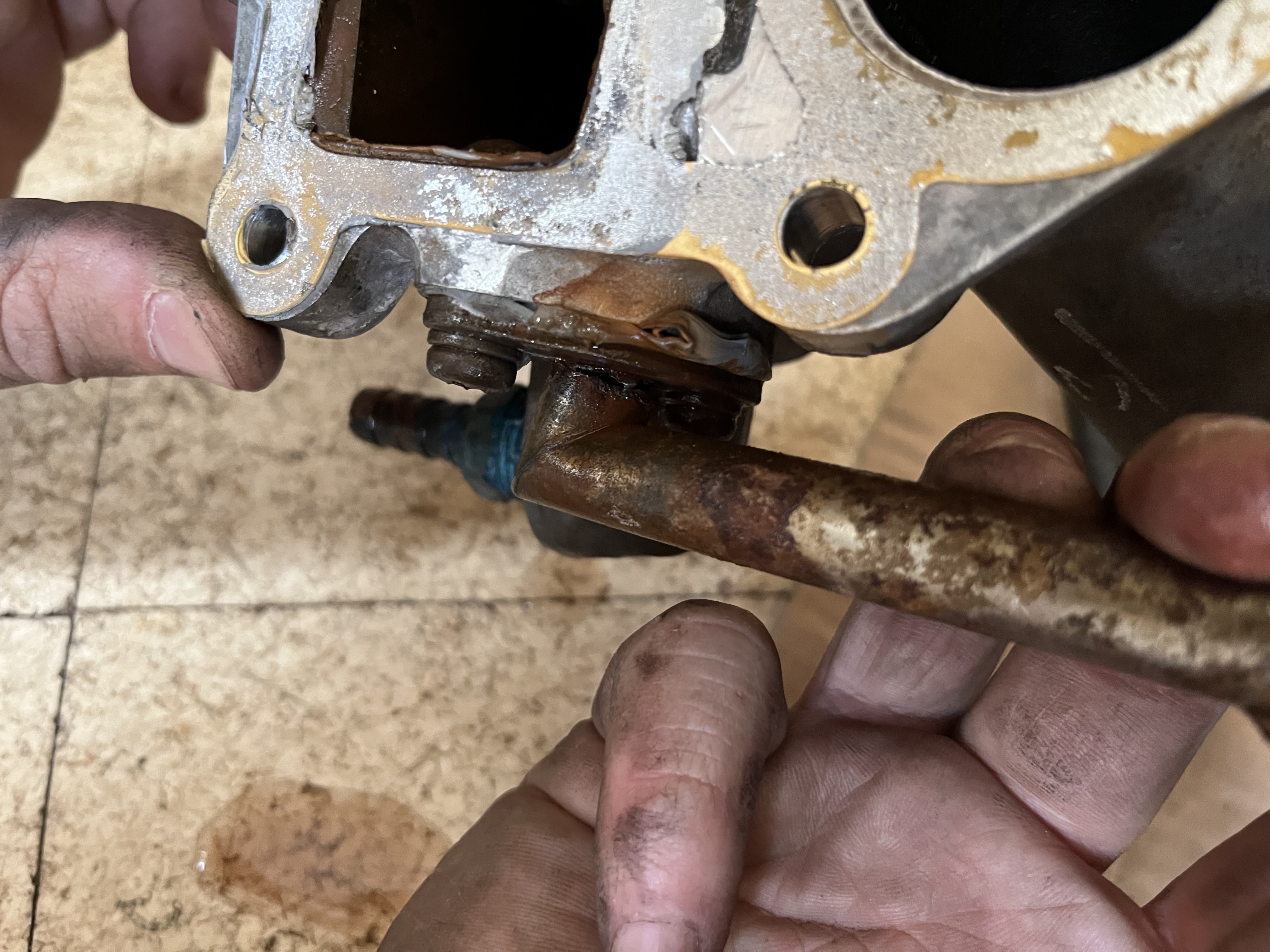

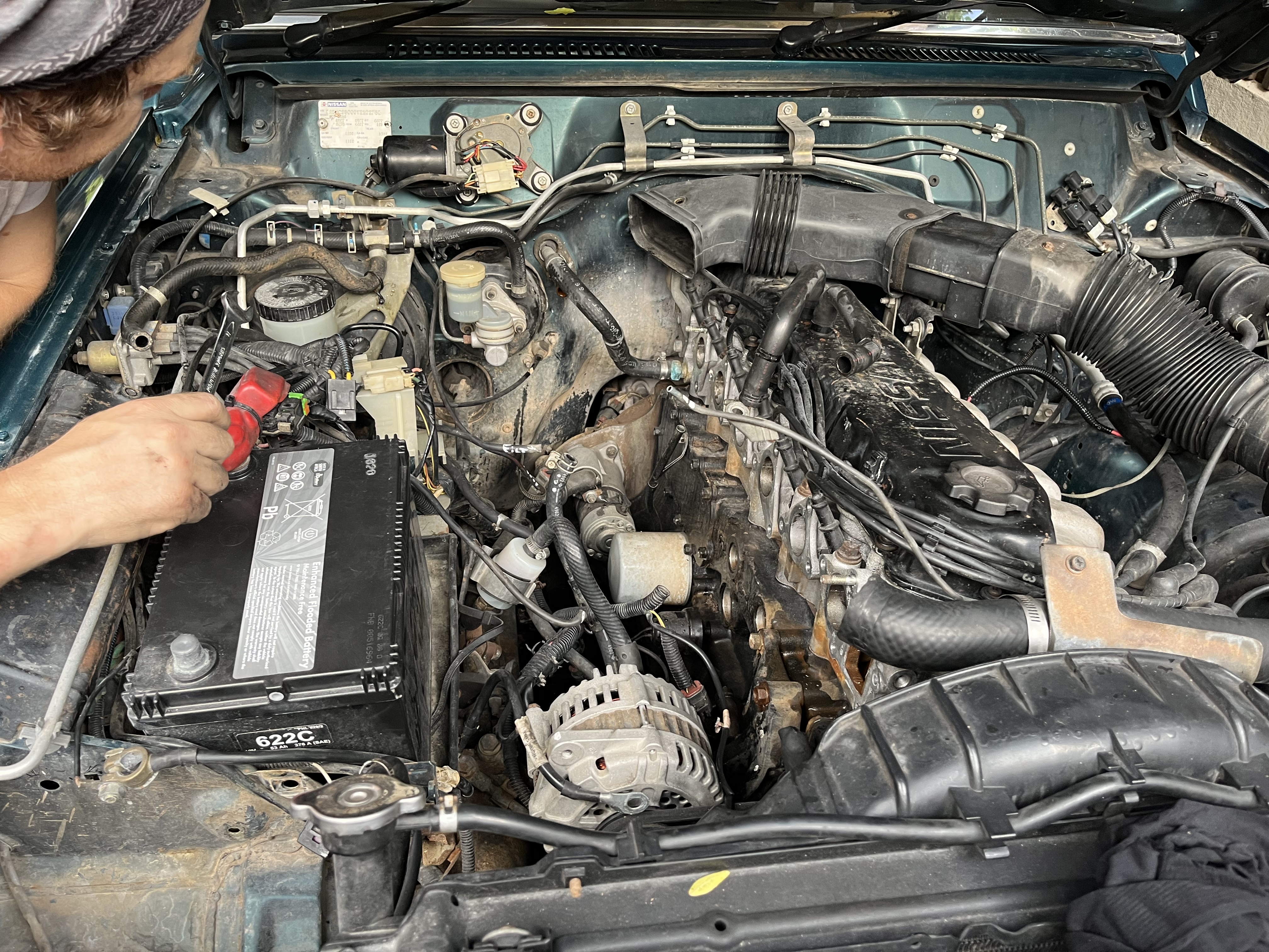

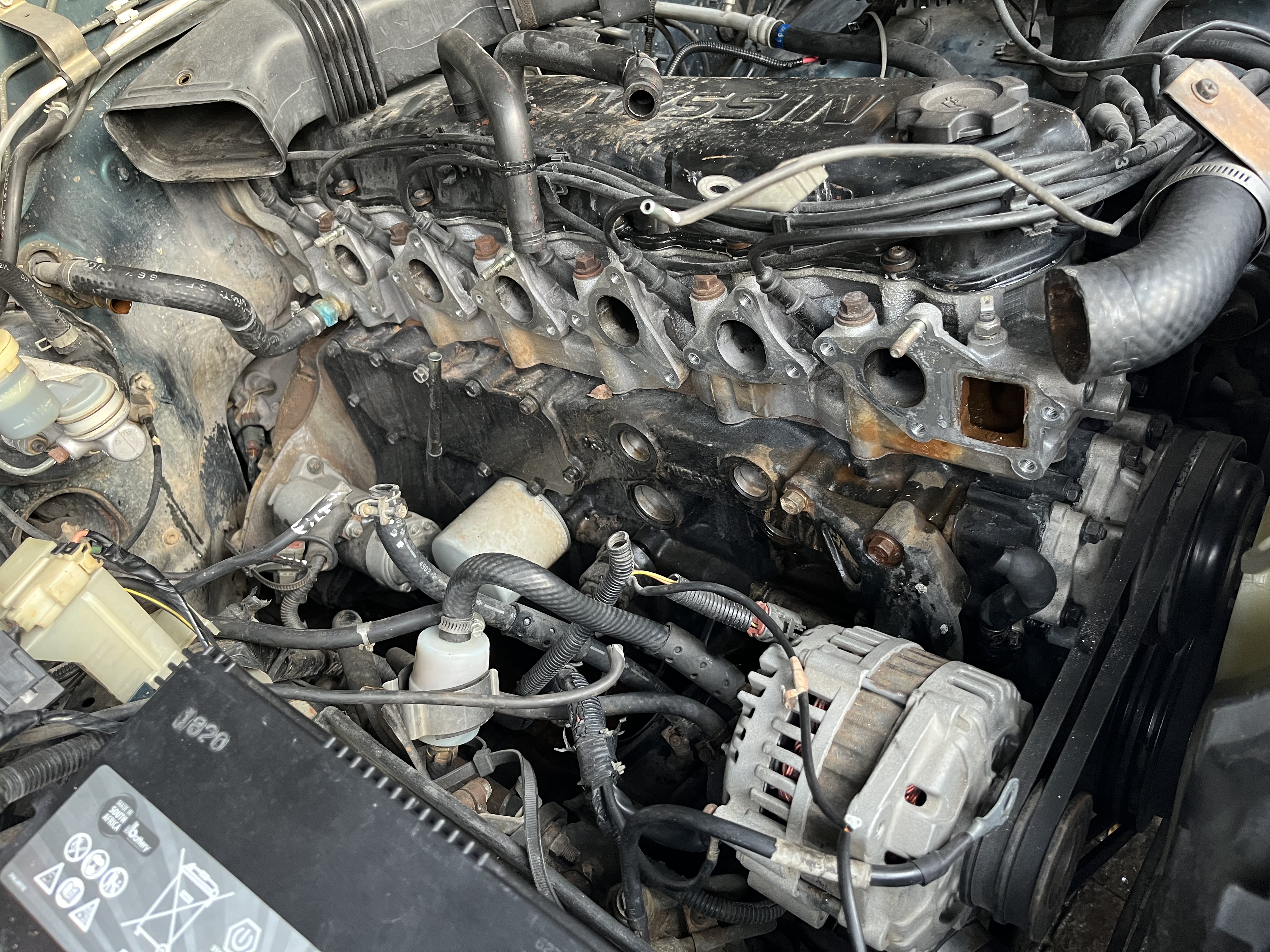

So I traced a coolant leak to a heater hose elbow underneath the thermostat housing. Very difficult to get to, so I ended up taking the entire intake manifold off. This is on my TB42S Carb engine.
The steel elbow that the one coolant heater hose connects to had a moderate drip, around 1L of coolant over 150kms of driving, when I finally located the leak, I wiggled the elbow gently and the coolant just came FLOODING out! Leading me to believe at any moment I was about to loose all my coolant during a drive, and possibly seizing the engine. Luckily I caught it in time...
Also my temp gauge isn't working, need a new sender, so that could have ended badly.
Any idea where I can get a new one of these elbows or a part number, or would I have to get one fabricated?
While I was there, I saw a bunch of coolant and vacuum hoses I need to replace. Any suggestions, recommendations to get good quality coolant and vacuum hoses in cape town, preferably southern suburbs?

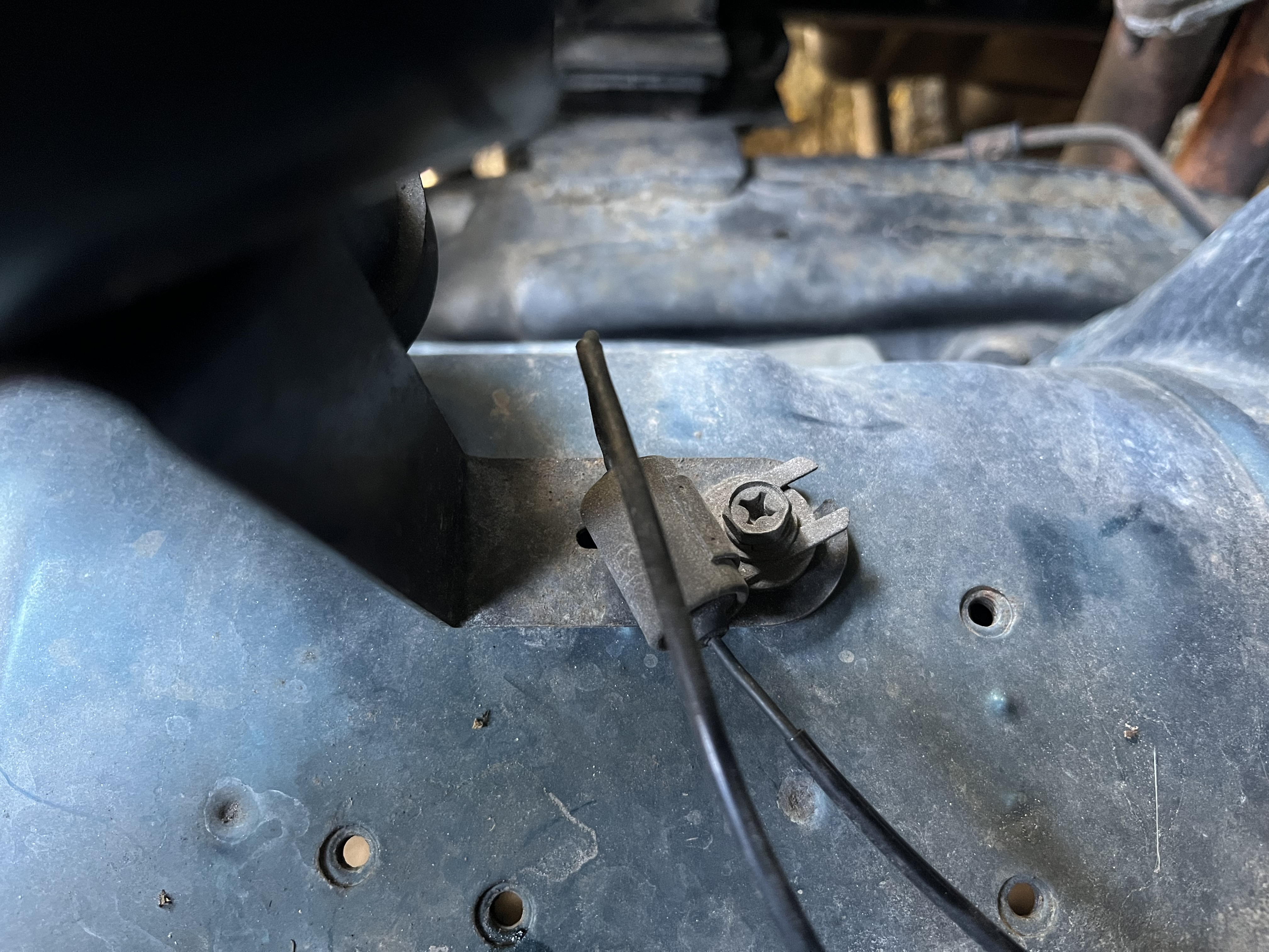

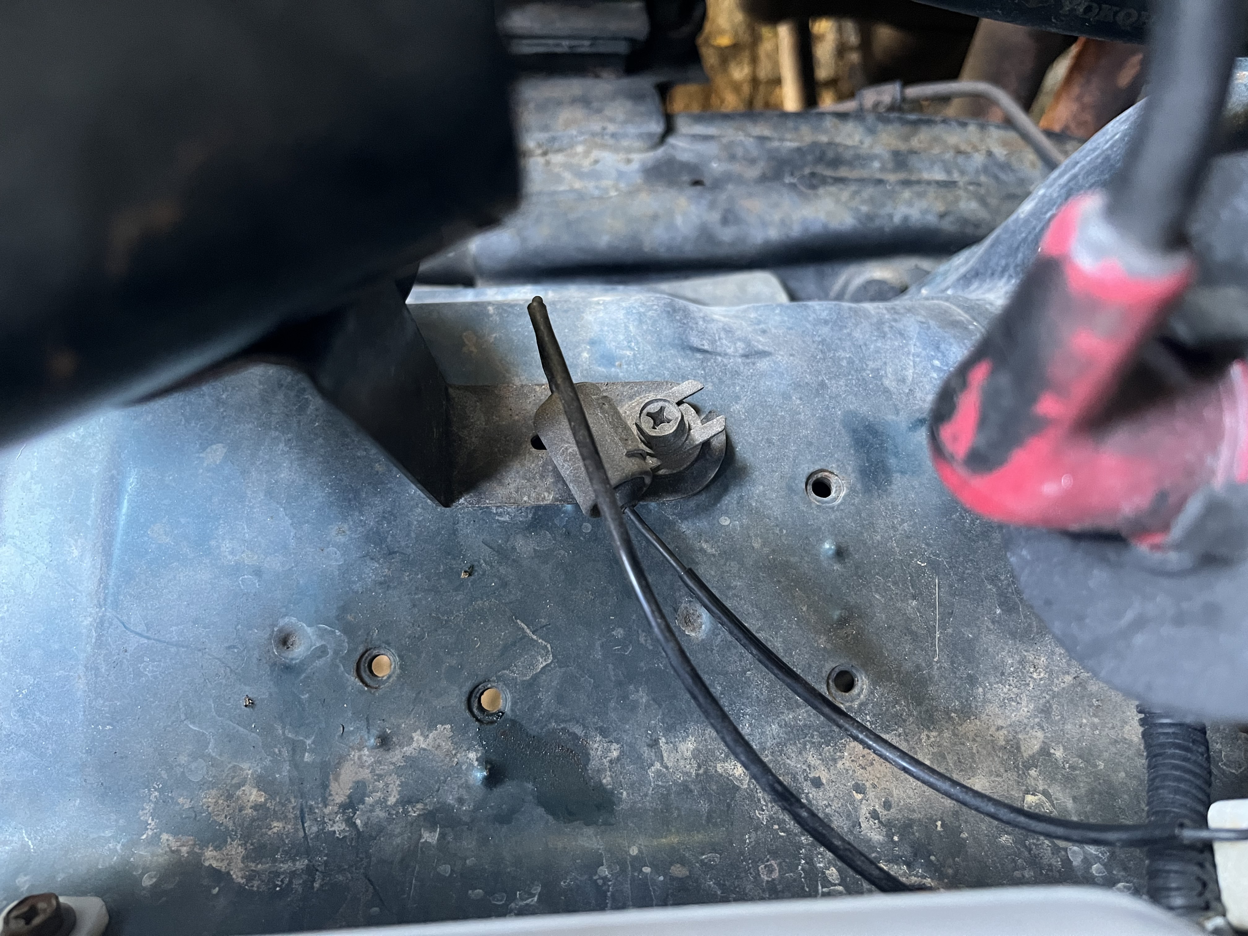

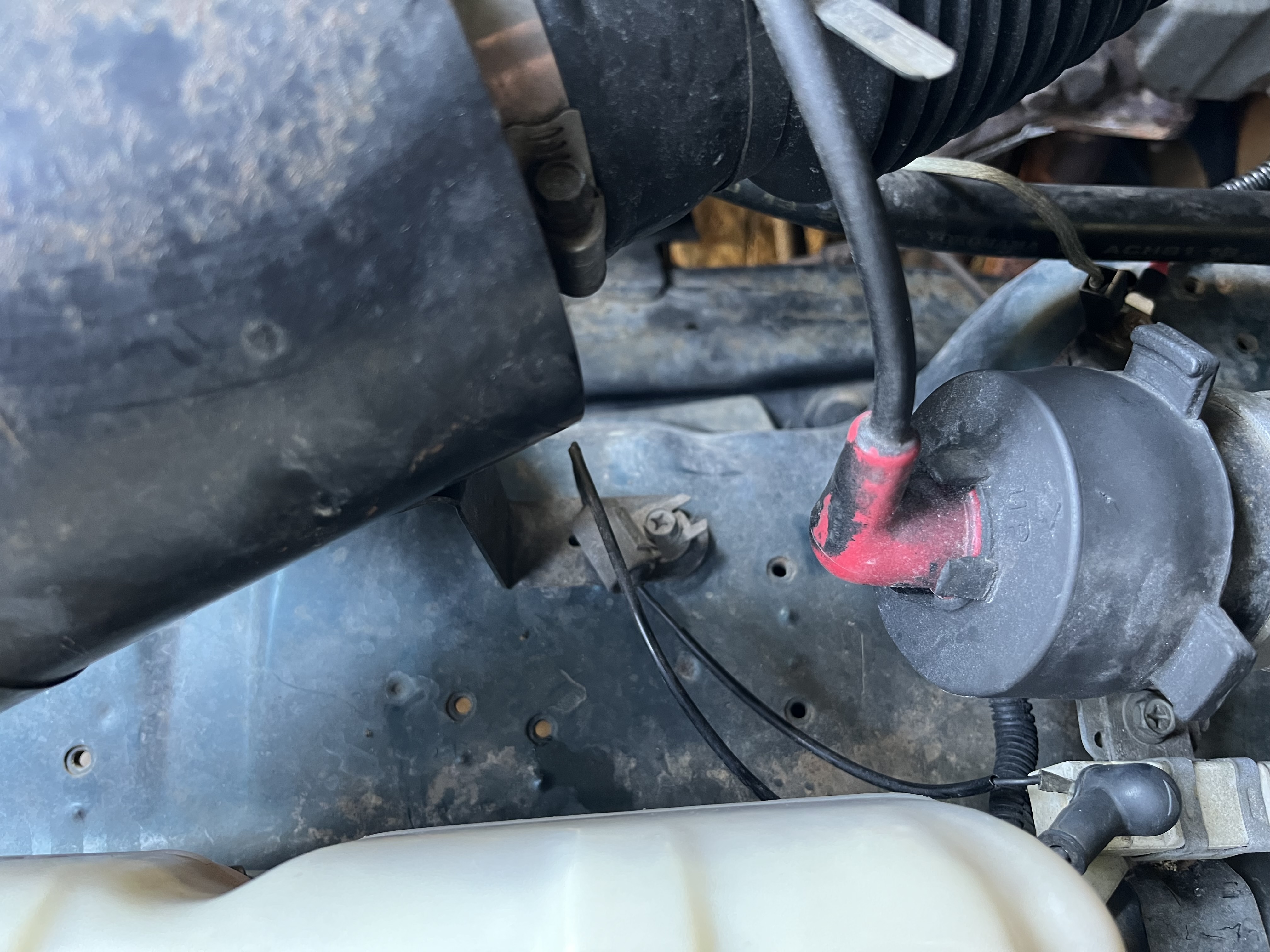

also, what is this capacitor looking thing close to the ignition coil, looks like it had a ground wire attached to it.
Any idea what it is and what it does?

That fitting is a pain. I had a stainless one made up.
While you have it off, also look at the fitting at the bottom of the intake manifold.

I think that cap is the condensor. Not sure. If you fit electronic ignition it becomes unnecessary.

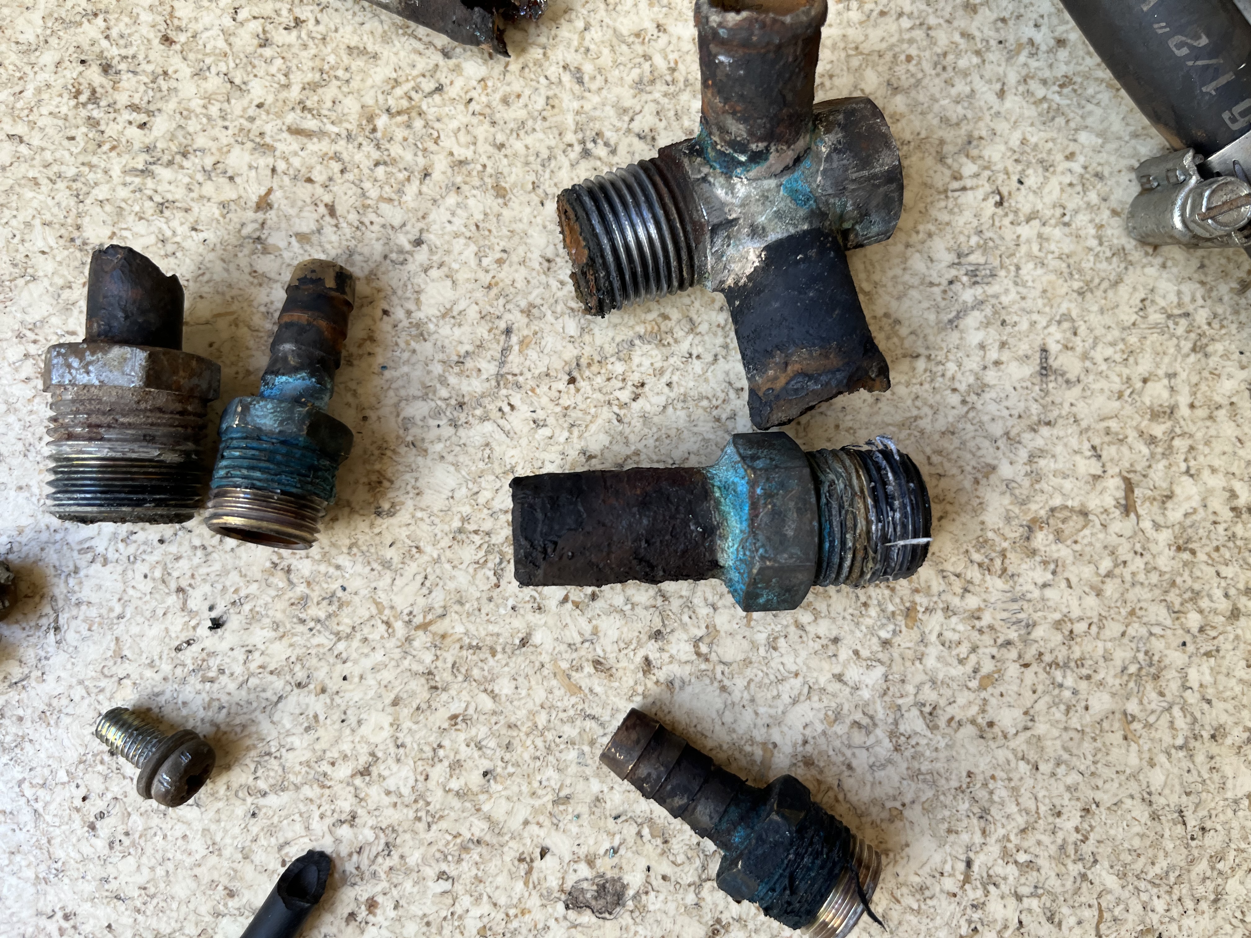

So after digging more, I have decided to replace all the brass coolant fittings as well, mine are worse for wear.
Any recommendations in cape town, of who can make these up? I have a few suggestions, just looking if anyone has any other good recommendations?

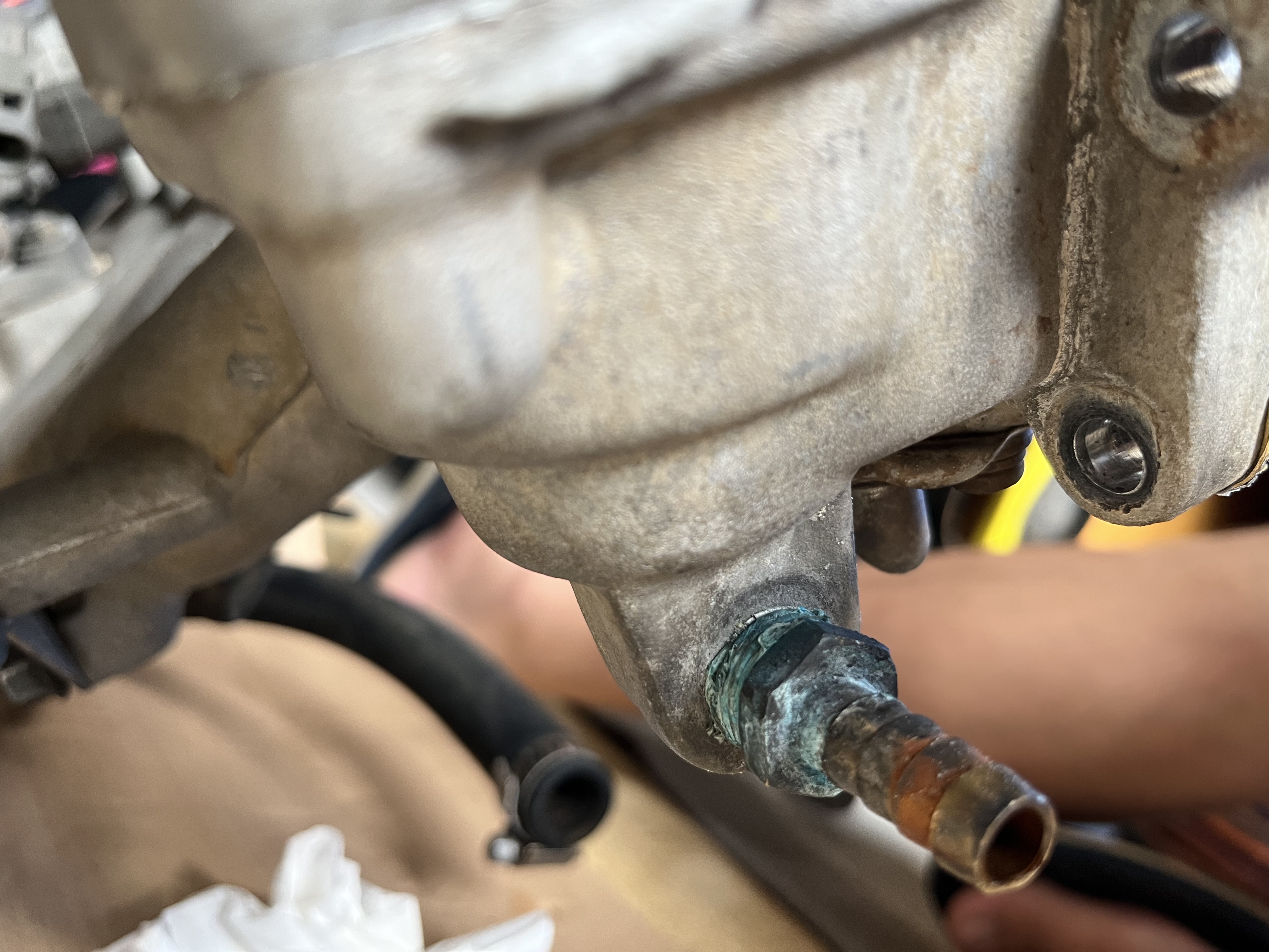

Then, this fitting below the Thermostat housing, shouldn't this be a 90deg fitting, not straight?
Then, I'm thinking that I may as well do the thermostat and water pump while I am in there, do you guys have the part numbers for these, and who should I try locally to source them from? Terrain Tamer? Nissan...?
Would also like to get new radiator hoses, part numbers and any suggestions where?
Going to be replacing all the coolant lines, vacuum hoses to the carb and rubber fuel lines while I'm there.

Those brass fittings don't look too bad?
The fitting on the thermostat is correct. The bose that goes on there looks like a question mark.

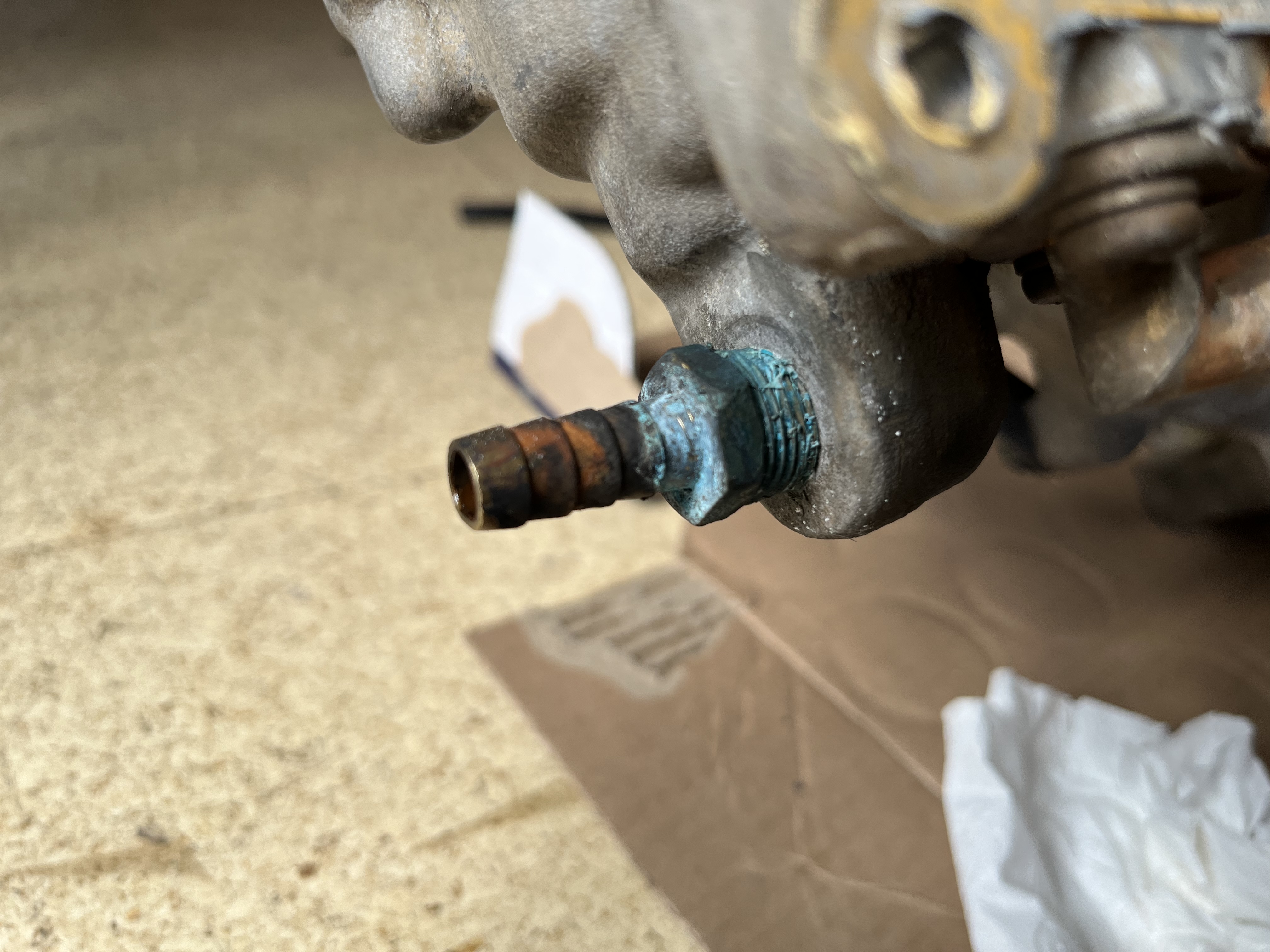

Thanks, I may try to get a 90deg fitting made up, seems like it would be much easier on the hose, someone just used regular non bent hose and bent it 90 on my car previously now, so it looked like that hose was about to go!
