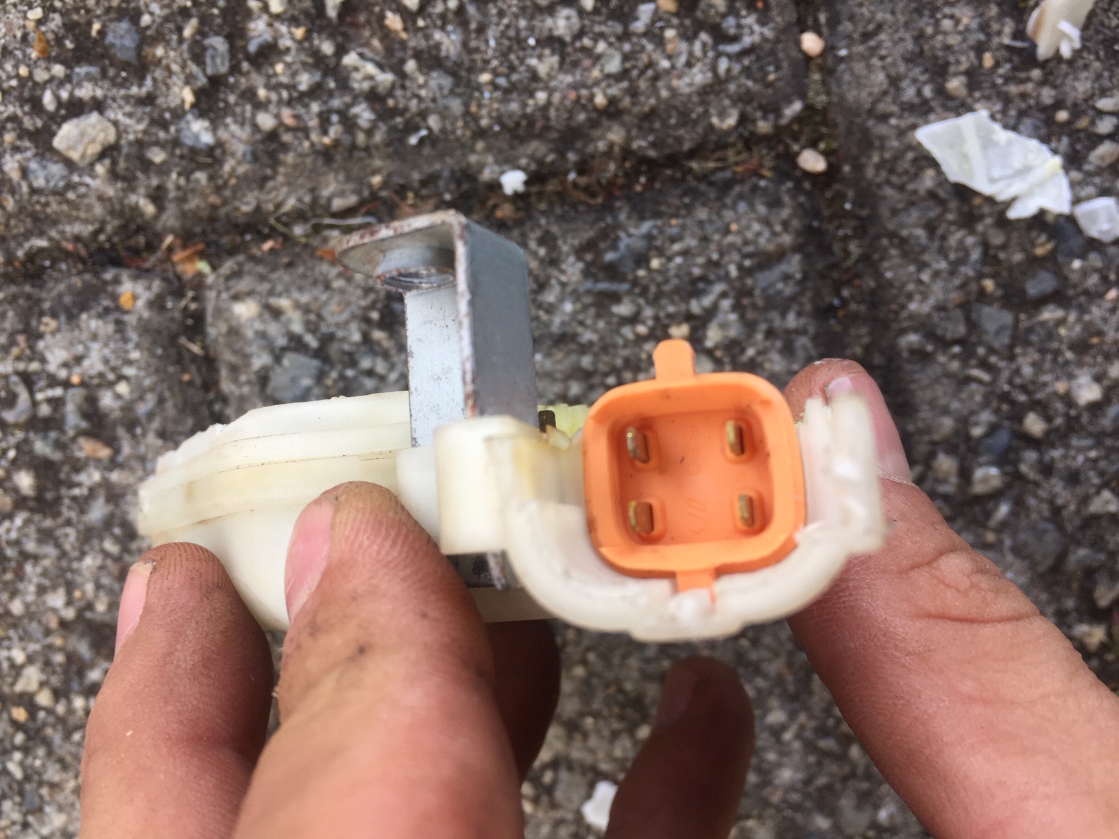

I am looking for aftermarket door lock actuators for front RHS door and both rear passenger doors on my Patrol 3.0.
The drivers door does not lock and unlock at all with the remote or central locking button on the door panel - I can only lock/unlock with the key, while the rear doors unlock without any problems but wont lock with the central locking.

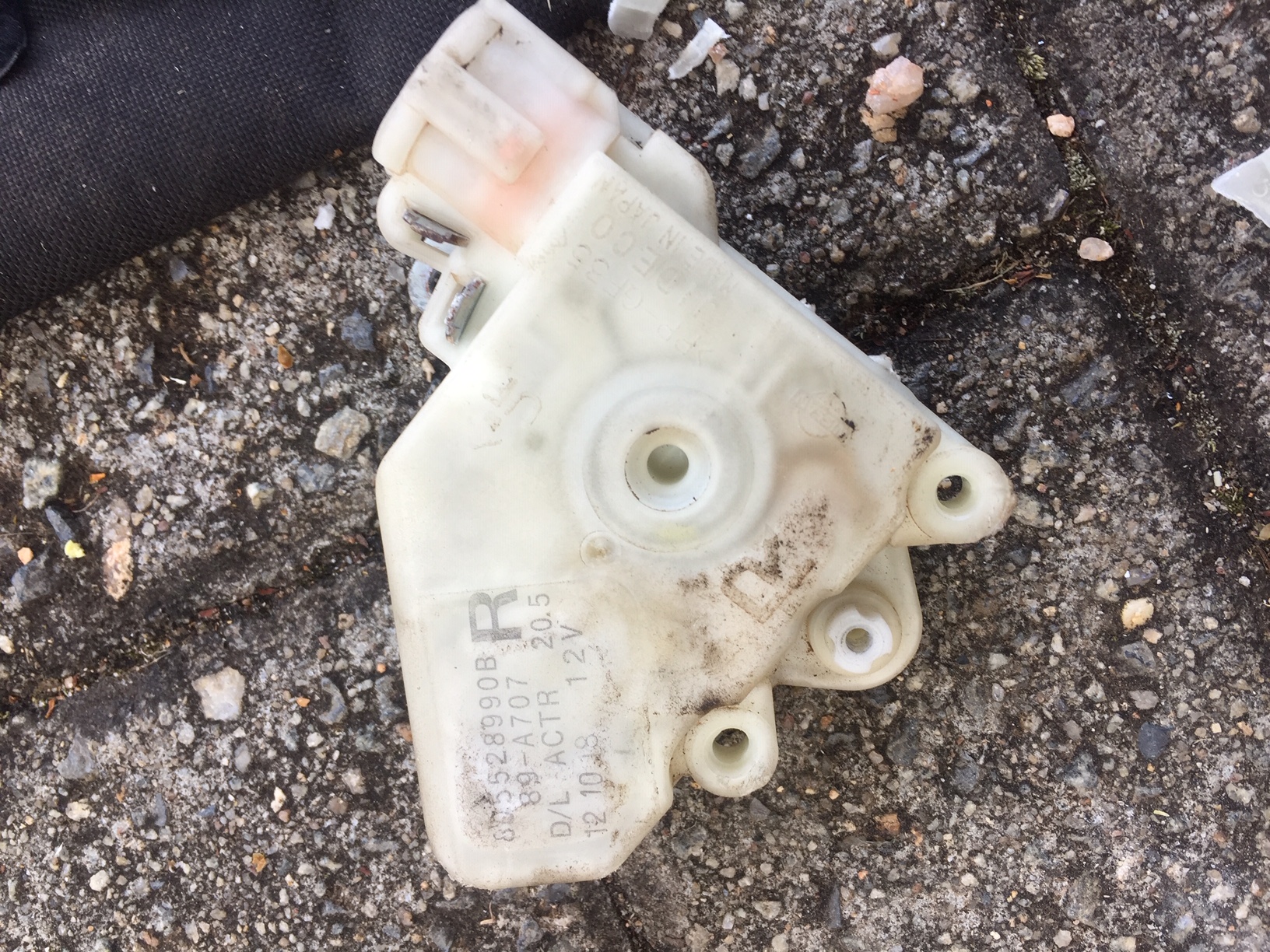

I have removed the locking mechanism from the drivers door and found that the little motor in the locking actuator must have seized and overheated, melting the plastic gear and actuator body together. (I had to break the actuator open to confirm this).
I haven't checked the issue with the rear doors yet, but I presume that it is related to the drivers door as they all started giving problems at the same time.
