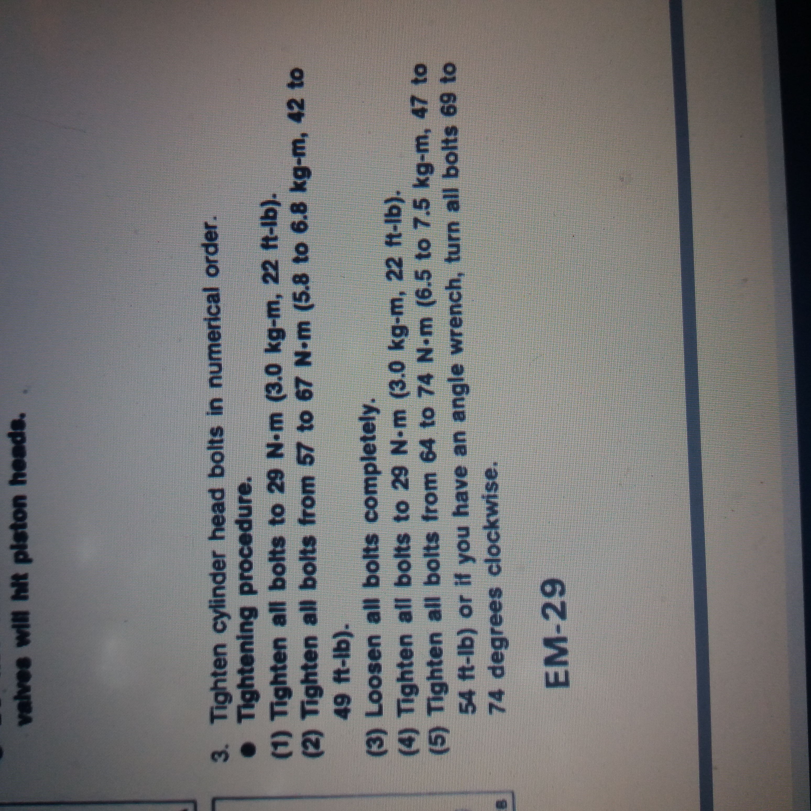

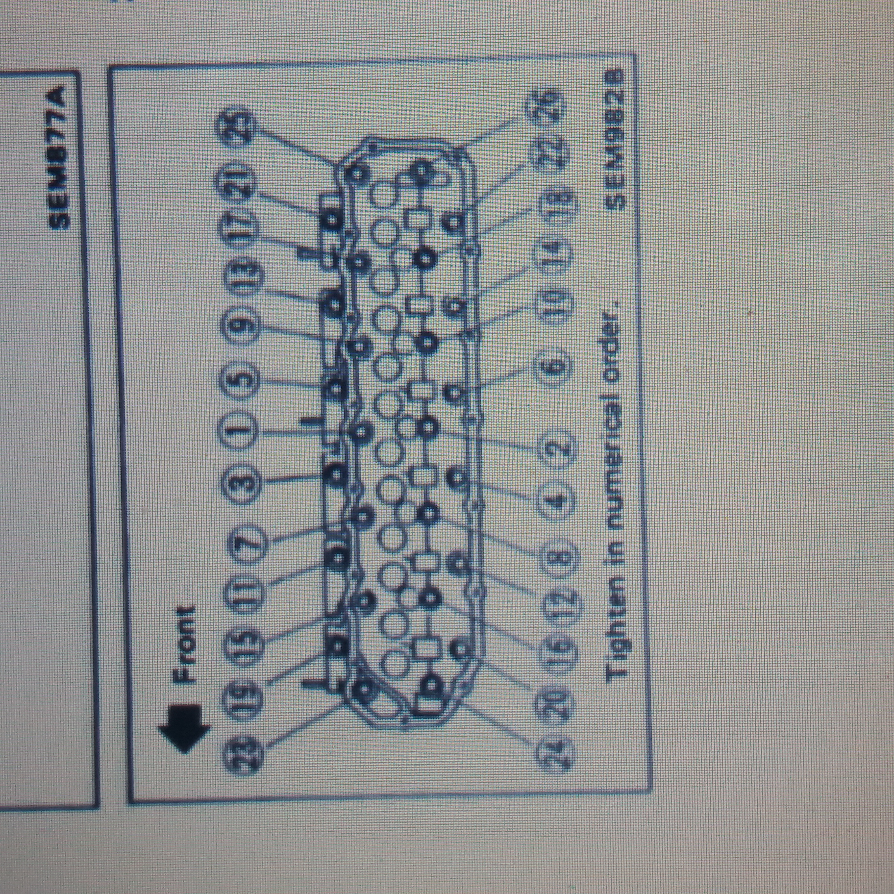

Can someone please advise me on the torque specs for the headbolts on the TB42?

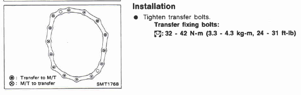

What would torgue be for bolts on transfer case?
32 -42 Nm
