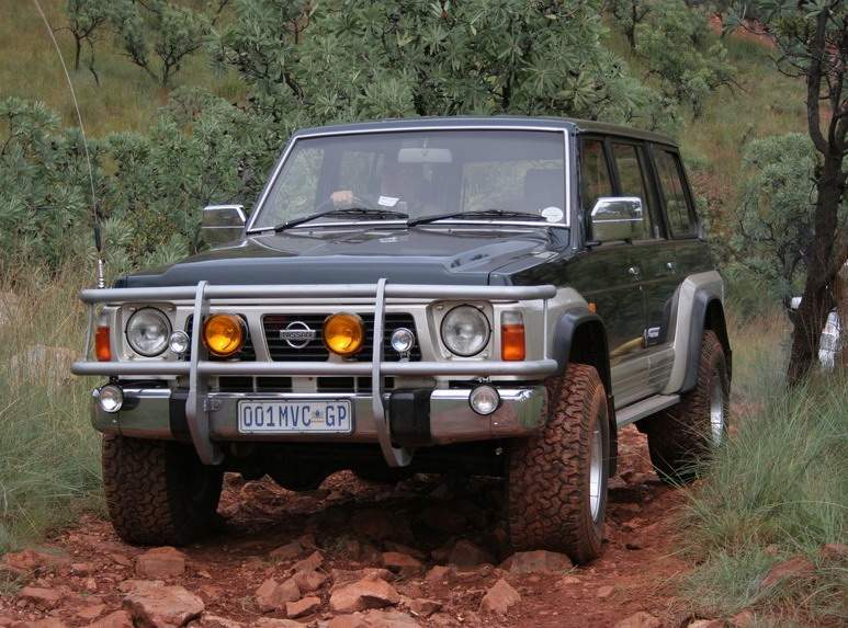

Re: New shocks needed
I have on 4 of my vehicles (3 with rear coils and leaf springs on the 4th) taken it to General Spring works in Driehoek in Germiston for new coils and leafs .SJC wrote: ↑30 Jun 2021 19:54Watse coils het jy in?offroadbiker wrote: ↑30 Jun 2021 12:02 Mikem dit my 4inch Bilsteins for the GQ as well, speak to Tinus to sort you out![]()
No 1. 1985 Safari - New leafs rear, re-tensioned front
No 2. 1995 Patrol - 4 new coils, 2mm thicker wire, 5 inch lift. It really looked sexy with 5 inch lift and 12.5 x 33" tyres on 10J rims (see pictures)
No 3. 1999 Terrano - 2 new rear coils (three times), first 1mm thicker wire, 3 inch lift , not satisfied - then they fitted 2mm thicker wire (no charge) 2 in lift, still not happy, then they fitted 3mm thicker wire (no charge) 3 in lift, this was at last perfect for my requirements!!
No 4. 2008 Patrol - 4 new coils, 1mm thicker wire, 3 inch lift.
They are excellent, the work is done in one day. If you are not happy with the hardness (stiffness) of the first attempt, they will redo it even 3 or 4 times, until you are happy.
I really like their professional workmanship and their commitment to not stop changing and adjusting until you are happy with the results. Their prices are extremely good compared to the rest.....
- My Patrol.jpg (78.38 KiB) Viewed 4566 times
