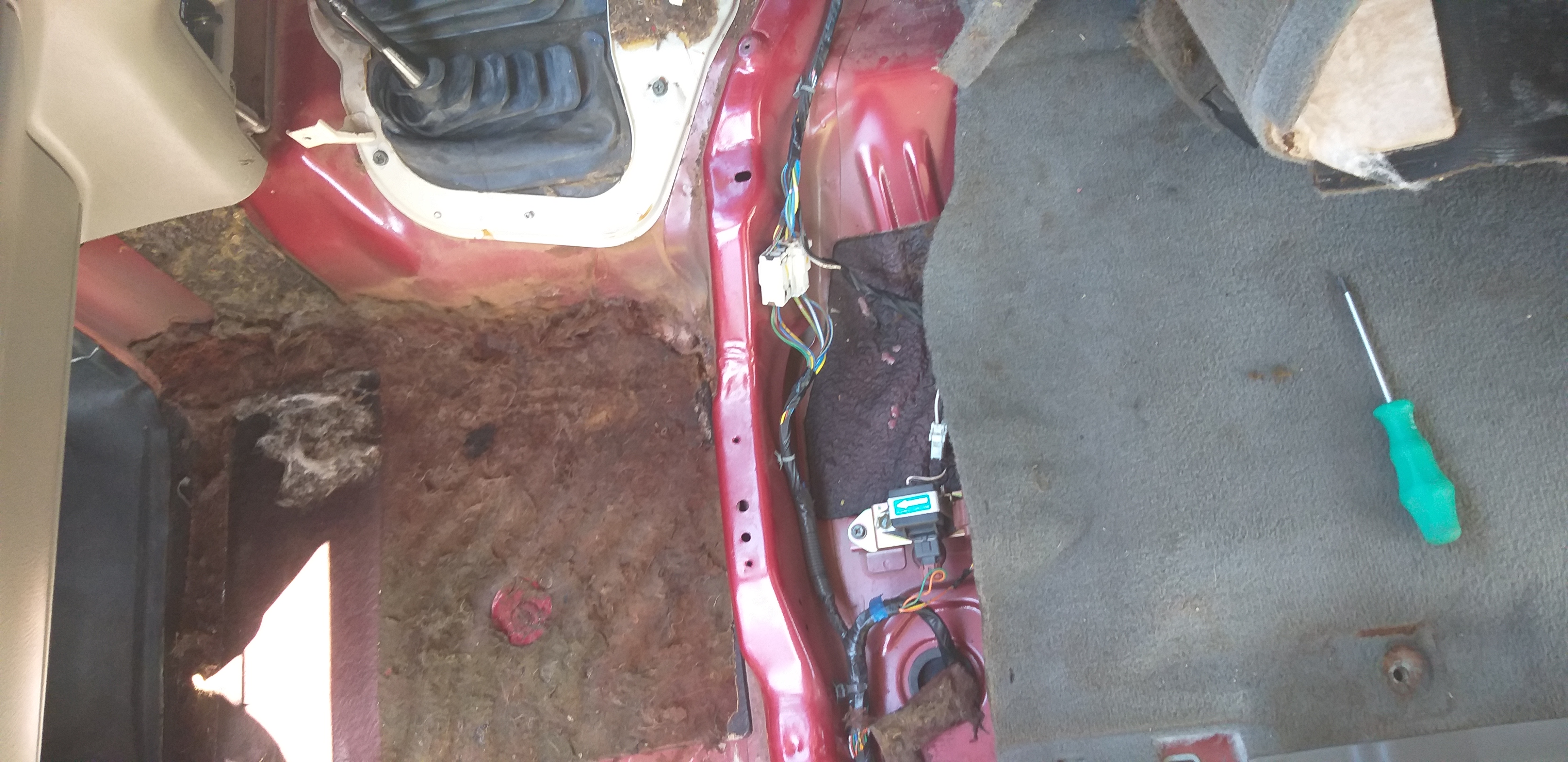

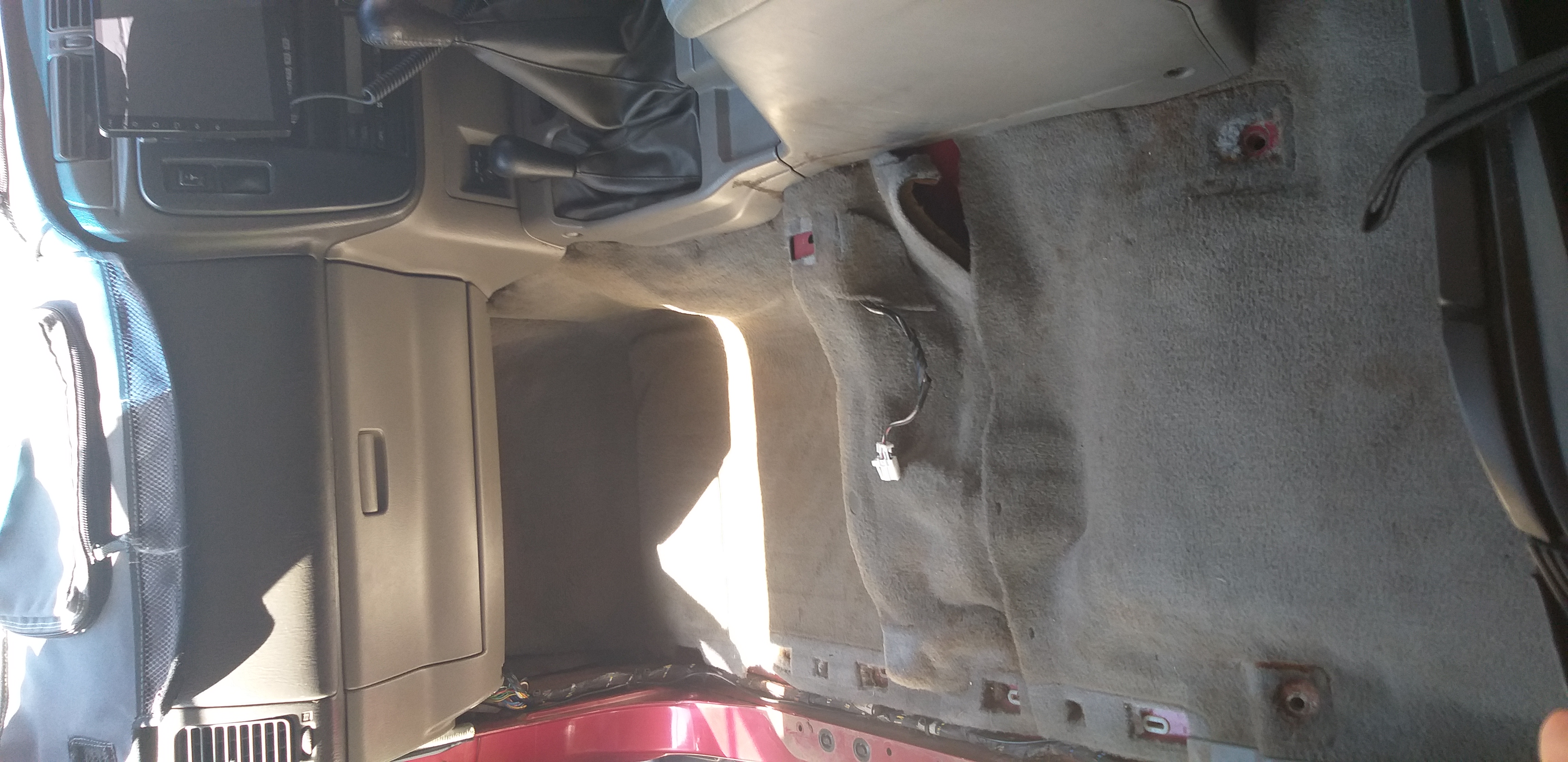

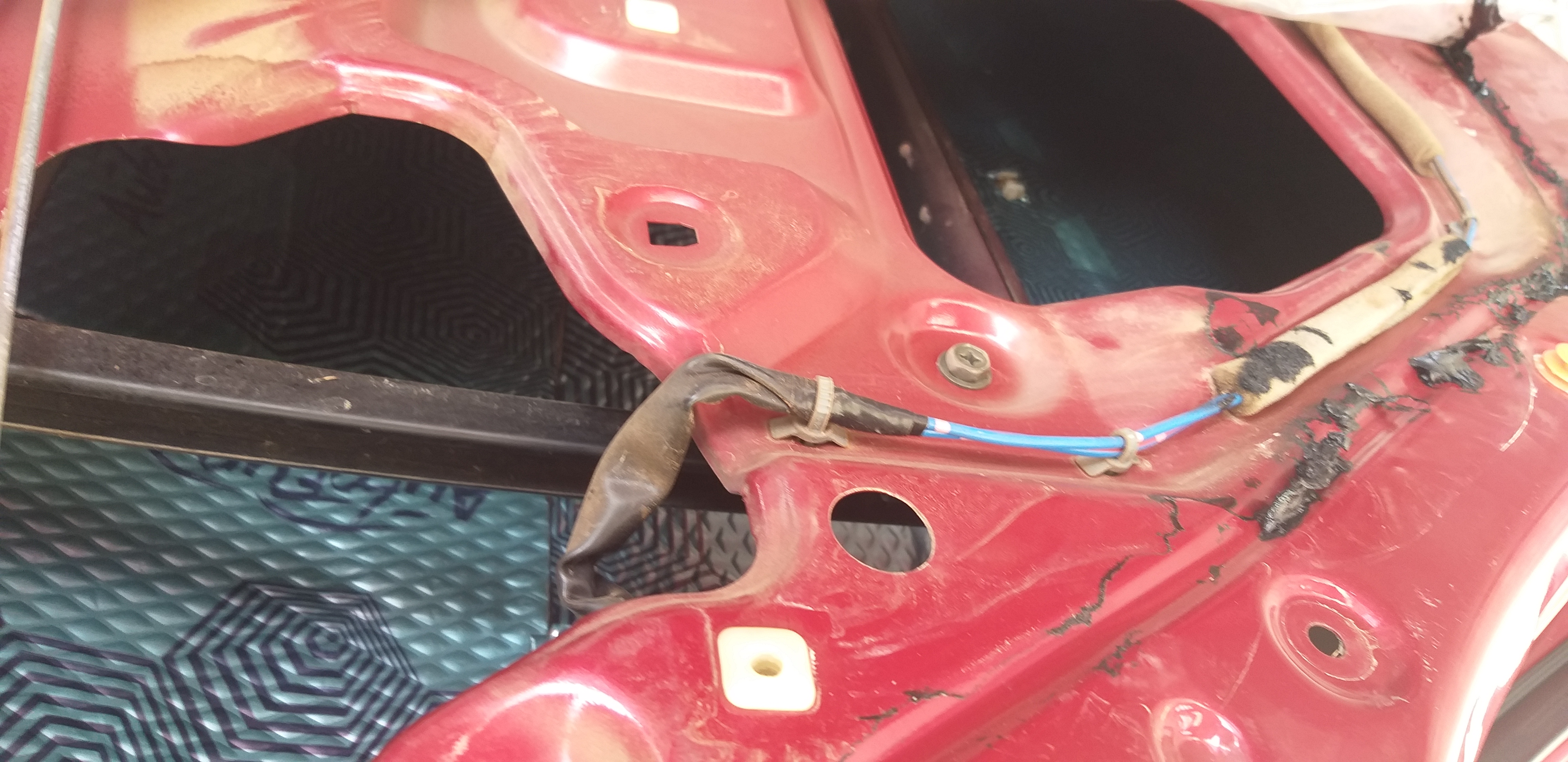

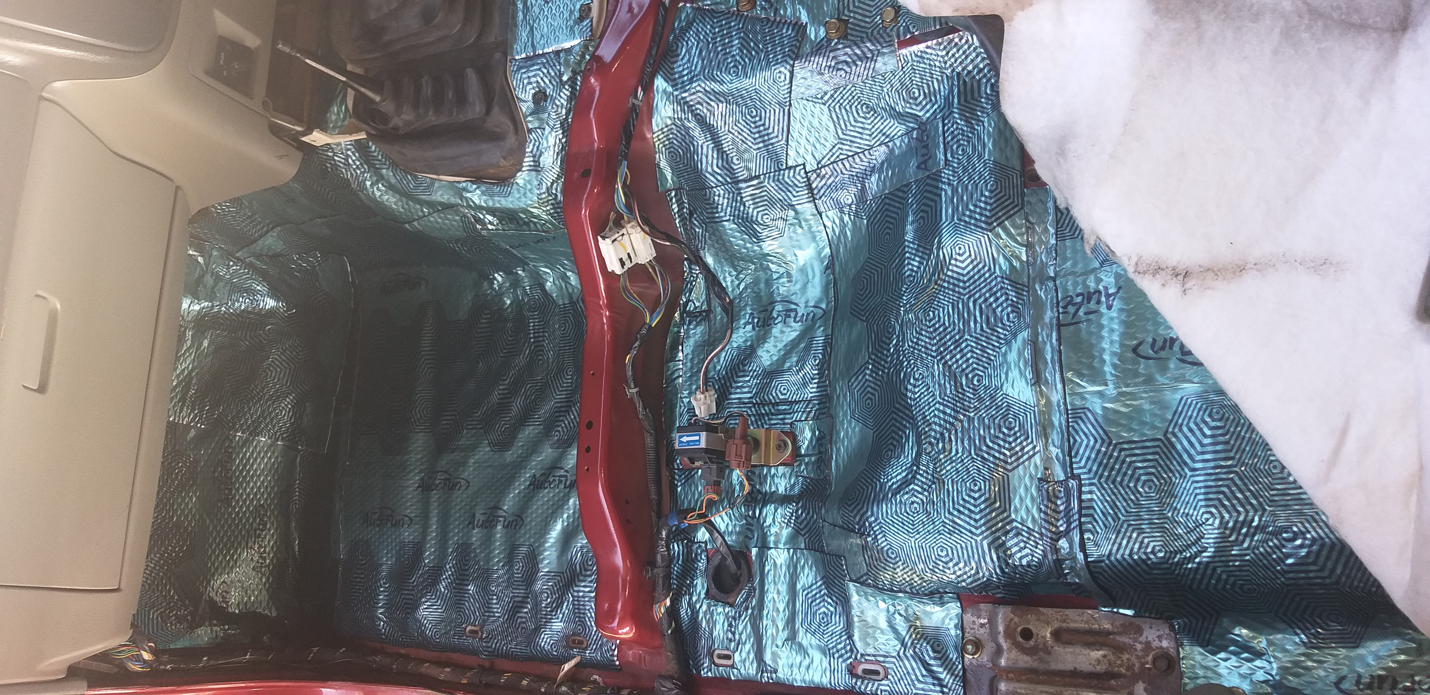

This project has actually been on and off as I originally started it in December last year. Due to our 2nd wave then and 3rd wave now it's going rather slowly.
I have been pulling out the original sound deadening and replacing it with some new ones. I've only done all the doors , the whole passenger side firewall and front and rear seat areas. I found some rust against the transmission tunnel. I suspect it was the aircon leaking water there at some stage.
So what are the effects thus far? Well, a decibel app pre and post (partial) installation read 3decibel difference. I cannot really quantify that result, except by saying it's definitely less noisy.
I would like to get rid of as much NVH and in-cabin noises as possible. Thus if anybody has advice or knows of known culprits and fixes I would appreciate advice.

Yes Ruan, nee ek het dit gekoop in Windhoek, so Anthony gaan verseker vir jou die beste raad kan gee. My grootste vraag was maar hoeveel moet n mens kry...Niemand weet hoe groot n Patrol se binneruim is hier nie. Ek het toe vier bokse gekoop, dit lyk of dit moontlik genoeg sal wees.
