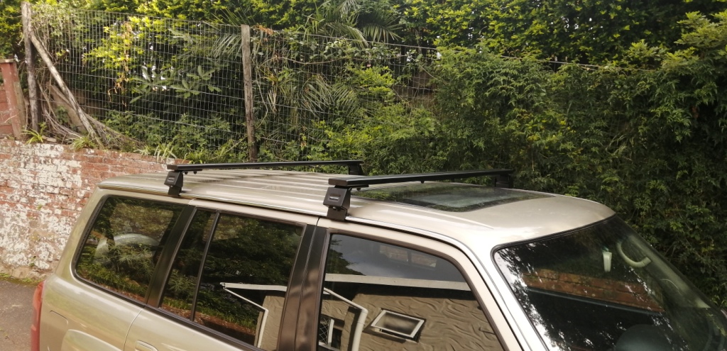

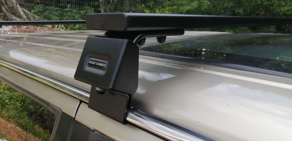

ok so a bit of feedback re. the frontunner load bars:
they are fitted, and they look great
they have a great quality in terms of material and workmanship - nicely powder coated and neat welding i had unexpected issues when fitting them though, because on my patrol anyway, the lip of the gutter is about as wide as the channel of the gutter
the "clamp" section of the foot does not open wide enough, however loosely connected to the actual foot, to fit over the gutter.
also, when i tried putting the clamp on only after the bar and feet were in place, i was unable to align the bolt and the nut enough to get onto the thread i had to resort to sliding the bars and feet on, all the way from the back. it was the only way i could see to get all the hardware sitting correctly this now had an affect on the rubbers that i had siliconed to the feet - as i slid the feet down the gutter, the rubber on the feet obviously had a lot more friction, and the silicone adhesion gave way, and the rubbers came off
the silicone had adhered reasonably to the powder coated metal, but the rubber just had no connection at all
in the end, and probably in a bit of frustration as well, i gave up on the rubber idea, and the bars are fitted bareback, if you will
if i had not had the problem about the clamps not opening wide enough, the rubbers and silicone would have been ideal

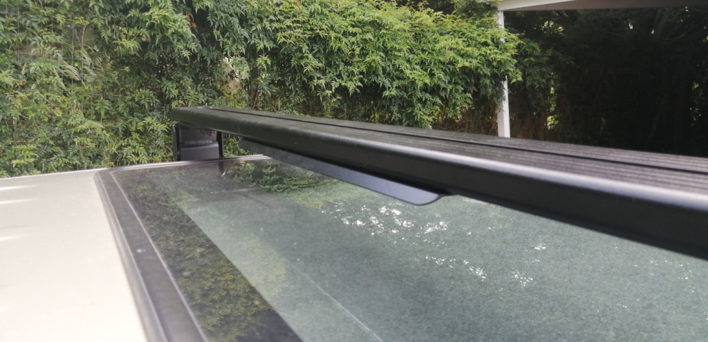

not sure how well the 'wind deflector' is going to work, but the sunroof is not affected

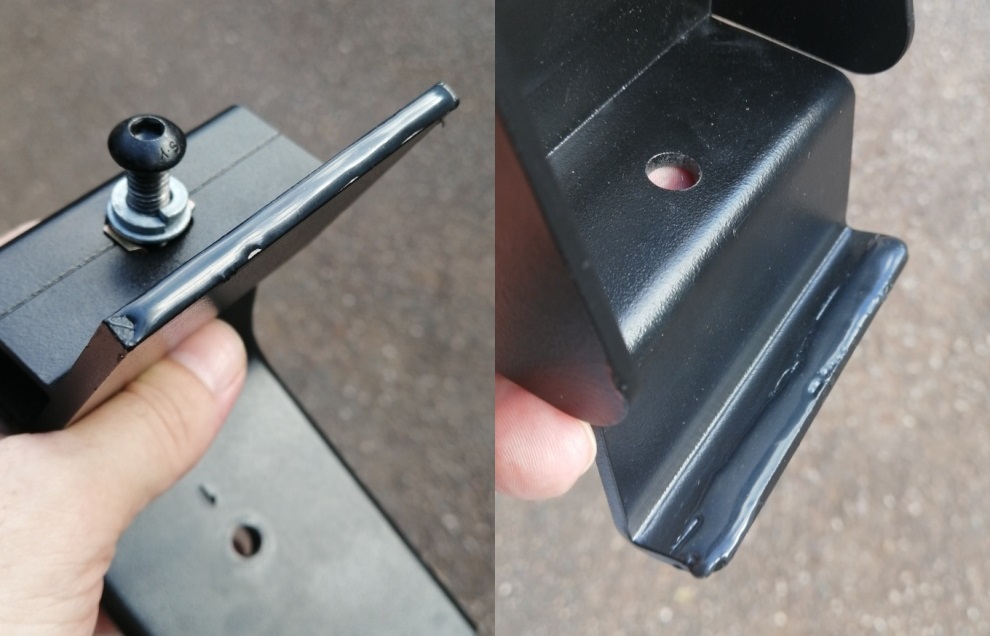

after driving around with these things on for a few days, i have discovered they are F'n noisy, which reinforced my original desire to be able to put them on and take them off when necessary with minimal scratching
plan b was the epoxy - black wondafix
that's it after it had dried - pretty much exactly how i had originally envisioned it
it was runny enough to make its own meniscus, but viscous enough not to drip too much
a little bit messy as well, but it was dark and i didn't have my glasses on
