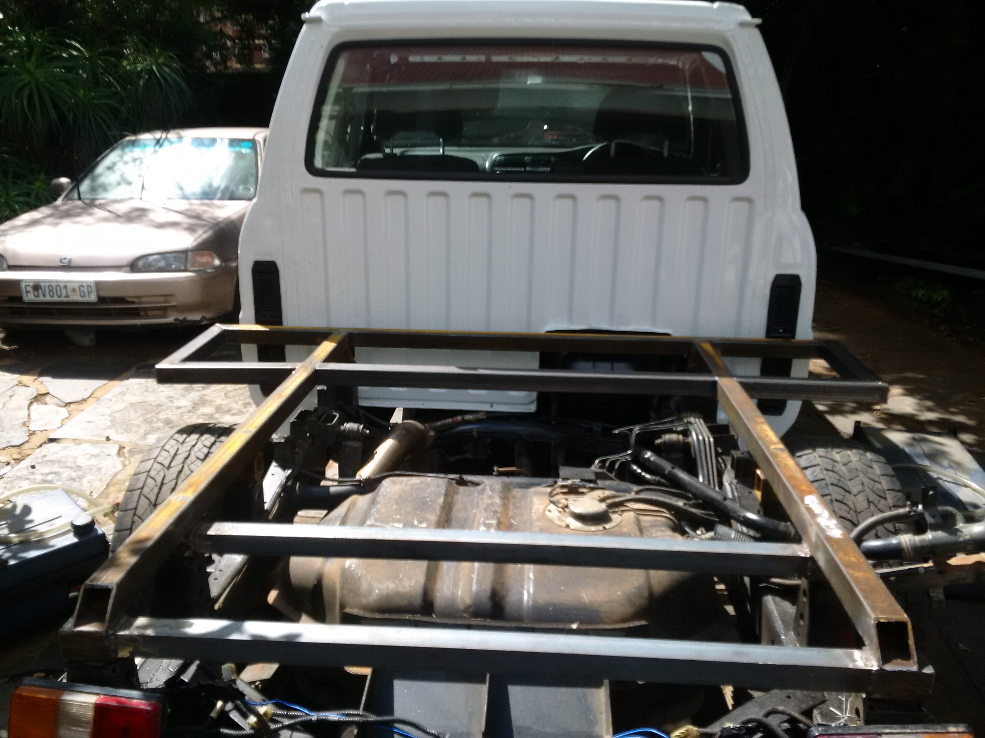

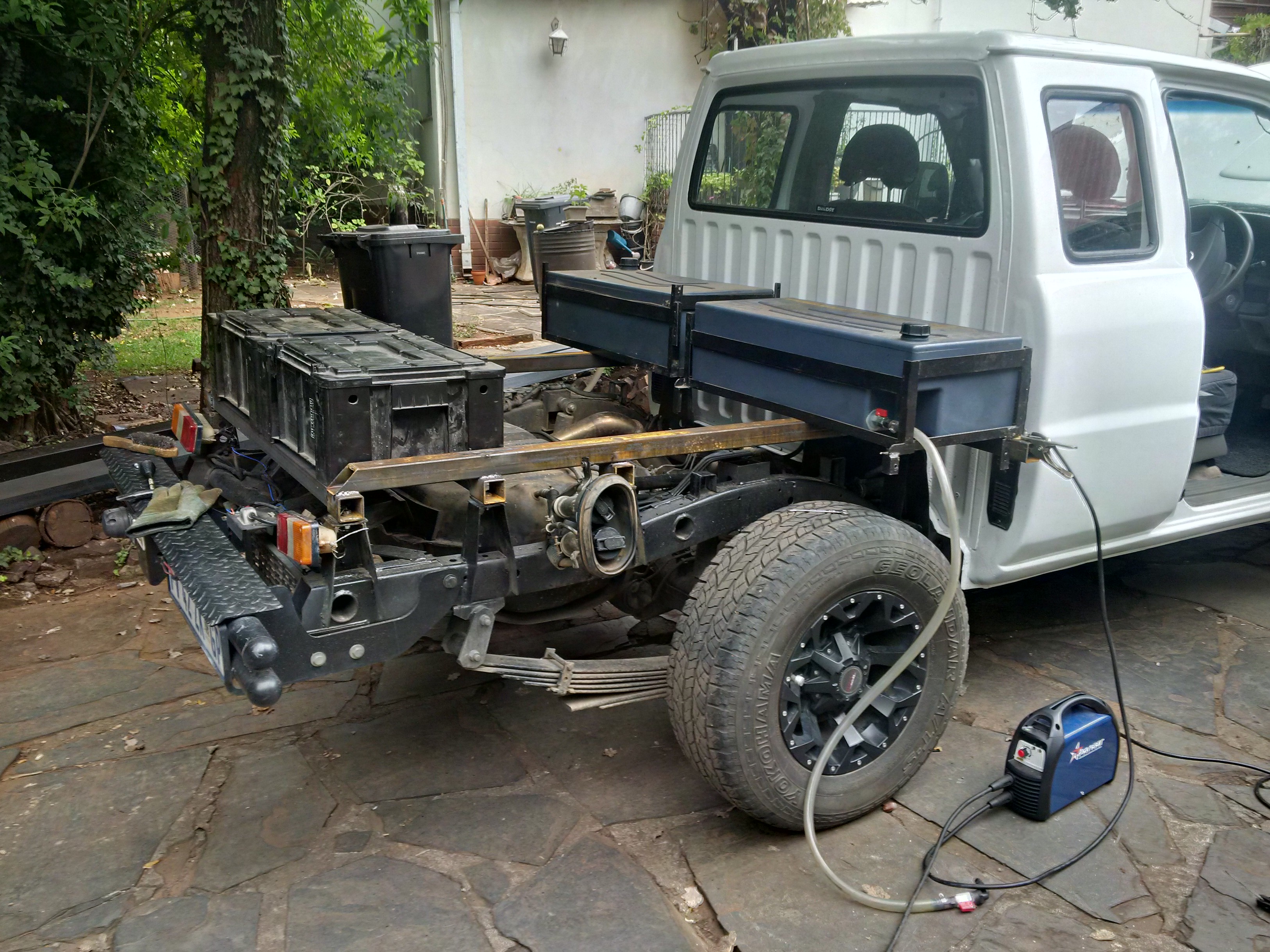

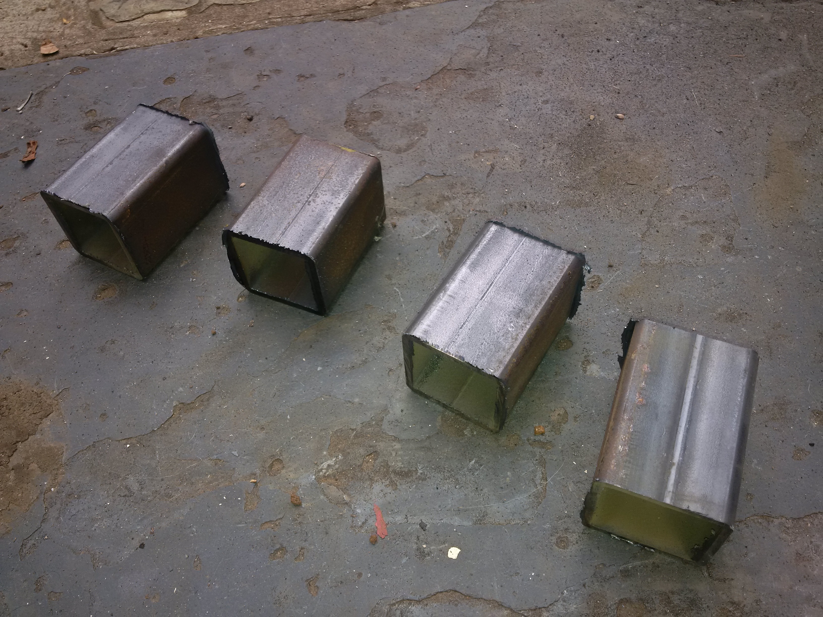

With lock down underway I started on building a canopy. Before everybody tells me I should've used aluminium...I know it's lighter...I know it doesn't rust....I know etc. etc. But I can't weld aluminium, and I wanted to do this myself. I built a canopy for my previous Isuzu with a steel frame and aluminium skinning, but I always had issues with sealing. Maybe I didn't use enough sika, maybe I used the wrong kind of rivets...who knows. But my decision this time round was to do the whole thing out of steel. I had bought a limited supply before going to Jan, hopefully enough to build a frame big enough to carry more on.

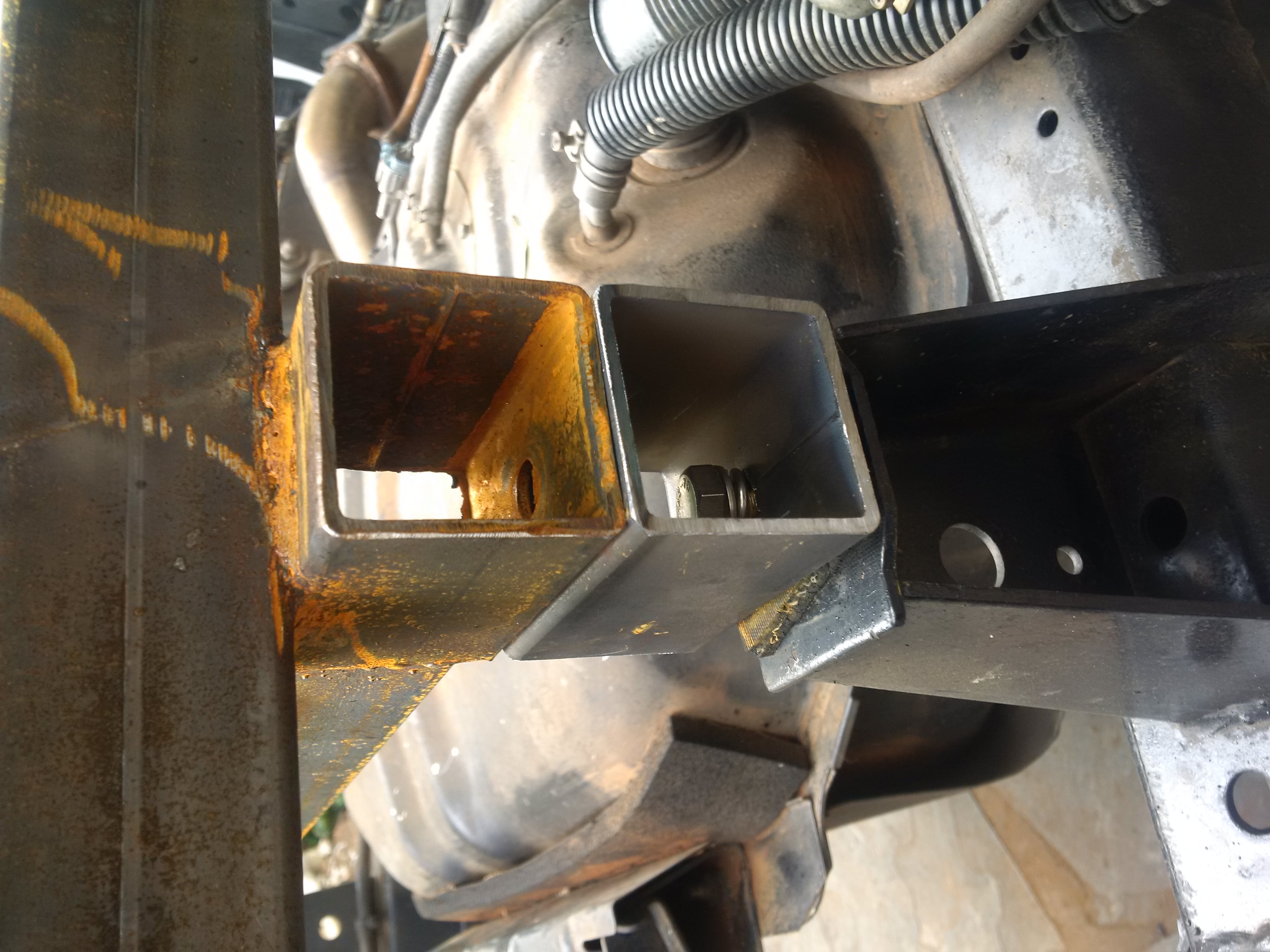

I started by cutting some short lengths of square tubing, and drilling holes through one side so I could bolt them to the chassis.

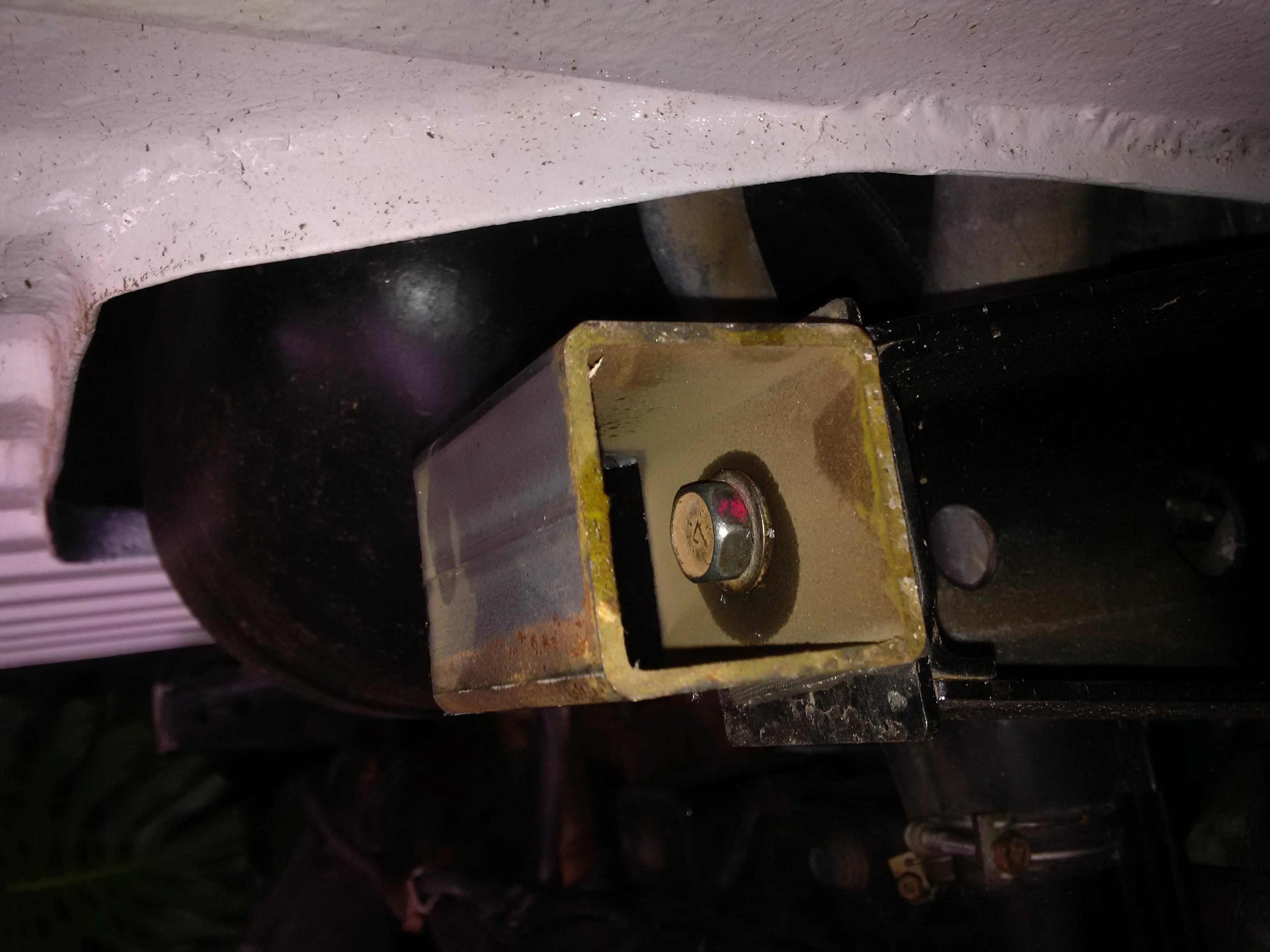

Post by PIG »
Some rubber insertion between the steel and the chassis.

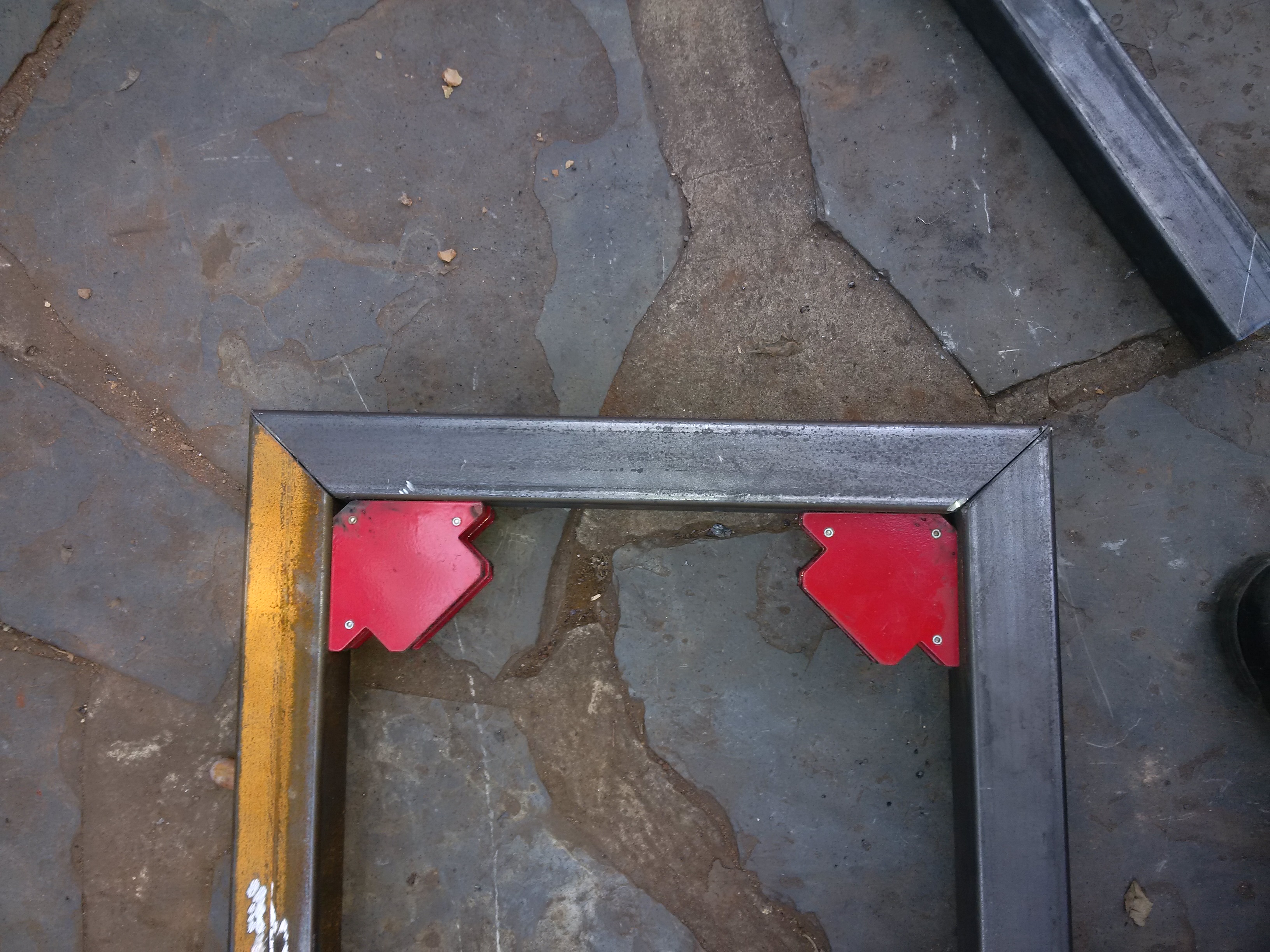

Post by PIG »

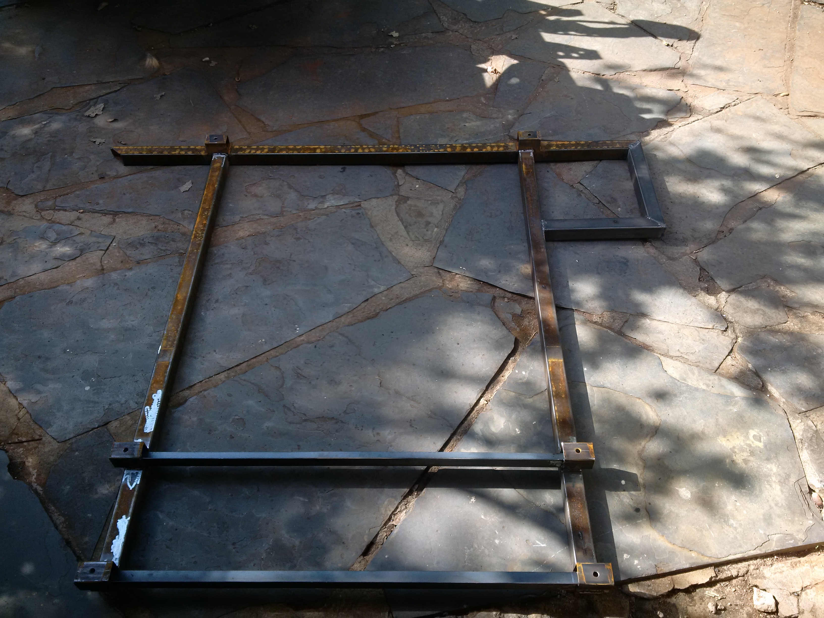

From that point I started to weld up the base frame.
My plan is to have water tanks up front, and a drawer down the middle that pulls out the back. I reused the frame for the tanks that were built into the Isuzu.

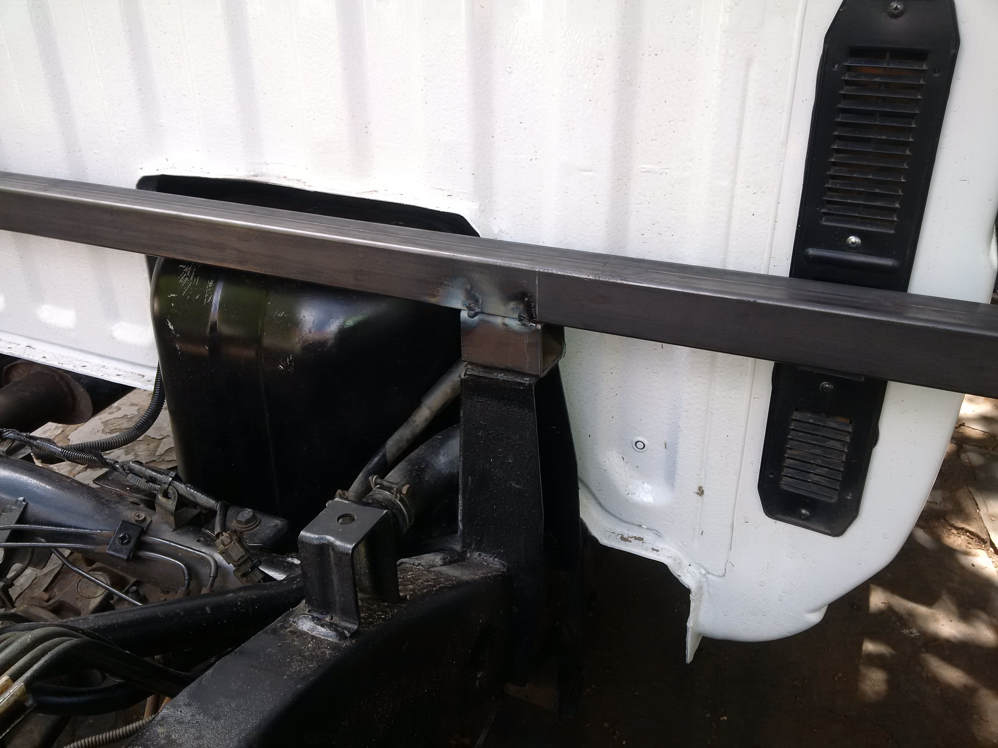

Post by PIG »

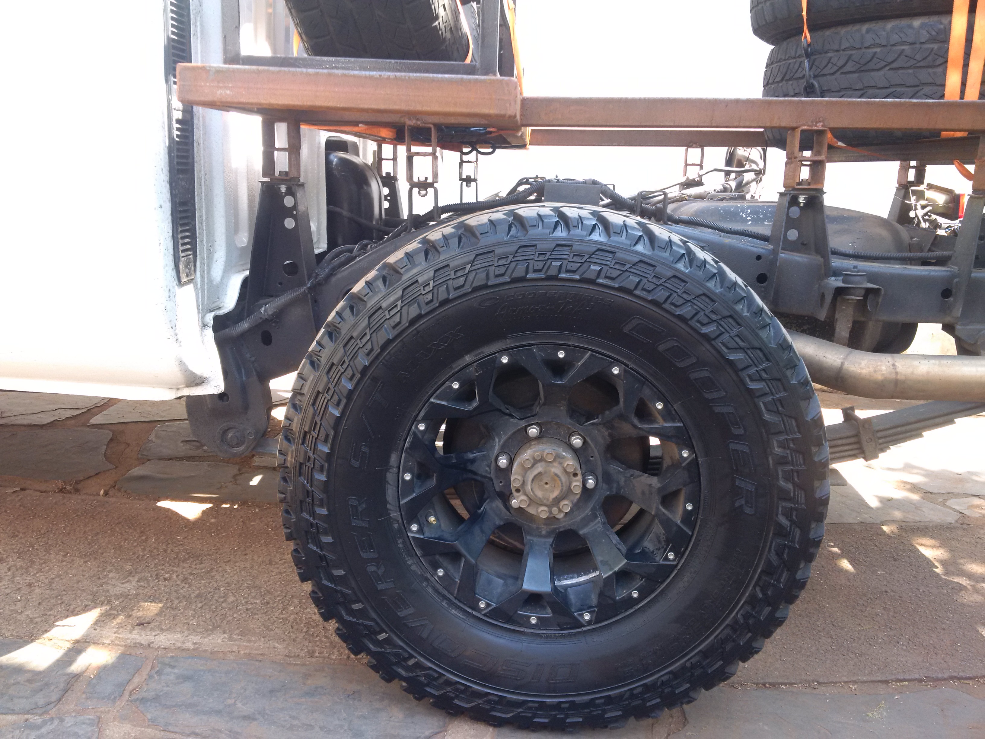

Next were the bases to support the water tanks in front of the wheels.
PIG
Posts: 38
Joined: 25 Sep 2019 08:58
Full Name: Leon Burke
Nickname: Leon
Current 4x4: 2015 Patrol pickup
Has thanked: 9 times
Been thanked: 14 times
Re: Patrolicus

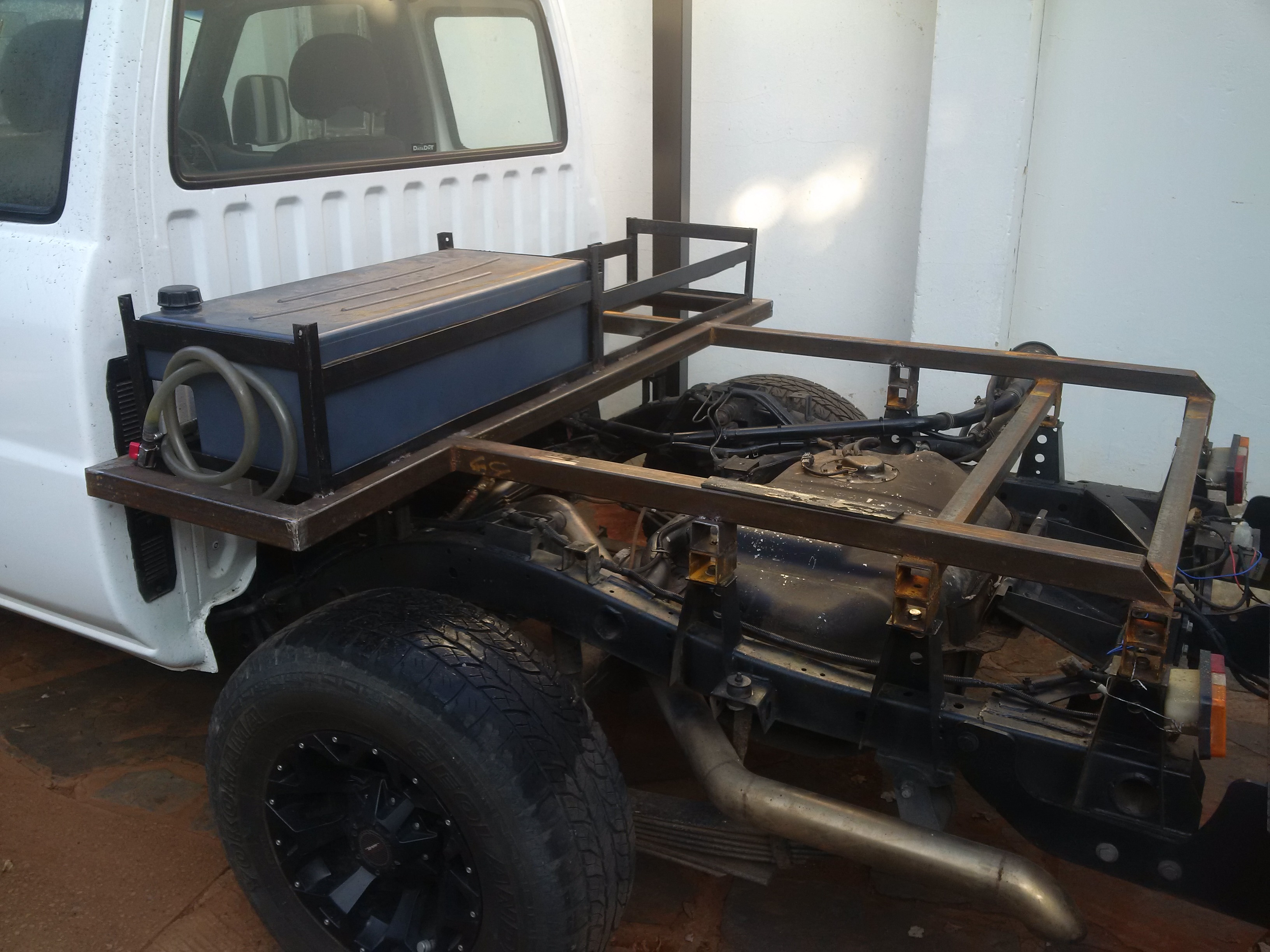

Post by PIG »

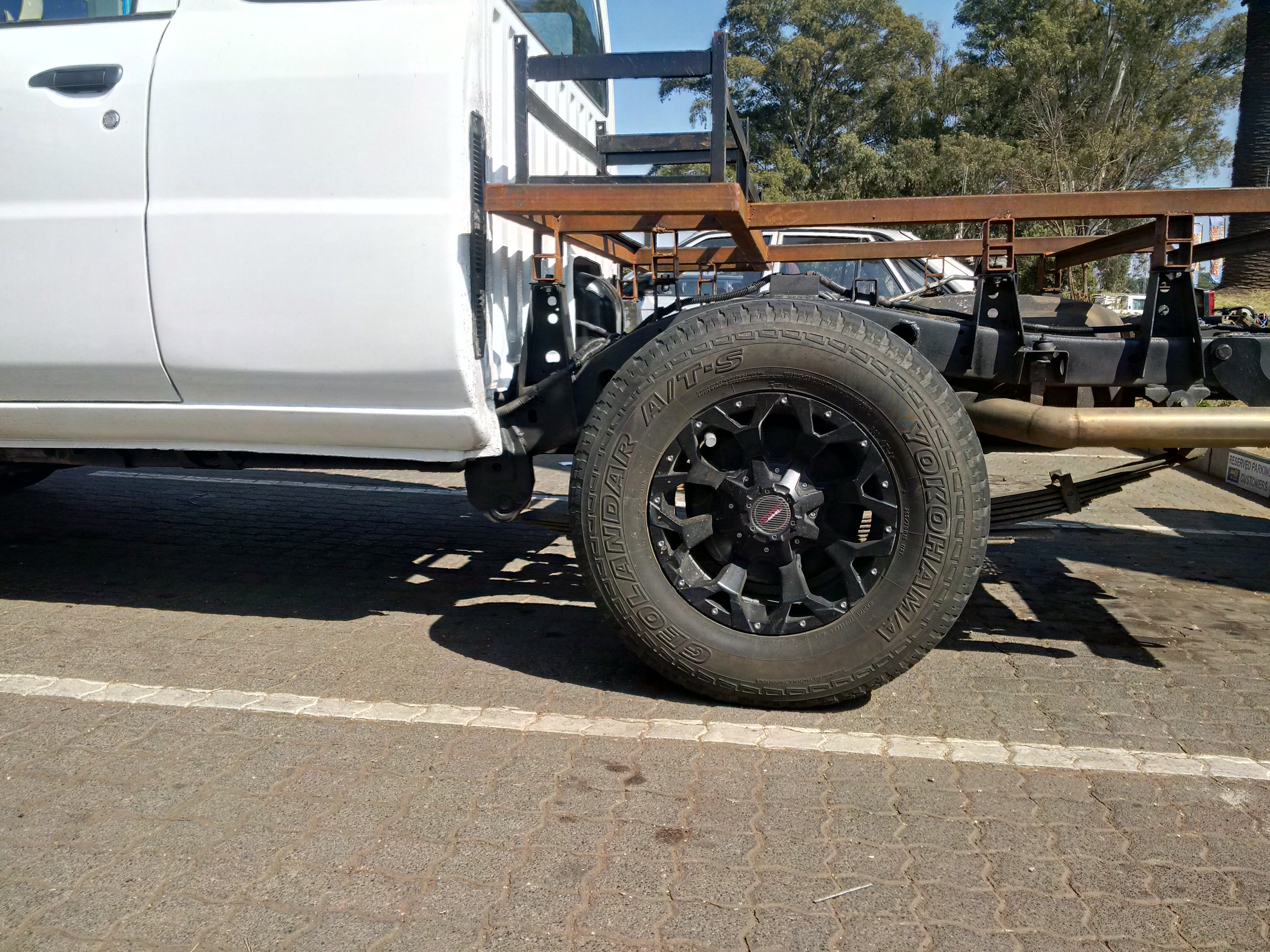

At this point it became apparent that I had made a slight miscalculation in terms of clearance. My original plan had been to have the tanks dropped lower, in front of the wheels, with a raised section for an arch. But to clear the secondary tank I had to move it back a little, and to give space around the tanks the base had to be wider as well. In the end I had to lift the entire structure :( Thus a second set of square tubing with holes was attached.
Had I not messed this up, the design and manufacture would have been a lot simpler....and straighter. But here we are.

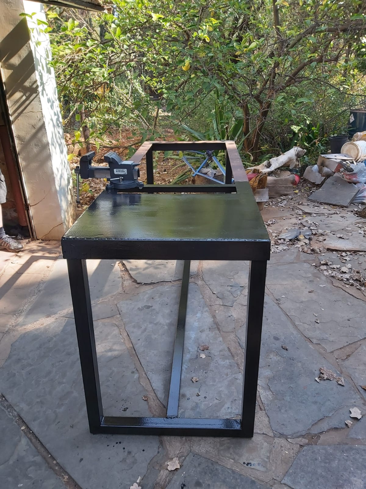

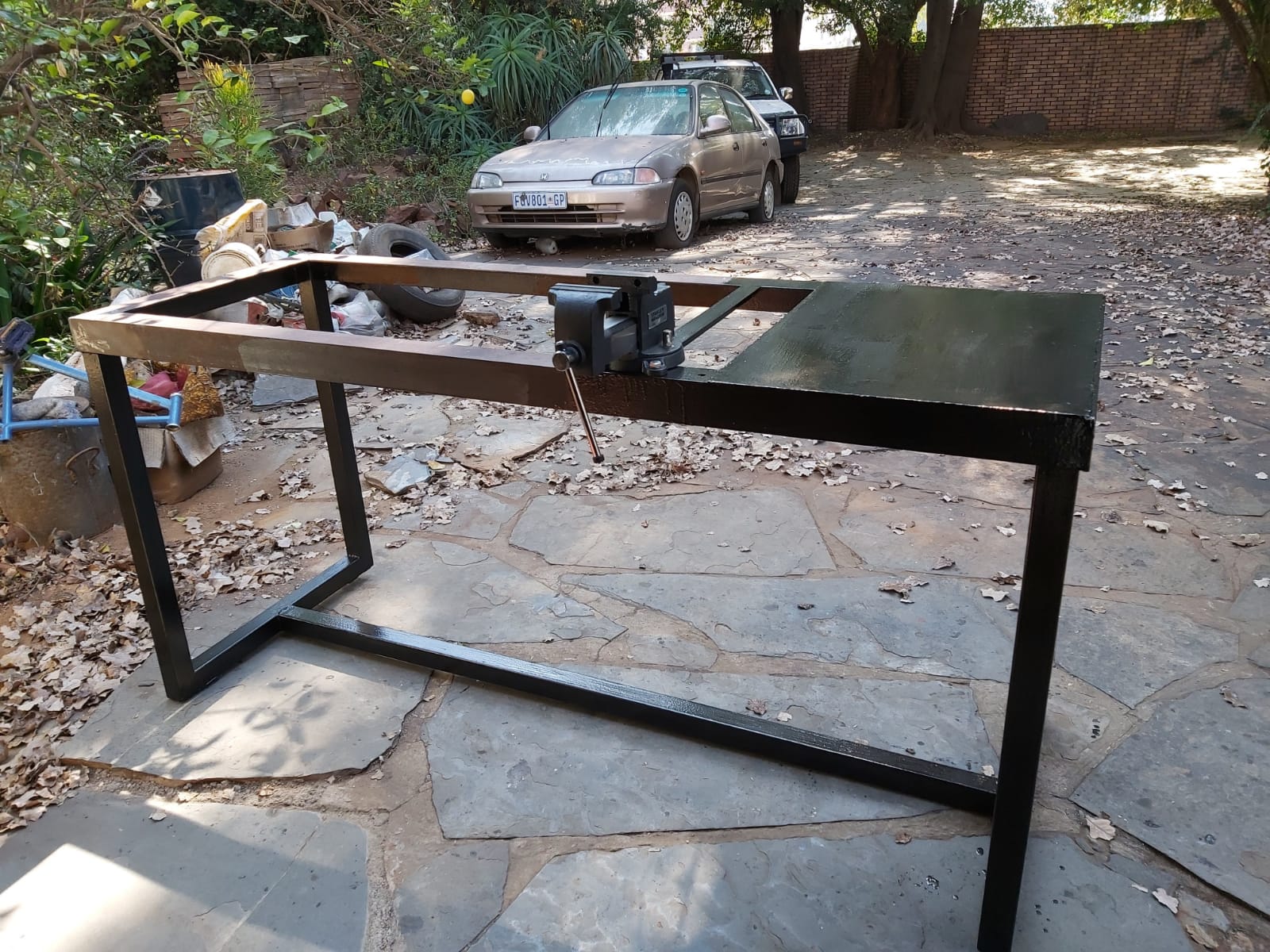

Round about now we were in the the thick of lock down and I ran out of steel. Once restrictions eased and I could buy more steel, I set about building a work bench. Working on the ground was killing my back, and not being able to clamp work pieces down was giving me some bad warping.

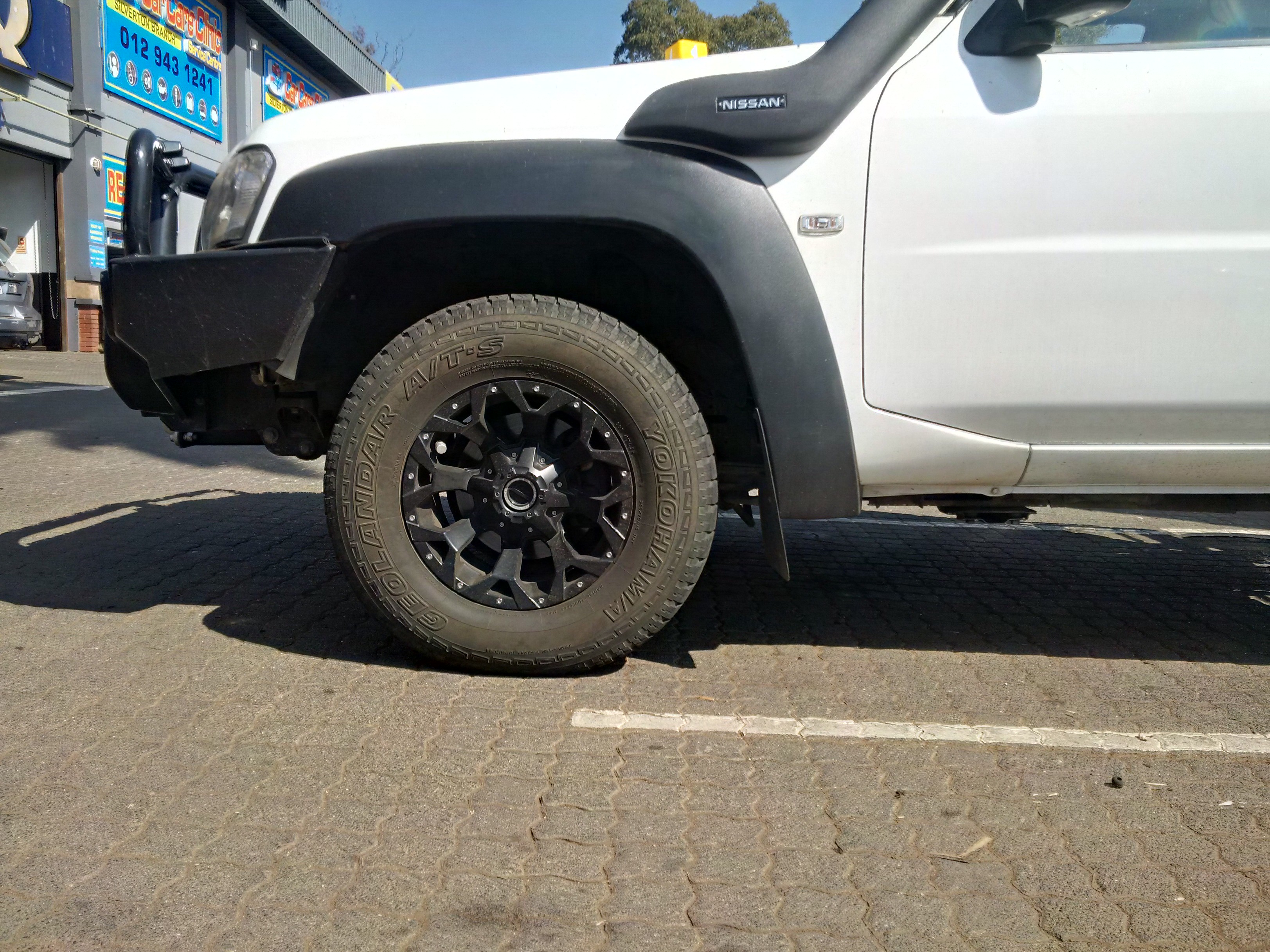

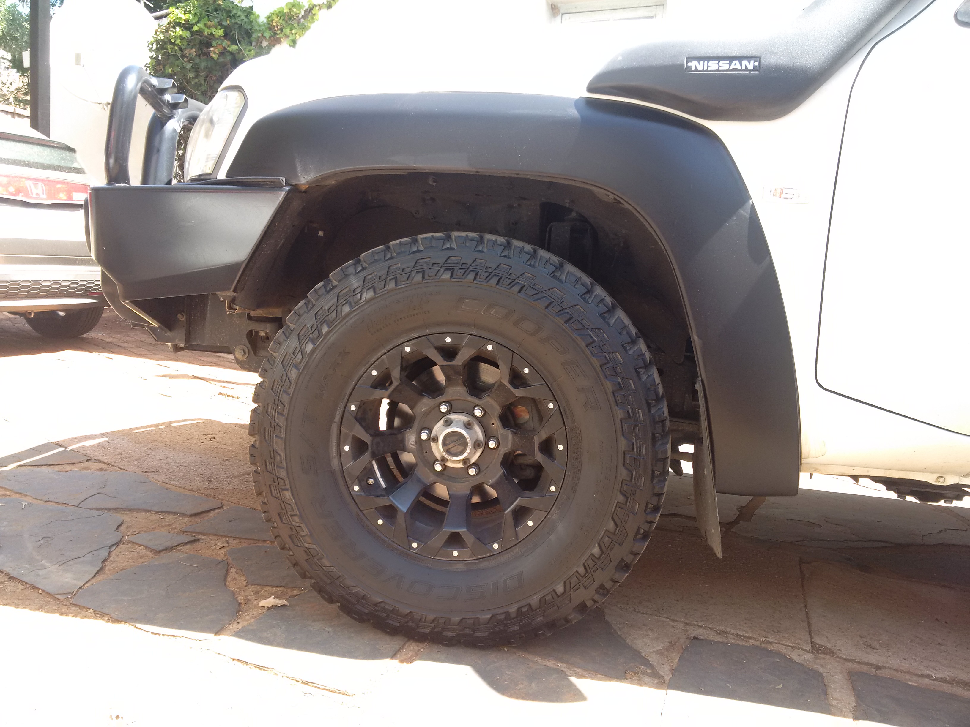

Things went slowly for a while, but a friend of mine wanted to swap his tyres and offered me 4 Cooper ST Maxx 285/75R16s for an absolute bargain.
Before :
After :

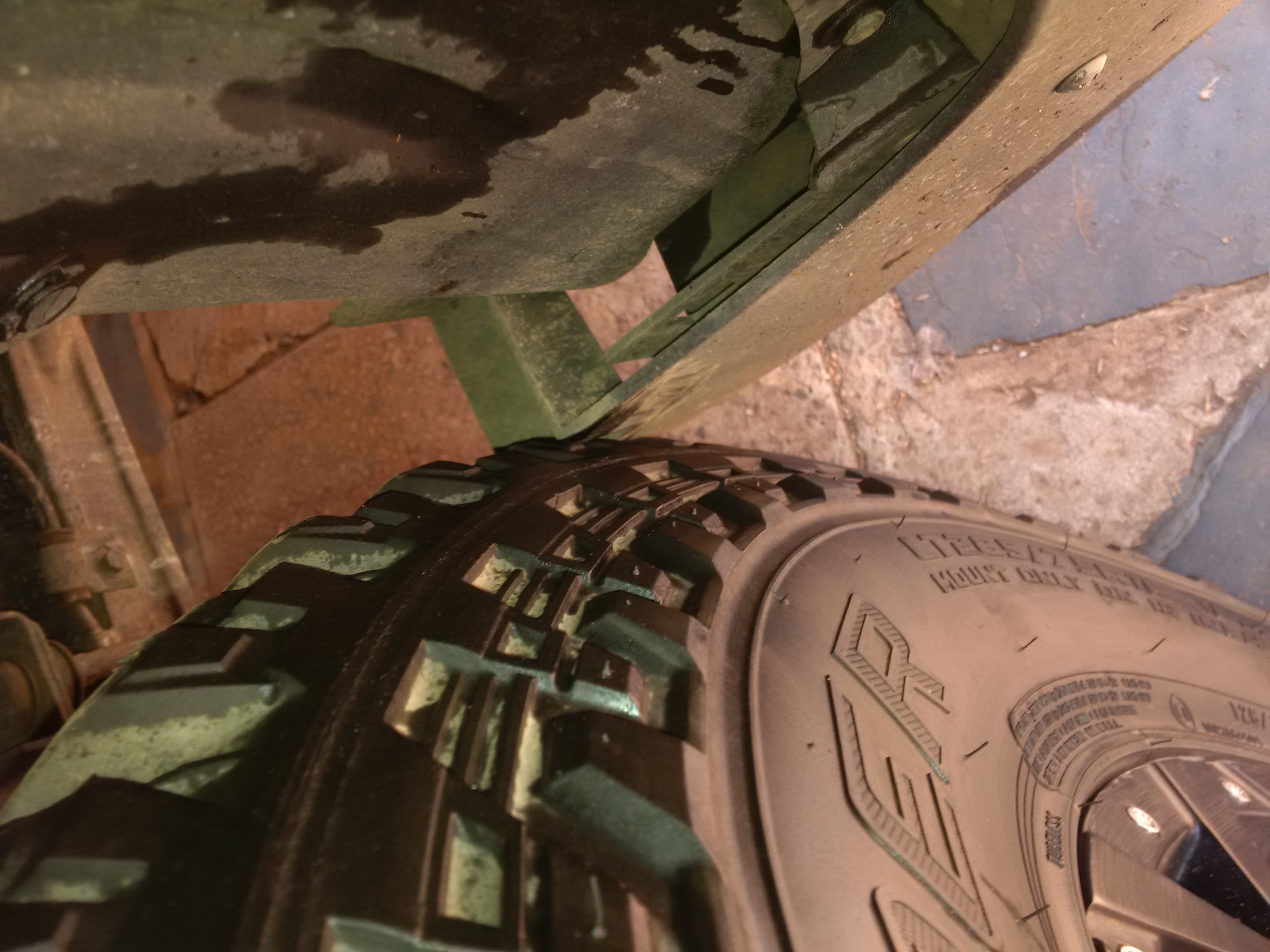

Looking better! But there was some rubbing on the front mud guard when turning. I removed the guards for now and will make a plan at a later stage.
