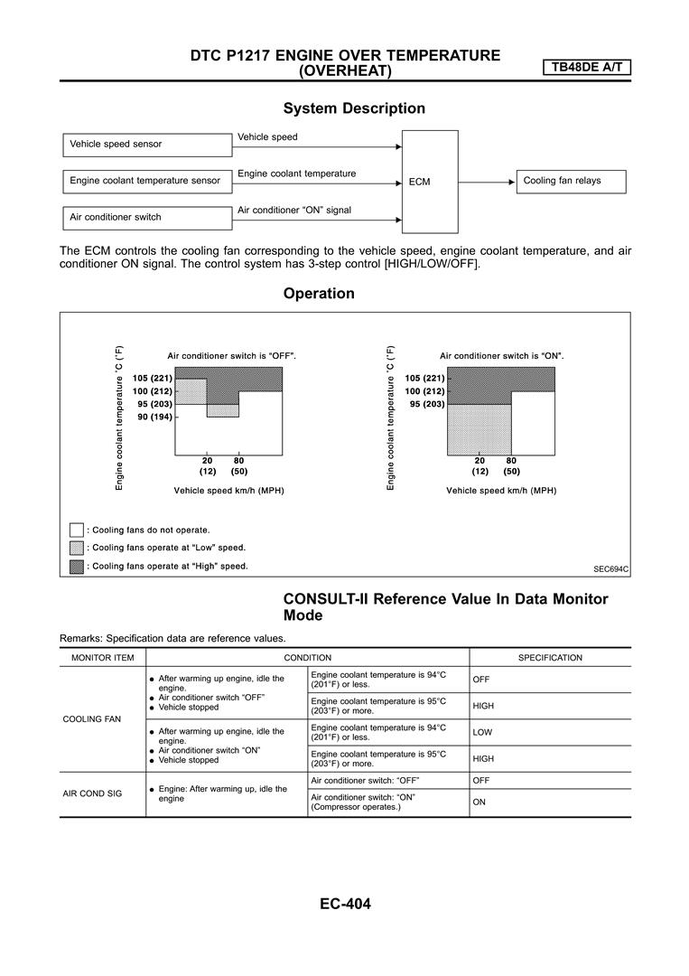

Anyhow from the diagram from the workshop manual below on what conditions will switch on the condensor fans to low, and to high speeds, I took the vehicle's coolant temp to 100C, and the fans switched to high speed, and this cooled the cabin.

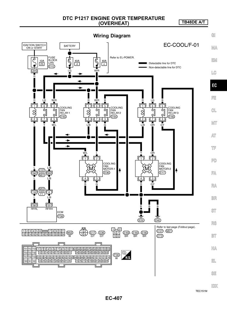

Having the fans on high speed definitely makes a considerable difference in AC cooling, so I want to hack into the high speed relay, I think relay number 3, and have my own switch to use from the cabin. I am concerned that If I use a 12V battery signal, to the relay's input, that I might be putting too much voltage into that wire, and backfeed 12V to the ECM? Can you confirm whether I am right not to do this, or the ECM send a 12V signal anyhow?

I am not really too clever with this, but I don't think you can put too much power into the relay.
However, it may be safer to just install an additional relay directly to the fan?

Just added a direct 12v to fan toggle switch on the dash... if it is hot & I'm crawling in traffic it gets flipped, seems to help a bit.

Super, so 12V direct to which wire on the fans wiring?

Used the passenger side fan, just ran a wire direct to battery with a switch on the dash. Will see if I can load some pics later.
Re: TB48 Condenser Fan Hack for high-speed.
JP... I hope you fused that power feed !!!
