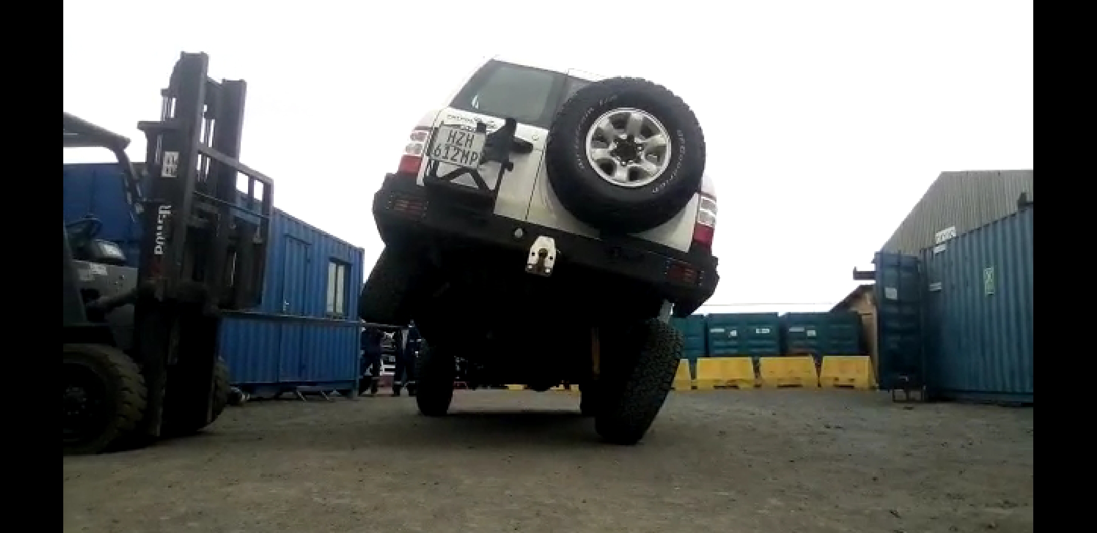

Peter broke the vehicle!
We stopped the forklift at 1m... based on the rotation of that rear axle I was a little uncomfortable to do more.
Thanx Peter. Your X-Link is amazing.
Update on the clutch: The clutch is in and I have power again baby! Ready for the dunes.
