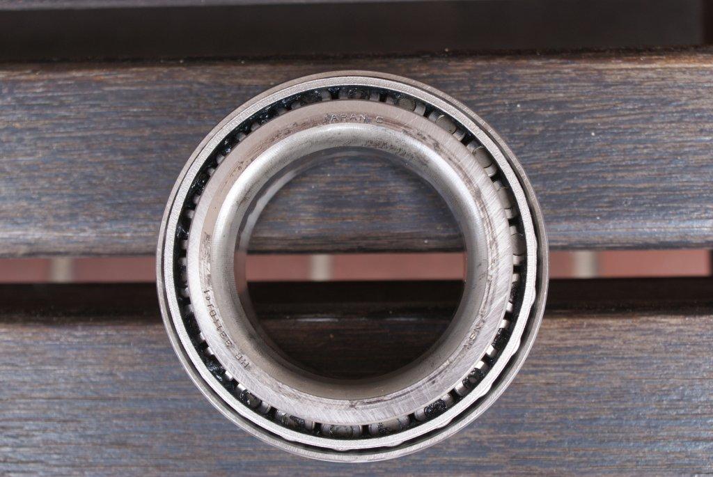

However, all the bearings are standard commercial items except the large (inner) bearing. This bearing (not available through Bearing Man but can be purchased from Bearings International, but with a small modification. The inside corner radius (shown in red in the attached pic) needs to be enlarged slightly, to 5mm. This can be done by specialized grinders, or with a pencill grinder in a lathe.
Original bearing is 33110JR, 85mm OD, 50mm ID, 26mm long.

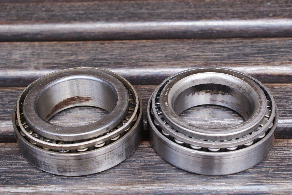

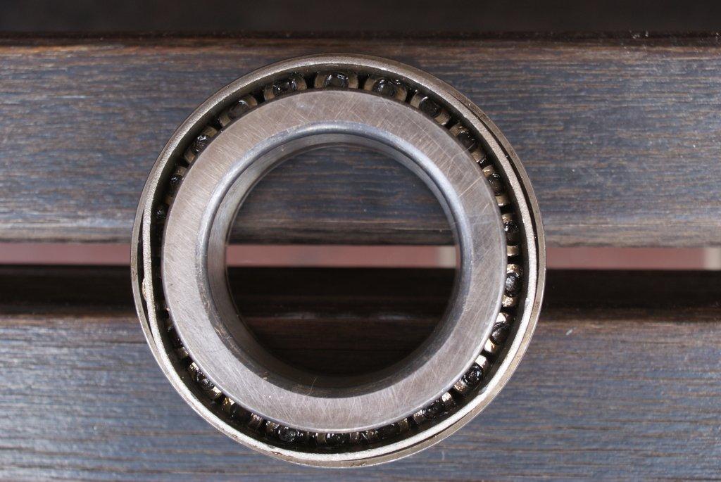

For the sake of completeness:
The inner wheel bearing has been comprehensively dealt with above.
The outer wheel bearing is: NSK/Koyo part number LM501349(cone) + LM501310 (cup). It's a taper roller bearing, 73.431mm OD, 41.275mm ID, 19.558mm long.
Inside the stub axle, there is a needle roller bearing carrying the sideshaft. I believe this to be BTM3516, 42mm OD, 35mm ID and 16mm long, but have never removed one.

Hier is fotos waarna PeterC verwys

Just an update on the matter:
I ordered the "Swivel hub rebuild kit" from Australia. http://locktup4x4.com.au/swivel-hub-reb ... -1395.html
IT DOES NOT CONTAIN THE WHEELBEARINGS! All the seals for a complete hub rebeuild, including the axle oils seals etc. plus a lot of gasket seals. Four king pin bearings and two roller bearings. All KOYO bearings. I will post a complete photographic report of the rebuild.
The "Wheel bearing kit GQ/GU" seems to contain the wheelbearings. http://locktup4x4.com.au/gq-gu-front-wh ... -1396.html Odd is the hub rebuild kit contains all the special washers, seals etc. you get with the wheel bearing kit, but not the bearings.
The outer wheel bearings Nissan have in stock (±R800 each!) The inner wheel bearings they do not have in the country and it is a matter of waiting for Nissan to get off Skeleton crew before anything certain can be arranged, but it looks to be about R900 odd each.
Bearings international (Jet Park) have the outer wheel bearings (R55 odd ex vat KML and R80 odd plus 1/2 days for the KOYO bearings.) but they cannot supply me the inner wheel bearing (33110JR) that needs to be machined. I am also not sure they understood the cup and cone are seperate part numbers.
Bearing Man Isando could get me the inner wheel bearing (33110JR NOT the JRYA2) in 1 day at 450 odd ex VAT each and R616 odd each for the outer wheel bearings. Total incl VAt is R2425.
Ace Bearings in Kempton Park got me the inner bearings (FAG 33110JR) and the outer bearings (SIN, Japanese brand) at a total of R1100 for two sets of each, in other words less than half the Bearing Man price and even much more affordable than the Nissan prices.
The seals from Nissan (I bought before I ordered the hub rebuild kit) was about R1200. This is only the three seals each side as listed by Peter's post, not all the seals and gaskets for a complete hub rebuild.
TAKE NOTE: I have an extra set of seals should anybody require, make me an offer.
Tomorrow I will take the bearings to Jack's Cutting Edge for modification, R500.
