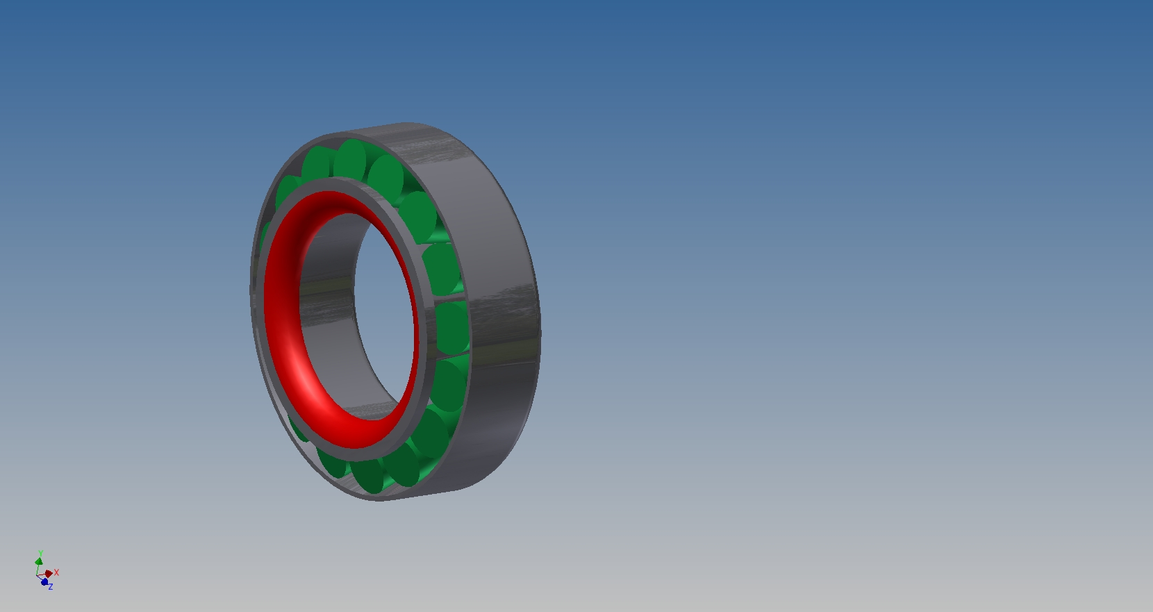

However, all the bearings are standard commercial items except the large (inner) bearing. This bearing (not available through Bearing Man but can be purchased from Bearings International, but with a small modification. The inside corner radius (shown in red in the attached pic) needs to be enlarged slightly, to 5mm.
This can be done by specialized grinders, or with a pencill grinder in a lathe.
Original bearing is 33110JR, 85mm OD, 50mm ID, 26mm long.

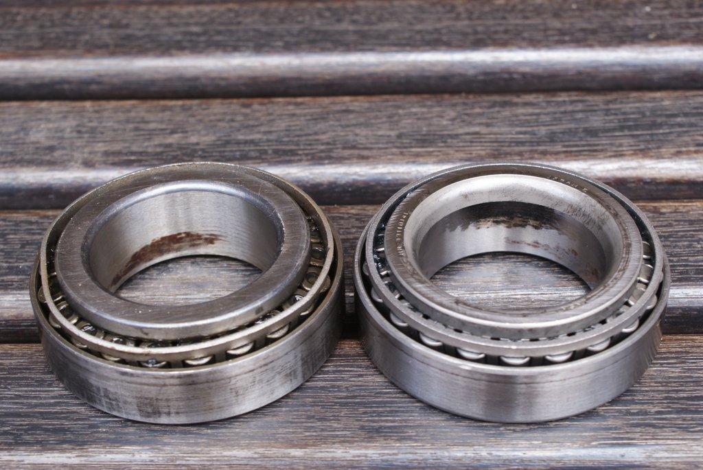

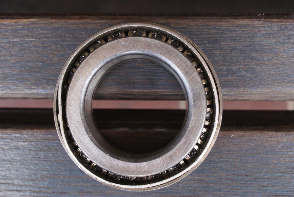

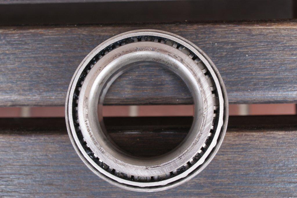

Hier is fotos waarna PeterC verwys
Wheelbearing 33110 inside been modified
Standard ARB 33110 bearing
Next to each other see modified on right
