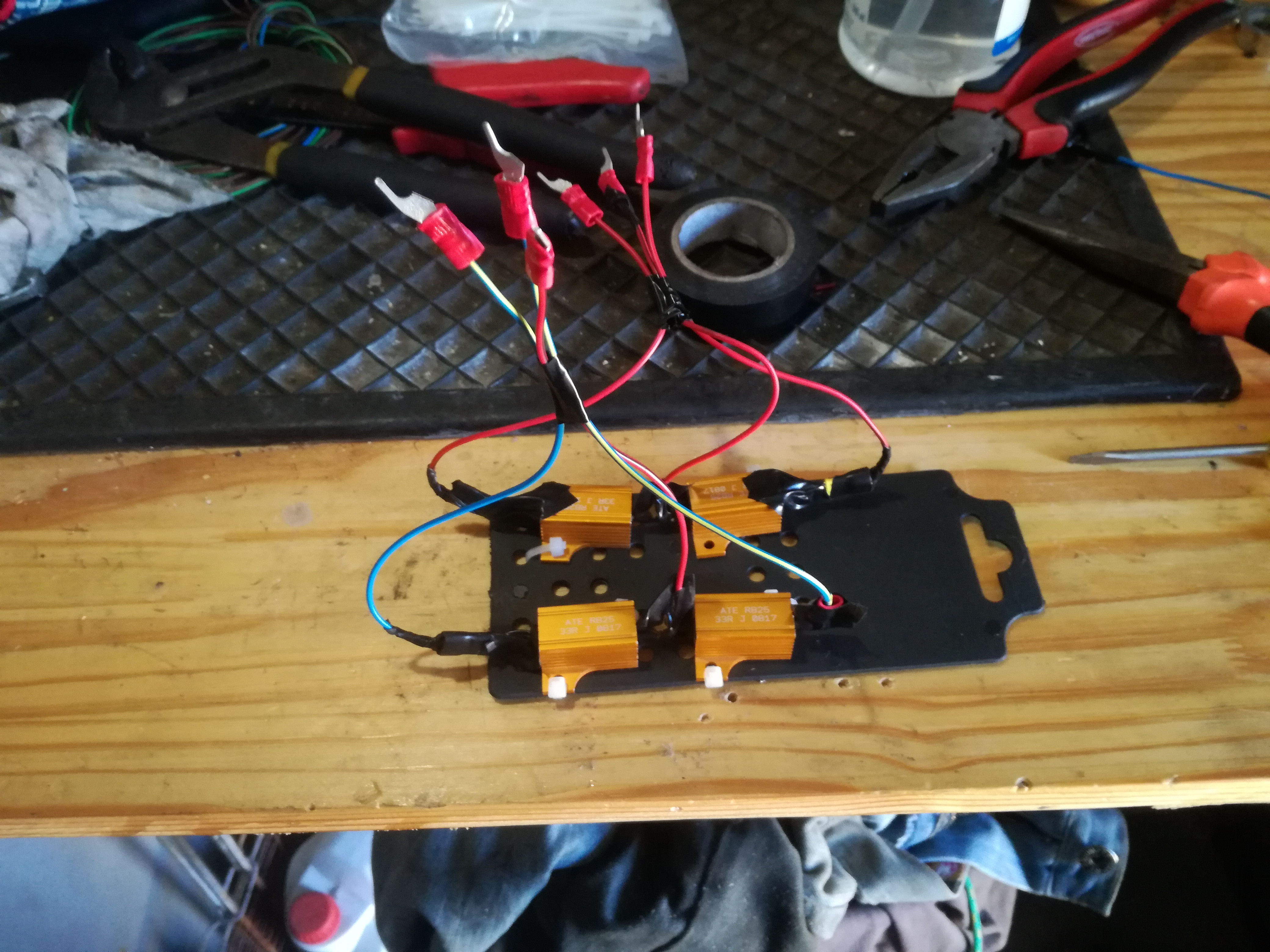

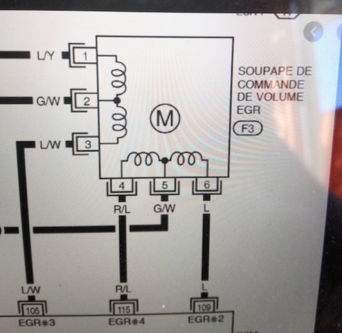

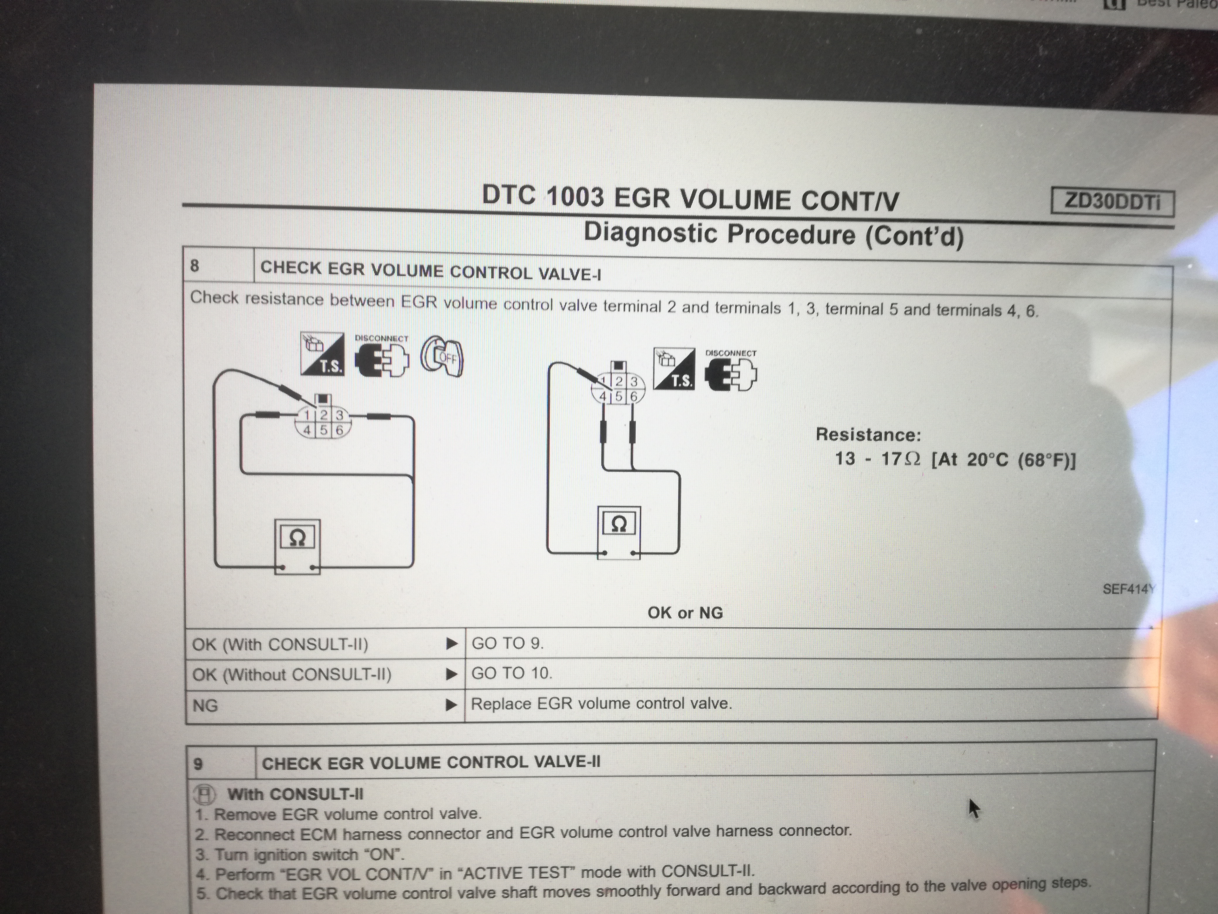

After reading up on the EGR valve in the ZD30 manuals I figured I can just use 4 resistors to fool the ECU and to imitate the EGRs resistance for the ECU to think it is plugged in.
I still had 4 resistors with 33 Ohm/25 W lying around. According to manual resistance is 16-17 Ohm (pic egr4). Double the resistance but thought Ill give it a try.

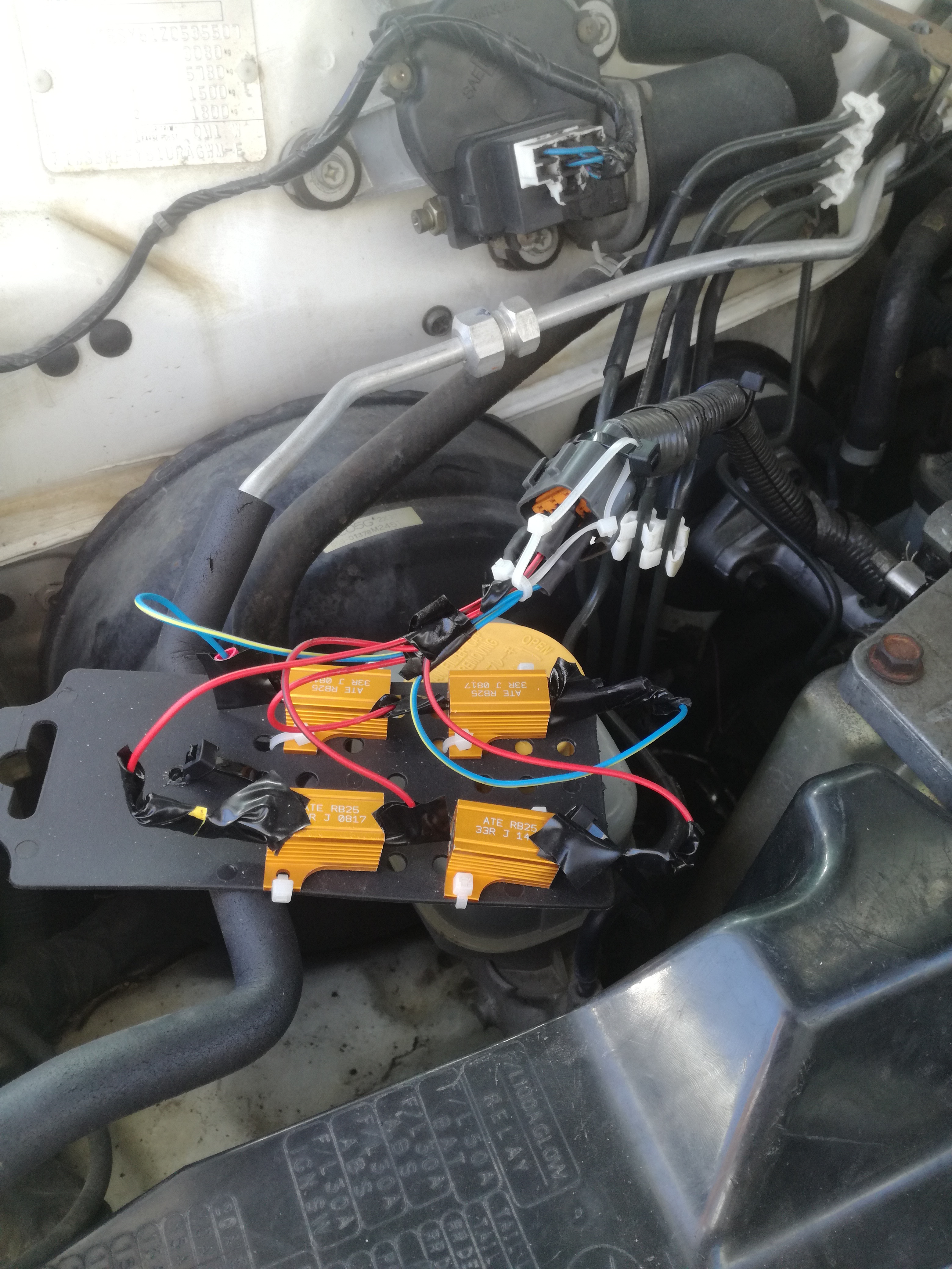

Quickly soldered the 4 resistors in place (see pic egr3) and plugged it in the EGR valve connector as per pic egr3 and egr4.
Doesnt look pretty but works until option 3 is realized. CEL is off and no more code 1003.
