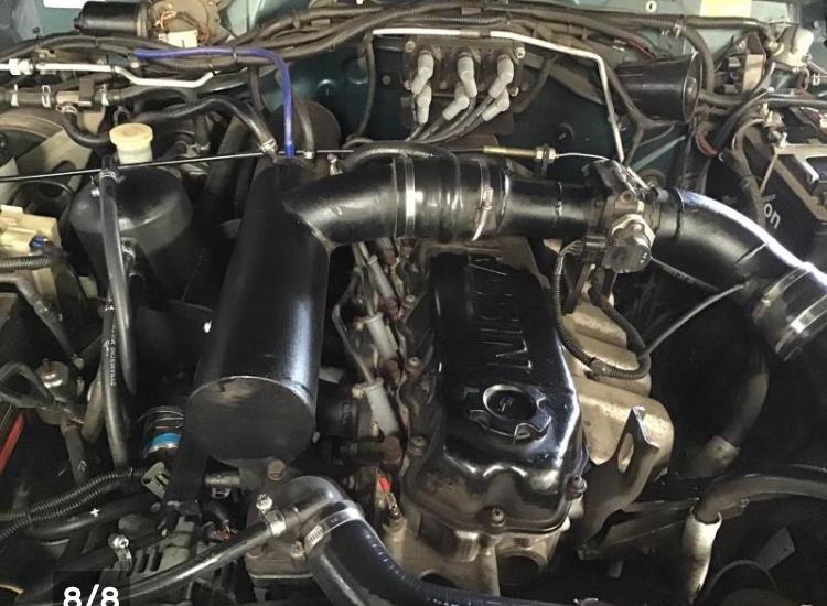

Hi Guys,
I am seriously looking @ a 1995 Patrol SGL. The salesman claims the engine is a diesel, but the registration disk says TB42. As far as I know, that means 4.2Petrol. However, the engine looks like the 4.2 diesel. It looks like the engine has some work done to it. Can someone please perhaps clarify? Also, the odometer has 220 000 km on the clock. What shall I make of it with relation to the engine? I love this shape, but I don't feel like endless drama.
Thanks for parting with your knowledge
Johann
Johann

I don't know Patrol engines but I see coil packs and spark plug leads. So petrol IMO. But itlooks like it was converted from carb to some sort of fuel injection

Agreed. Coil pack and no carb. So I guess must petrol but at some stage made fuel injection.
If it is diesel, it would have been a conversion.
The SGL was the petrol model. Die diesel model was the ST.
