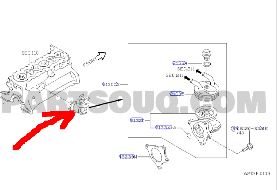

The oil cooler sits on the driver's side of the block underneath the intake manifold. Basically above the oil filter (it screws into the bottom of the assembly). Highlighted in the image below.

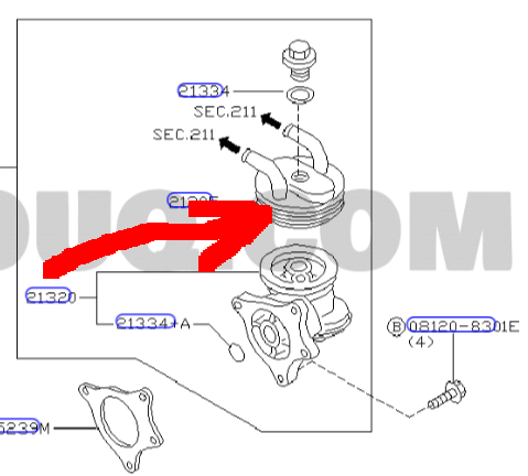

From the manuals, I discovered that the top of the oil cooler can be removed. This is the bit where the water inlet and outlet are located (highlighted below).
It's very simple to do - 17 spanner and a single bolt that comes out at the top, and then you lift the cover off from the top. Be careful you do not lose the bolt (it is obviously part of the oil cooling "matrix" gathering by the holes in it) or the rubber "O-ring" which seals the cooler.

Apologies - don't have photos as my hands were dirty and I was busy. But the diagrams above should help in understanding the process.
