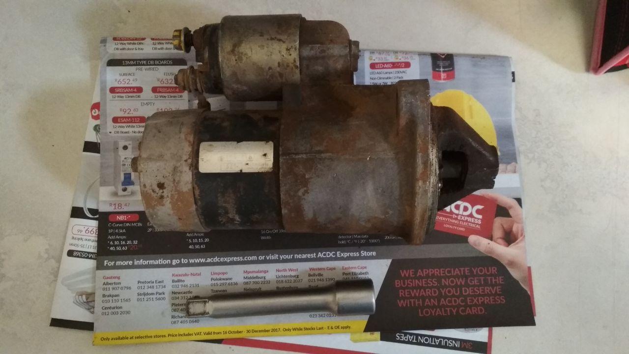

I was a bit apprehensive in tackling this task as I've read it is a bit of a pain to get out, but fortunately it was a quick 15 minute job.
The little extension did the trick. The wrench and extension just needed to loosen the bolt so the spanner could turn it the rest of the way.
I'll see about a replacement on Monday. Thanks for the advice Ian.

Re: Patrol 4.8 Starter
Paul - if I may ask. How long is that socket extension ? Also tried with mine. My socket extension seems to be just too long to fit nicely.... Would you mind measuring it and posting the length ?pgreeff wrote: ↑13 Jan 2019 10:45 I was a bit apprehensive in tackling this task as I've read it is a bit of a pain to get out, but fortunately it was a quick 15 minute job.

Total length of the extension is 12.5 cm. I measured it so I can buy my own for the same reason. My neighbour was kind enough to lend me a selection of his favourite extensions.

Weird. My extension is 12.5cm on the dot. But seems to be just too long to fit. Did you remove the top bolt from the top of the engine ? Or from underneath ? Just curious. I battled like crazy to get that bolt out....

Perhaps that is a difference between the 4.5 and 4.8?
I removed the top bolt from the top of the engine. The wrench could only turn ever so slightly, just enough so I could undo the bolt with the spanner. Once the bolt was loose enough I used just the extension.
I have also read of people coming in from the bottom, but I can't see how it is possible.
Removing the starter on a manual 4.5 is a breeze. 10 minute job - if it even takes that long, and that extension is not required.
It is the 4.8 which gave me grey hairs the other day., and for which my extension seems to be just, just too long....
I eventually got the top bolt loose from underneath the vehicle. But I was speaking fluent French by that time....
Anyways, was curious. Will see if it is better when I install the new starter when it gets here. This will be tomorrow or the day after.

Ian I use a 3/8 drive very long ext and ratchet to remove them and are working from the front of the engine mntg to get the top bolt out

Ian, I just had another thought, I recall my ratchet head was too big to fit. I ended up using the breaker bar which needs a lot less space. Perhaps that explains why it was easy to get in there.
