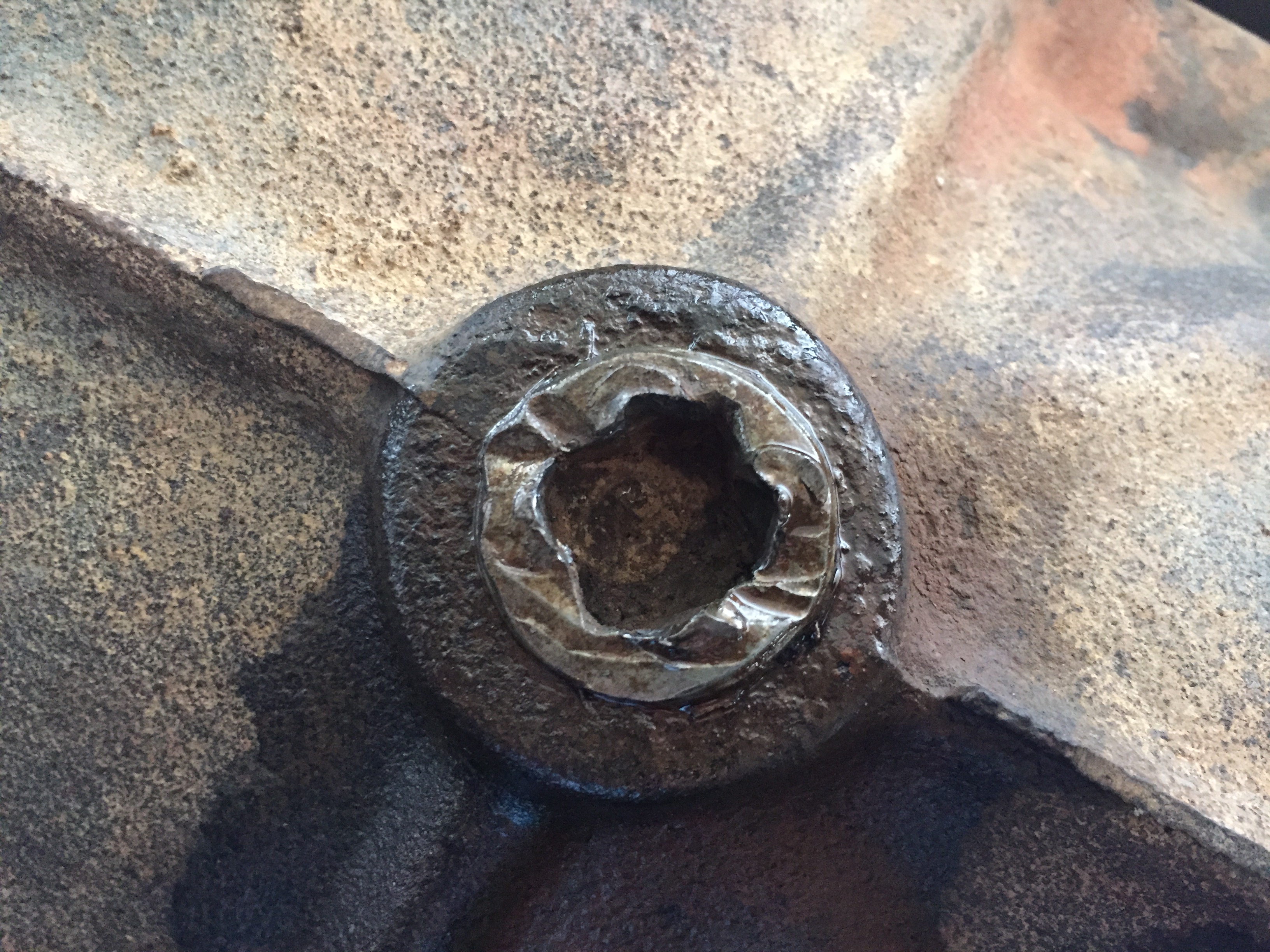

- Posts: 3359
- Full Name: Fanus
- Has thanked: 244 times
- Been thanked: 219 times
Re: Gearbox drain plug stuck
Here is mine.....
Same problem
Same problem
