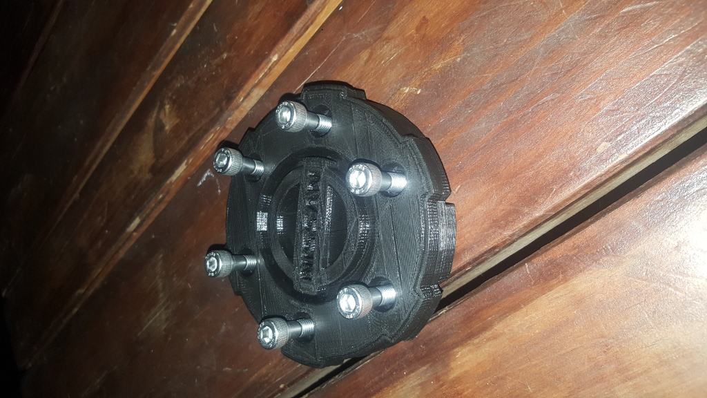

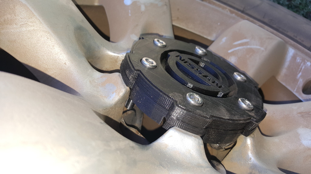

I've been mucking around with 3D printing recently. And my first "working" project is done.
In short: if you need rear centre caps for pre-face lift GRX rims, I can print you a set. I've not worked out costing yet, but it will be about R400 per set of two - basically just time and material, as well as a contribution for the design (the design is not mine).

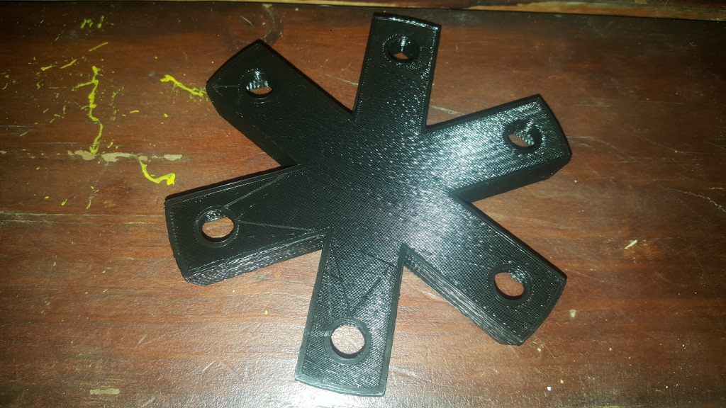

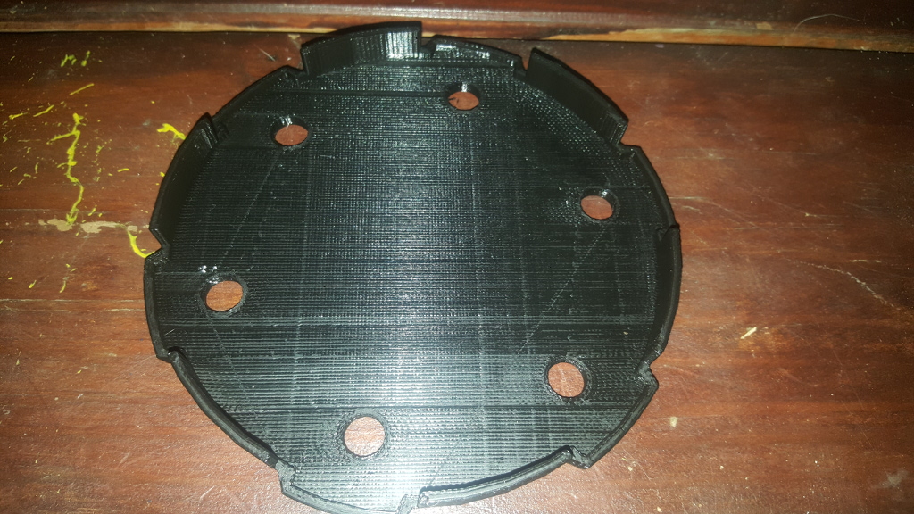

Set consists of three parts and stainless M8 hex bolts and ny-lock nuts. There is a bracket which fits behind the flanges in the rim. A larger piece which aligns with the spokes of the rim, and the plate you see from the front.

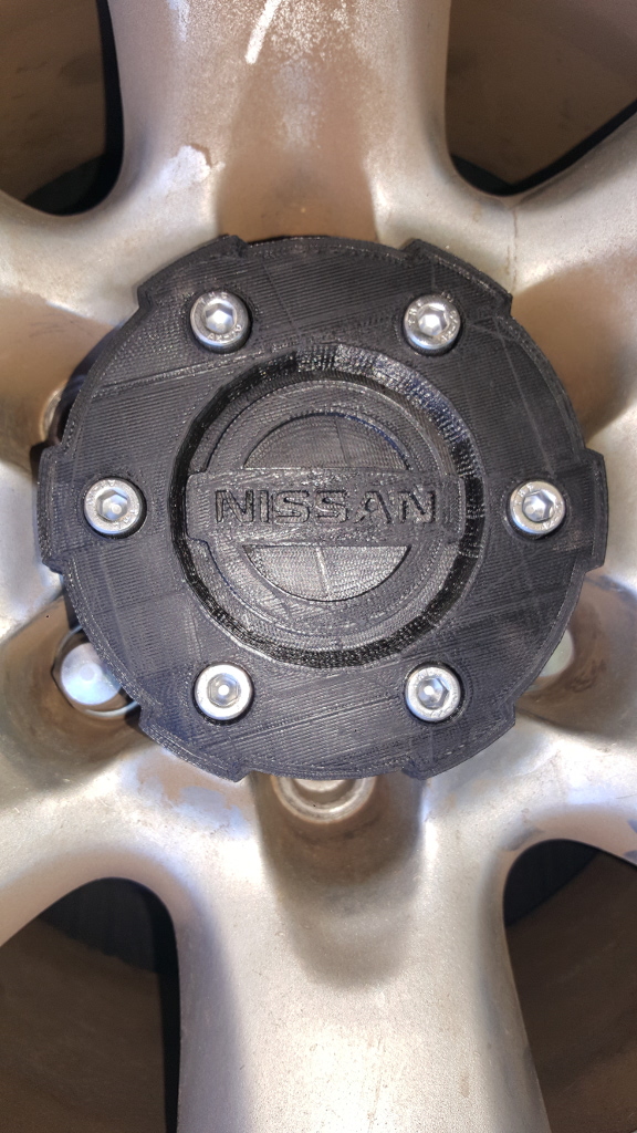

The pictures are of a prototype I printed to see if the thing actually worked. As such, print quality is "draft" and the material is PLA. This is not suitable for the "real-world" application.
Production models will be printed with ABS, and will also have an "acetone vapour bath" to get rid of the printing marks (the "striations" you can see in the photos).
If anyone needs centre caps, please let me know.
I'm also well under way getting a similar steel rim centre cap sorted, as well as similar front wheel centre caps.
I'd also like to see whether I can get my hinds on a post-face-list GRX rim, as then I can make a plan for them as well.

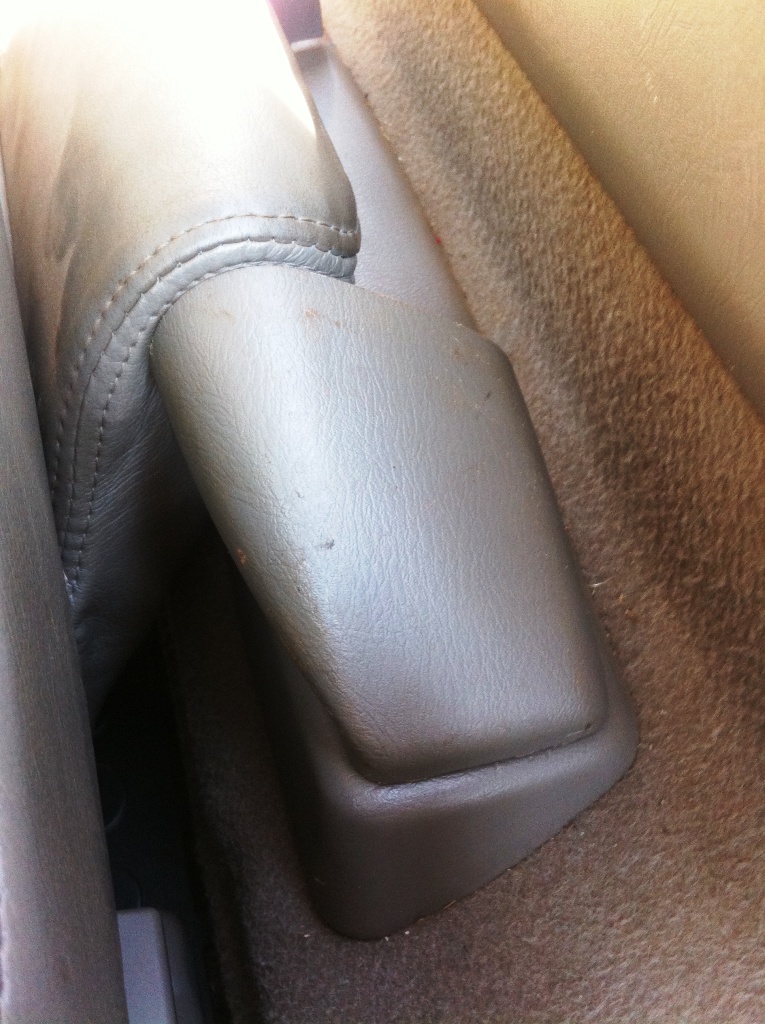

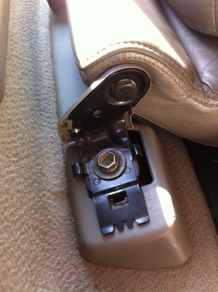

How difficult would it be to "print" these caps?
(My front right side one is missing)
- IMG_5576.JPG (292.86 KiB) Viewed 8634 times
- IMG_5575.JPG (330.58 KiB) Viewed 8634 times

Re: Y61 Pre-Facelift GRX Centre Caps
Fanus,
They should be relatively easy. Two issues though:
1: I won't be able to replicate the finish - ie: the pattern on the part.
2: I won't be able to match colour. Unfortunately, one is relatively limited in terms of the colour of filament one can get. The only way one would be able to get a colour match is to print in white and paint the part. Fortunately, a bunch of filament types are "paint-friendly".
Let me know.
Ian
Let me know.
Ian
