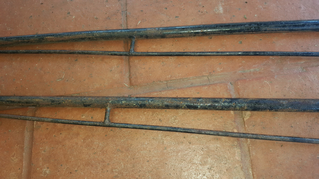

Canvas and structurally, the awning was sound, but the rust... I think Tinus spent too much time down at the coast in Mozambique... :rolling: :rolling: :rolling:

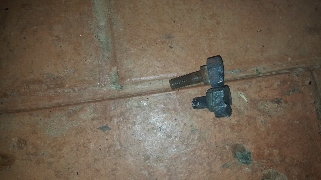

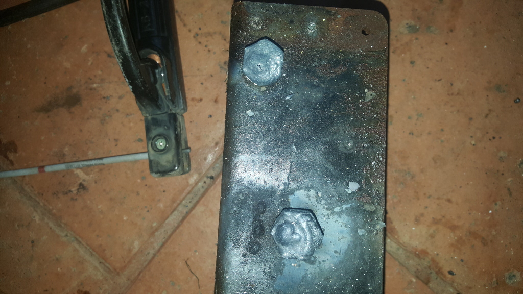

The awning uses allen bolts at the hinges, but the big issue with this was that despite copious amounts of Q10 and Q20, I just could not get enough leverage onto the bolts with an allen key to break the rust. So back to old school nut removal tricks and welded normal nuts onto the allen bolts. This allowed me to get enough force onto the rusted bolts to get them loose. This worked very well, except for one bolt which broke off... I drilled this out and retapped it.
Next step was getting rid of the rust on the awning's arms. Sanding them down was a very exhausting and painful job... But it worked well...

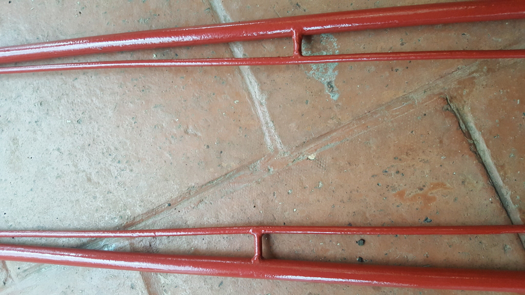

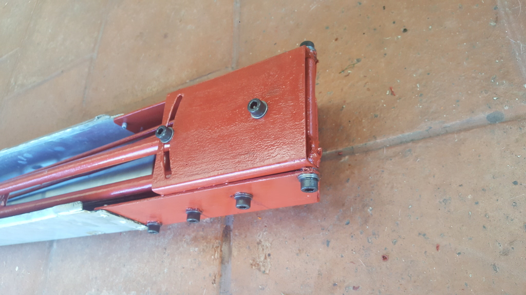

I did most of this on Good Friday, and not a single hardware shop was open, so I was restricted to what I had at home. I found that still had some "Hammered Red" Hammerite in the garage (I love the stuff - my favourite paint for painting metal), and painted the various bits and pieces. I left the paint to cure for a few days.

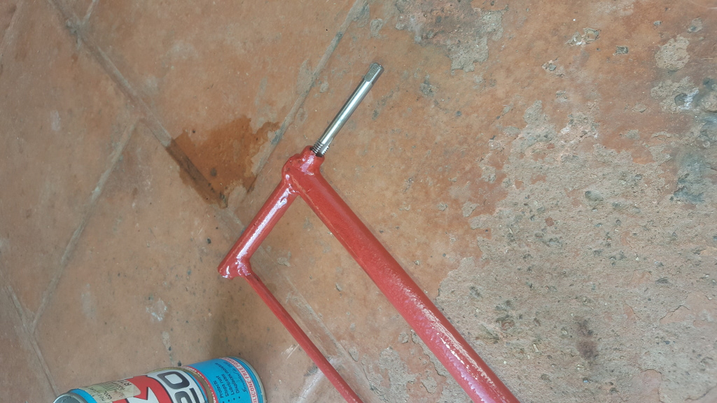

The final step before reassembly, was to clear up the rusted threads using the same tap used to fix the broken bolt thing...

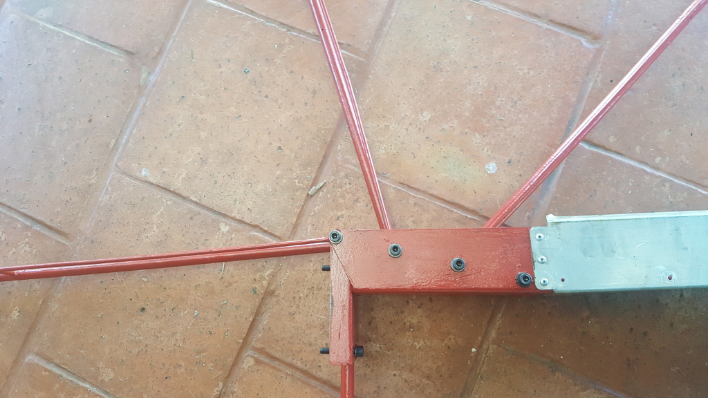

And then I reassembled it all...
