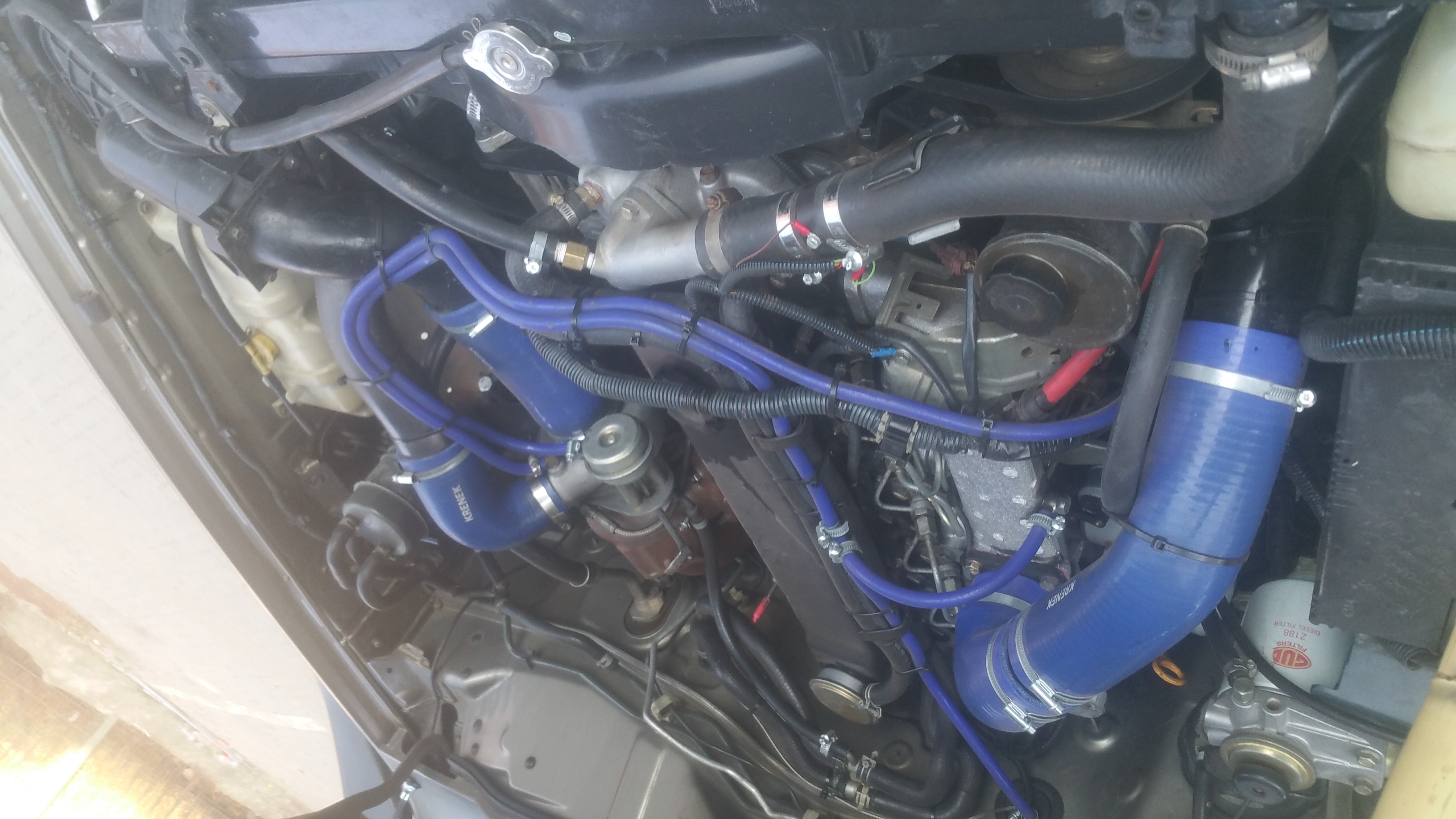

Cedic they want dik money for that and guys like andre steyn says his welded one is letting him down ....probably a reason why they make manifolds from cast iron in the factory. ....i will wait and here from Piet on that one ......i like the top mount turbo more ...UD does it that way ....let me put a pic .

If doing a specialized casting, it would be quite easy to put on a coulle of "lugs" to mount a heat shield.
If it looks something like Tinus's, it would also be simple to put in a lug from underneath at the turbo flange (thus at the collection point) for mounting the EGT probe. Just make sure it gets drilled and tapped as standard and before installation.
As for performance, i can't really comment but have been told that it mostly affects spool-up time.
How much (and how much money that's worth) would be a question for the owner to sort out.
I have had three sets of branches in my life. Two of them have cracked, and one basically fell apart completely, although i believe that was a result of adding heat shield tape to an old manifold.
I suspect the life of a set of branches is lroportional to the skill of the welder.
There is no doubt that a very compact manifold like the one shown above will be more robust.
