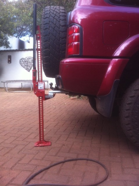

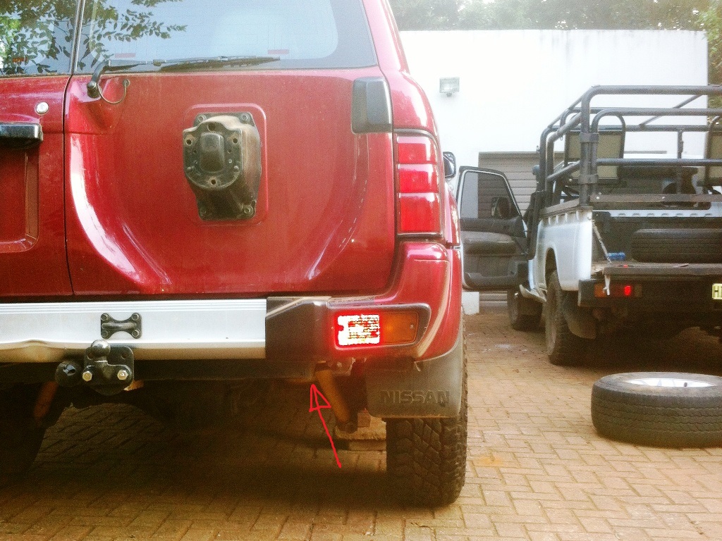

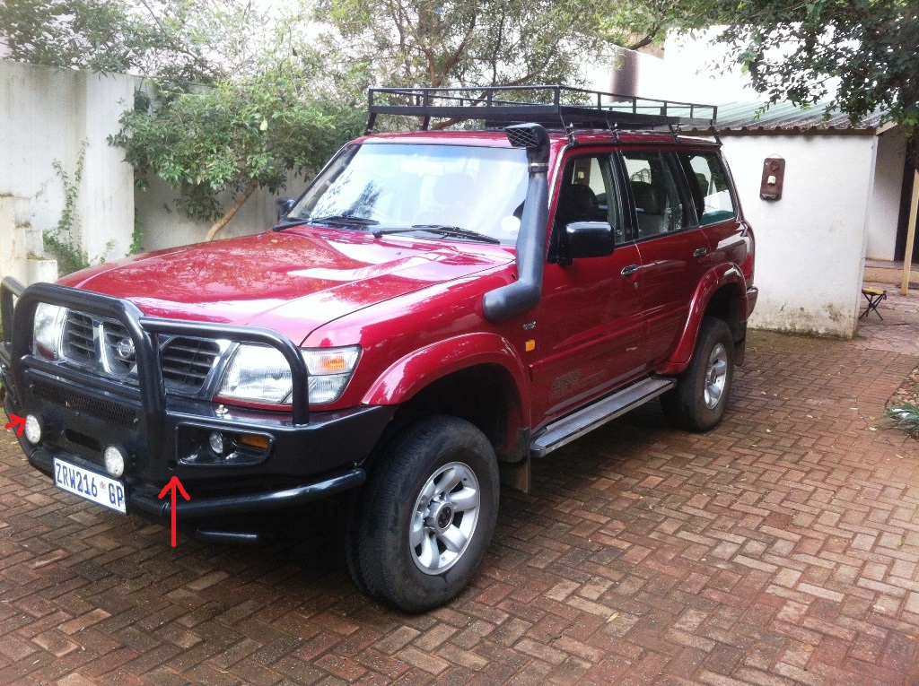

Hi! I had an Ironman bull bar installed recently. It has 2 slots for fitting a HI-Lift jack but at the back there are no jacking points, only a tow bar. Would you suggest I have the rear bumper replaced with one that has jacking points or have jacking points fitted to the tow bar? (? how
) Which rear bumper would you recommend?

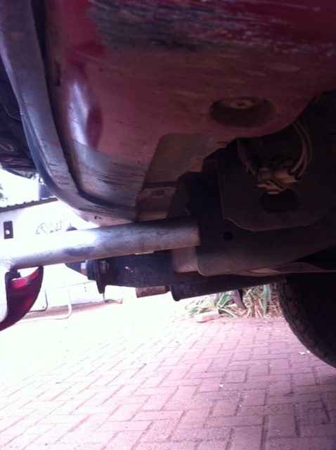

I am considering fitting hilift jacking points on the sides of the towbar bracket. Not sure if yours got the same setup.

No not really, it doesn't have to protrude past the bumper. I measured it the other day. (will take a photo later to illustrate this). Only the front part (maybe 5 cm) of the "jack extension" have to be in the jacking point to work.OEBIE wrote: Problem with fitting jacking points to the tow bar is that they will have to be quite long to clear the back bumper and even longer on the right under the spare wheel!
My front bumper's jacking points only allow about 5cm of the jack extention/shaft to be inserted, it works fine like that.
I saw a photo of someone on the forum's patrol, who got jacking points on the towbar bracket where I pointed out. Just cant find that photo now.
