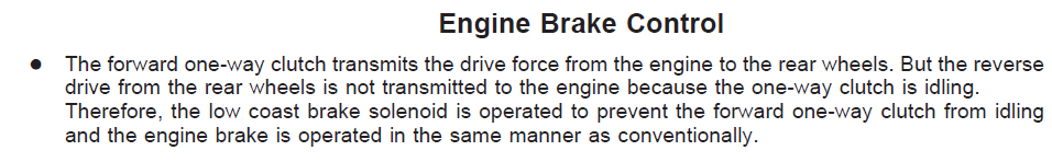

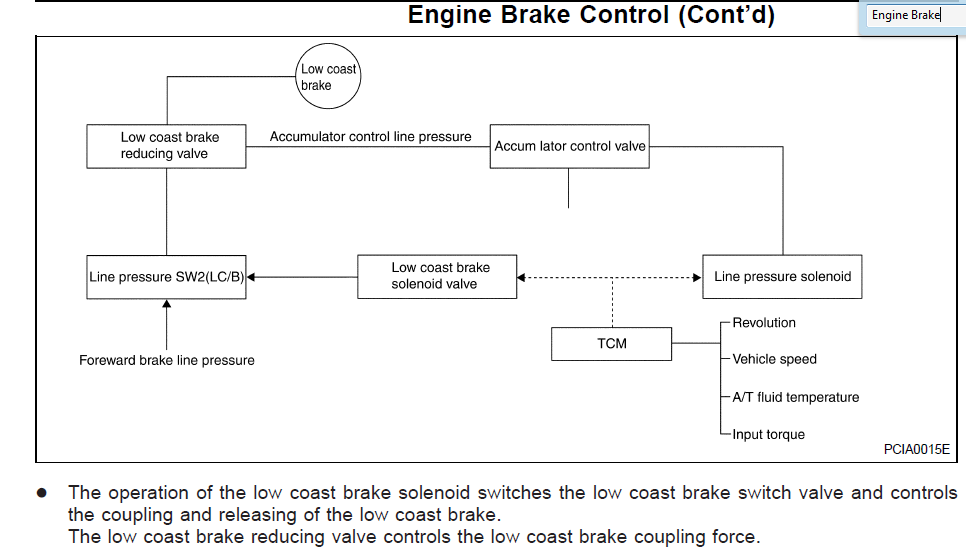

Re: torque converter behaviour
Johannes,
This is according to the manual.
Hope this is of some help.
Riaan
Riaan
- Engine Braking2
- Engine Brake1.PNG (46.68 KiB) Viewed 5248 times
