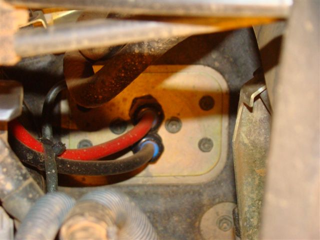

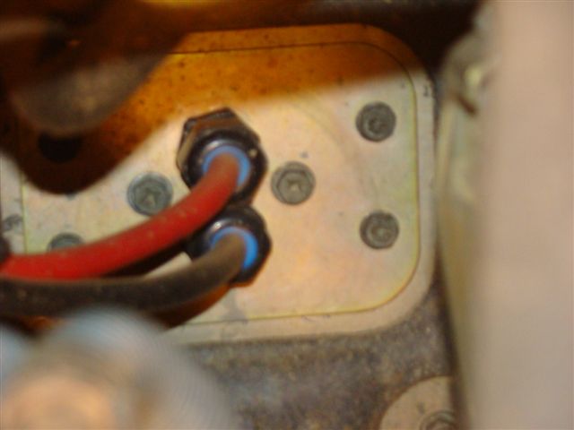

Saltman,
On my GRX I used the blank plate where the cluth pedal supposed to be.
I removed the plate, drilled 2 x 20mm holes with a wholesaw and inserted 2 x PVC cable compression glands.
Now the weldingcables can acces the cab, and are well protected.
- Patrol 003.jpg (37.54 KiB) Viewed 1851 times
- Patrol 001.jpg (53.32 KiB) Viewed 1851 times

Re: Where to enter cabin with cables?
Bring your VHF cable in through your existing arial cable grommet. The battery cables can be inserted in the main grommets at the back of the car. This will bring the cables in at the back where you want them.
