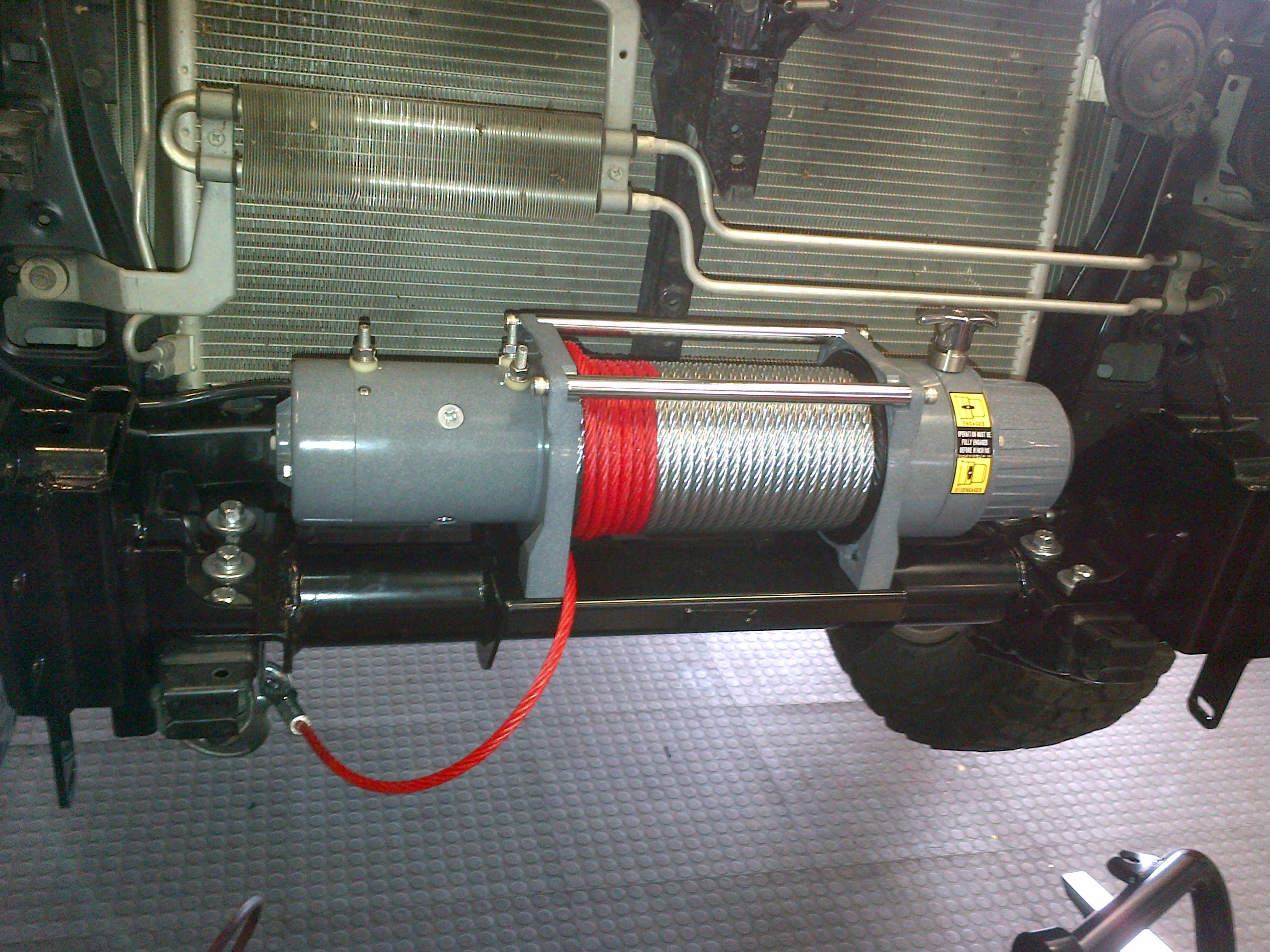

Thanks Josh. Do you have to put the winch in the bar before you lift it onto the vehicle or can it be put in afterwards?

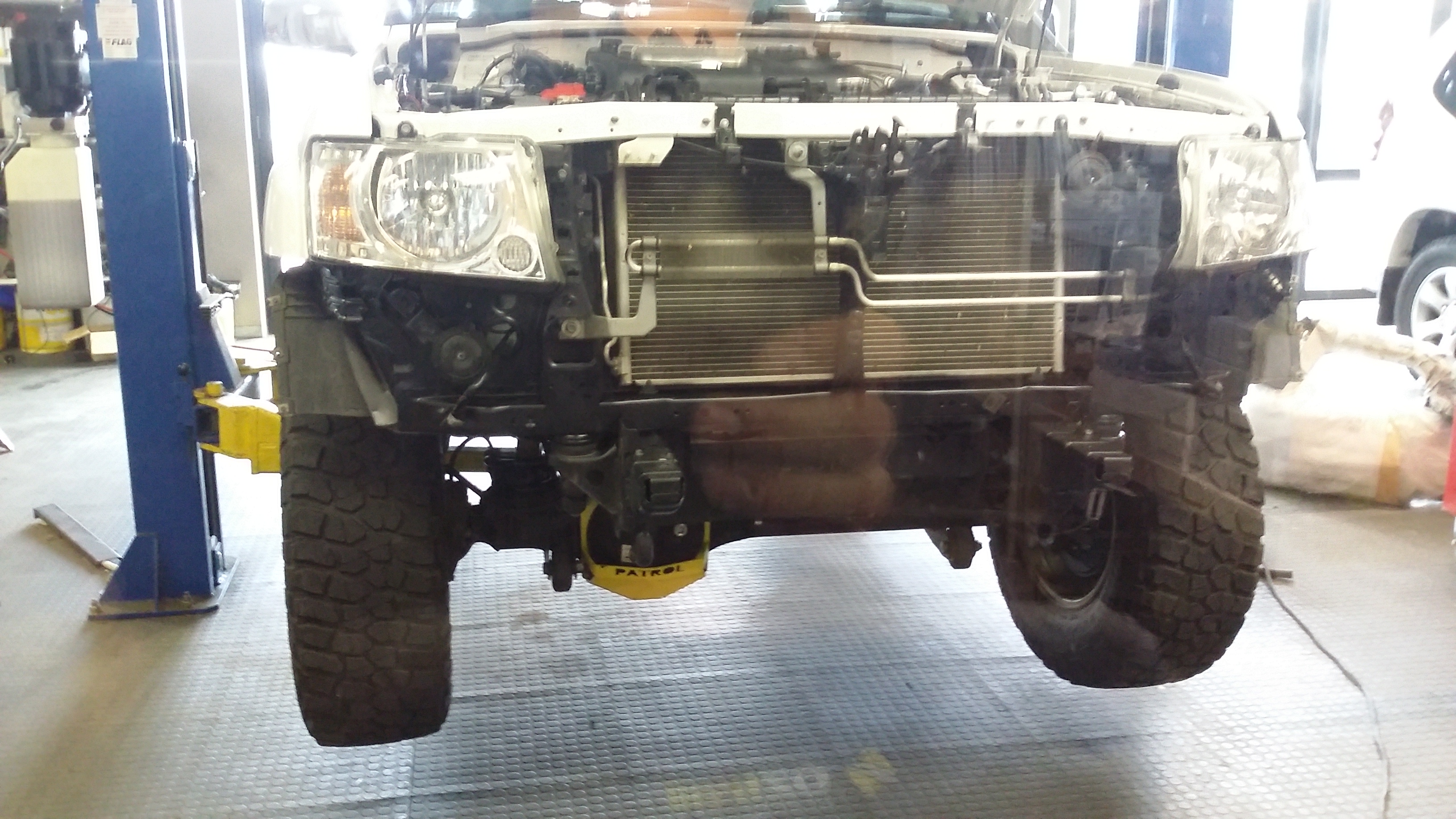

Post by AndriesS »
Clem, on the ARb bar there is plate , once removed you can squeeze it through, however it's easier to get the winch and fairlead in position when the bumper is off the car. again on the ARB if I recall it were 3 big bolts per side to remove the bumper and if the lights are not hard wired in but with connectors then it's actually very easy to disconnect and remove the bumper to do the winch.

Clem,
the bumper needs to come off when you do the winch. The winch plate bolts seperatly to the chassis On top. Thats why I did the winch and bumper at once. Was an very painfull Process. The pain came from all the money it cost :lol: but at least its done. If you can do it at once its better. Tinus can get you a nice price on a cummup winch. Other wise you can do the winch later. If you do it yourself its nice. If not you wil pay labour twice. The Voetspore guys only charged me for the bumper labour so the winch was done for free. Had I done it seperatly they would have charged me twice for labour. I stood with them during all this and its a tough job. You wont manage alone. Help will be needed.
At the end of the day I fitted the bullbar and the winch, labour included for less than a ARB bumper. Just make sure the spray the part below the head light line black. This helps to hide the bits at the back. If you stand 1 step away from the car it all looks sweet.

Many thanks Josh. I think I'm going for that setup then. It seems to make sense.
