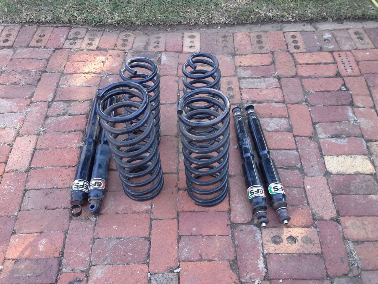

Nissan Patrol EFS Suspension
Nissan Patrol 4.5 / 4.8 - EFS Suspension
2 x Front Coils
2 x Rear Coils
4 x Shocks
± 75mm lift
Price: R 12 500.00 (negotiable)
Contact: Stephen on 072-447-5163
2 x Front Coils
2 x Rear Coils
4 x Shocks
± 75mm lift
