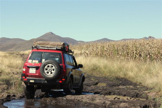

I fitted airhelpers at the back and it does not really influence the flex that much. See picture below, the Patrol was heavy at the back and the airhelpers pumped to 3 bar. Due to the suspension lift (2 inch) I also fitted spacers in the coils to keep the airbags in place.
