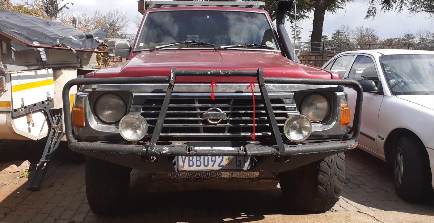

So here's the next step of the process:
The distance between the lip of the GQ's bonnet and the top of the bumper is 360mm
Annotation 2020-06-12 112451.jpg (282.94 KiB) Viewed 20975 times
But the top of the grill is solid for the first 90mm.
The radiator extends right up to the bottom lip of the bonnet. So there is a good 25% of the radiator that's not getting a direct supply of air.

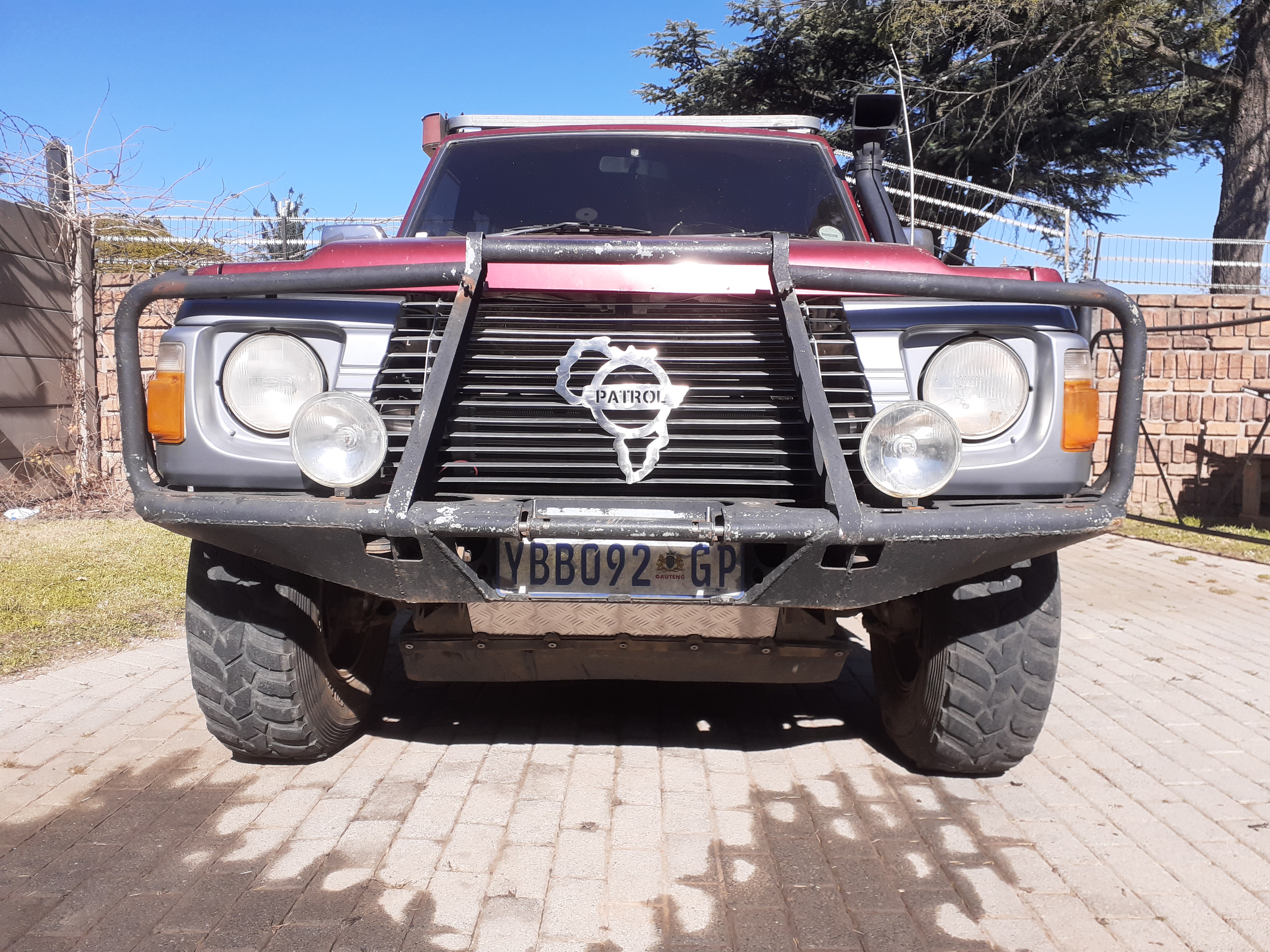

Re: Me and bad habits!
Now I just need some warm weather to see if it works...

Nicely done - that badge looks amazing! :bravo:

What did you paint the headlamp surrounds with? I want to paint my grill - not a fan of chrome.....
Cheers, Gareth

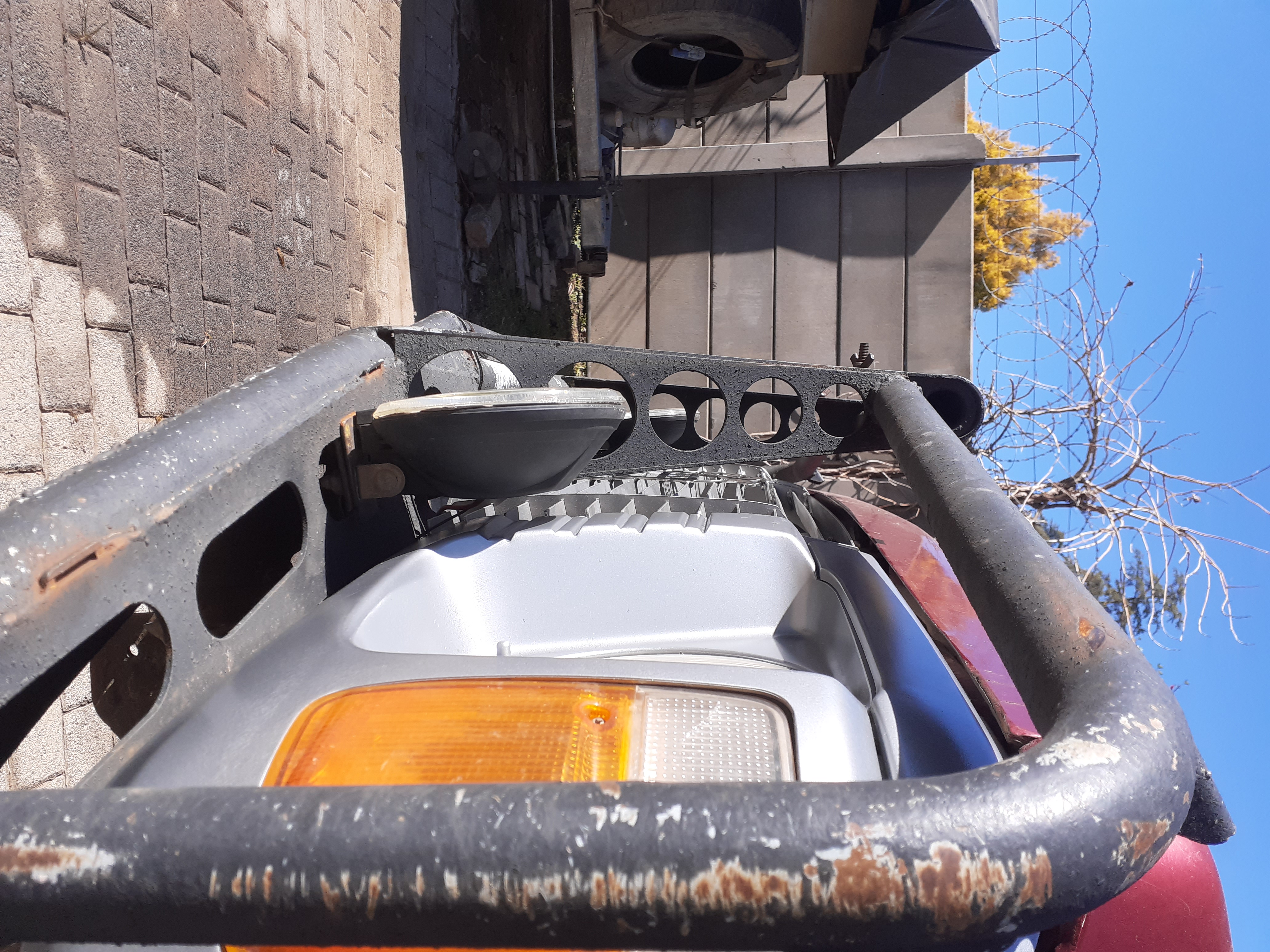

Steele wrote: 12 Jun 2020 14:05 What did you paint the headlamp surrounds with? I want to paint my grill - not a fan of chrome.....
Rustoleum rattle can "hammered finish" grey. Not sure how well it'll last.
