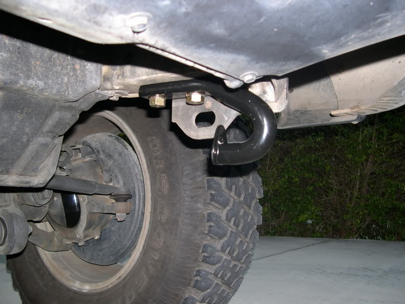

Peter Connan wrote:Therefore, the 4.8's standard recovery points should fit.They use the same bolt holes that hold the plate under the radiator. You can buy them from Nissan for about R550 each, and I promise they are stronger than anything you can buy anywhere else.
Is this the standard recovery point(hook)?

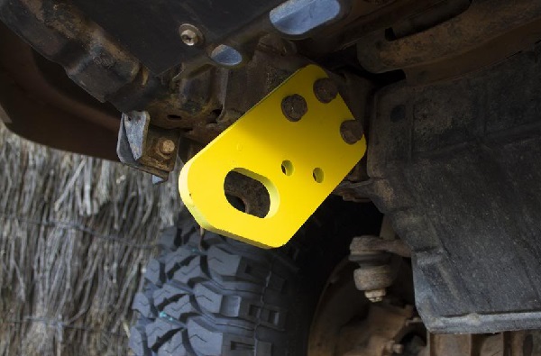

Hey Pete. if the 4.8 ones are like the ones in SJC's last pic, then they will fit, as my patrol has the two captive nut under the chassis in the same spot. Thoughts?
SJC: The Yellow points are similar to what i'm keen on aswell. Very popular in Australia those kinda recovery points.
However, the 4.8 ones seem very useful as there is no need for a shackle, which also makes it safer.

SJC, that is the 4.8 recovery point. I presume that's a new one you just bought, looking at how clean it is?
Yes, the yellow one is somewhat similar to the one I make, except that mine is esigned to work in conjunction with the bash plate I make, so it's not exactly like that.
Russ, that's quite interesting, so there seems to be another chassis variation I don't know about. I also like the idea of not needing shackles.

Peter Connan wrote:SJC, that is the 4.8 recovery point. I presume that's a new one you just bought, looking at how clean it is?
No its not mine. Got the pic of the internet. I'm still looking for one...

My 04 3.0Di has the same recovery point as the one in the last pic. I will take a pic, thought of it as it sounded like the one Peter described but then I forgot to take a pic. I thought of getting one more for the left side as well.

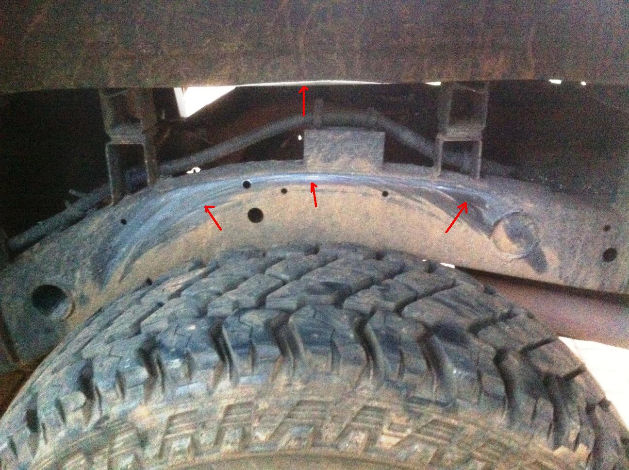

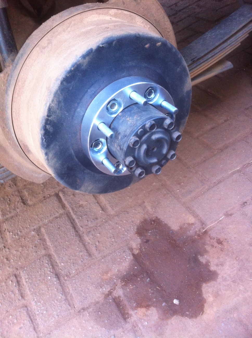

Installed the rear wheel spacers yesterday. (Got them from 4x4direct.co.za)
You can see on the 1st pic how much the wheels were rubbing prior to fitting them, this was mainly at cross axles and not during normal driving. I tested the spacers this morning with tryres fully inflated and absolutely no rubbing anymore. :thumbup:
