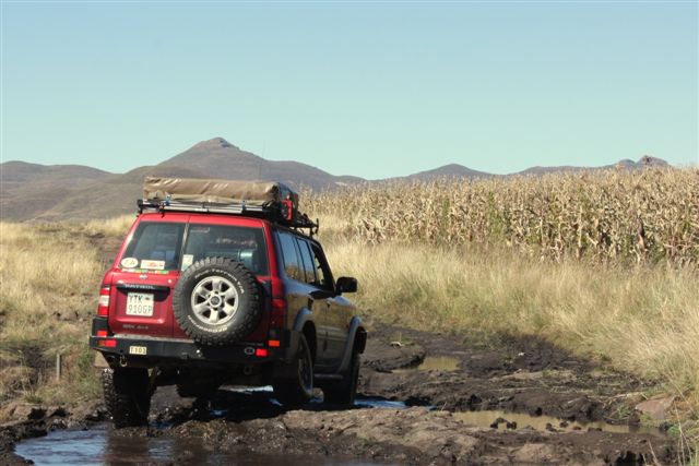

I am running the 4 inch lift Ironman Gas filled, Laod carry shocks.
At the rear is air helpers (Bladders) The car here is with a heavy load and the air helpers are at 2.5 Bar.
Articulation is still good.
I am very happy with the Ironman, no leaks still perfect even after my Serengeti trip with the very bad corrugated roads.
Photo attached is in Lesotho
Wilfred
Wilfred
