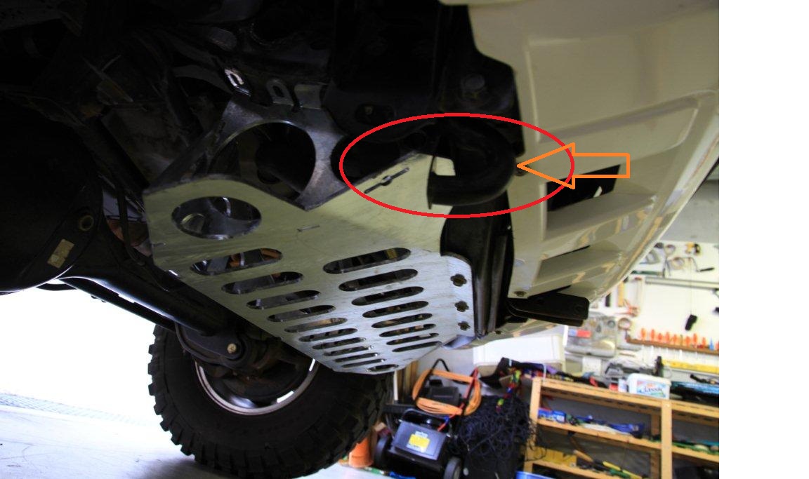

Hi Peter
Thanks, I will try a smaller different size/ shape shackle. The plates width on the right hand side restricts the shackle fitting at all and on the left hand side you can get it in but cant move up or down and needs to fit it on top/ in front of the plate. The diametre between the plate and the recovery point is quite narrow. Appreciate the help. Will take it back to 4x4 Megaworld to see if I can get one which will fit. Appreciate the help, Dave
- Posts: 6171
- Has thanked: 1141 times
- Been thanked: 1049 times
Re: Bash Plates
Dave I think I have miscommunicated...
Are you trying to use the two flat slotted plates that form part of the body mounts? I did not consider those being used as recovery points on the 4.8, because they are used to mount the factory nudge bar and almost all aftermarket bull bars.
I was talking/thinking only about the round-section recovery hook fitted to the bottom of the right-hand chassis leg by the same bolts used to hold the bash plate.

Re: Bash Plates
Hi Peter
Correct, the diameter is too narrow to fit the recovery shackle. I thought those were the only recovery points on the 4.8

Hi Dave
Do you not have one of these:

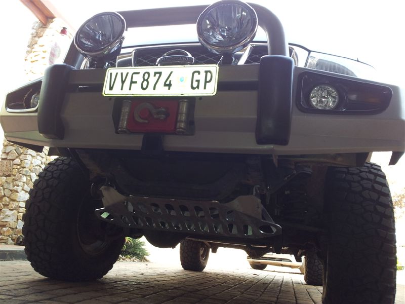

This is what I did to my bash-plate.
I did not really cut anything away, I just made a fold in it so that the bottom half turned up at the back to the horizontal. - the result is very pleasing!
see below:
see below:
- Before the mods
- 2011-08-07 13.45.17.jpg (111.18 KiB) Viewed 3210 times
- After mods1
- 2011-08-15 20.42.49.jpg (114.05 KiB) Viewed 3210 times
- After Mods2
- 2011-08-15 20.43.07.jpg (123.89 KiB) Viewed 3210 times

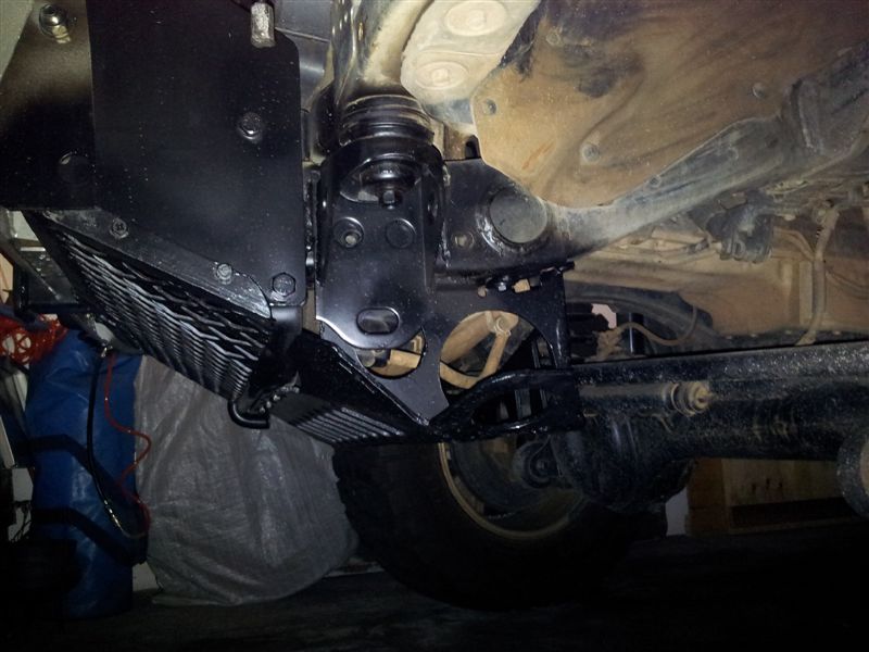

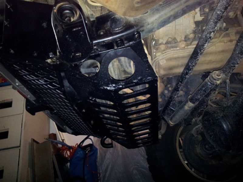

Just fitted both my PC bash plates and WOW - easy install and everything lines up perfectly , Great work Peter
Now we just need to design another plate to cover up the Auto trans sump and its a bulletproof setup
