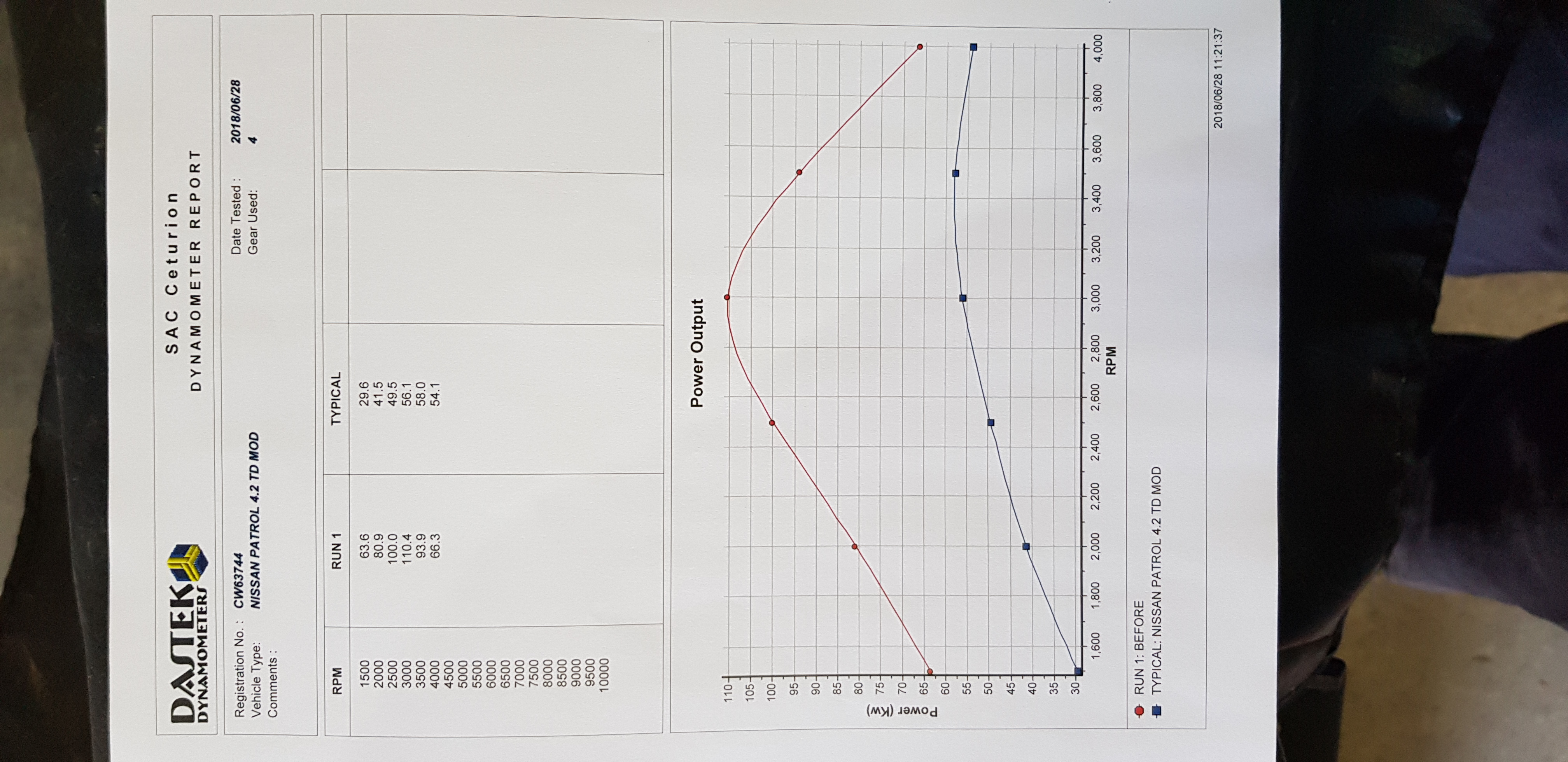

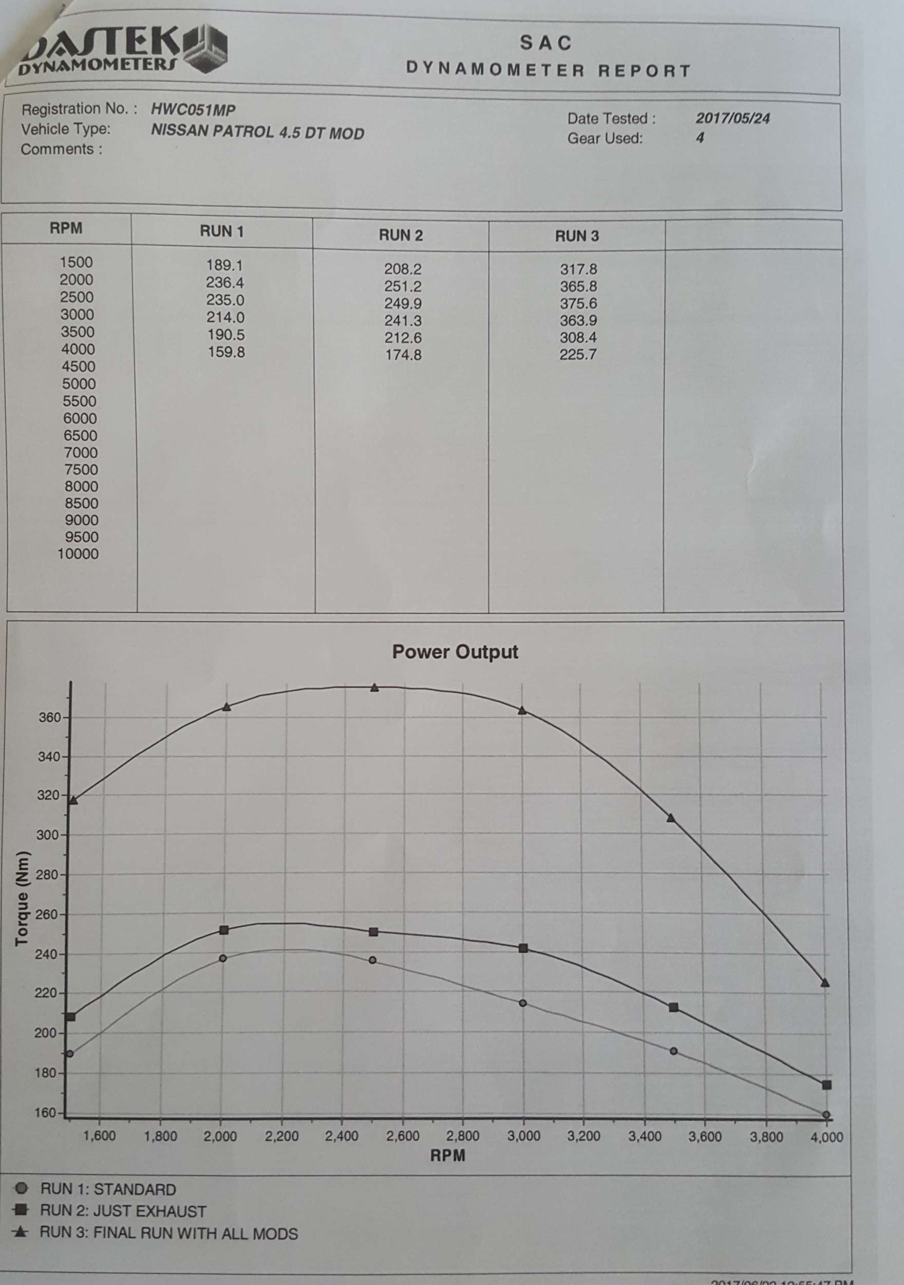

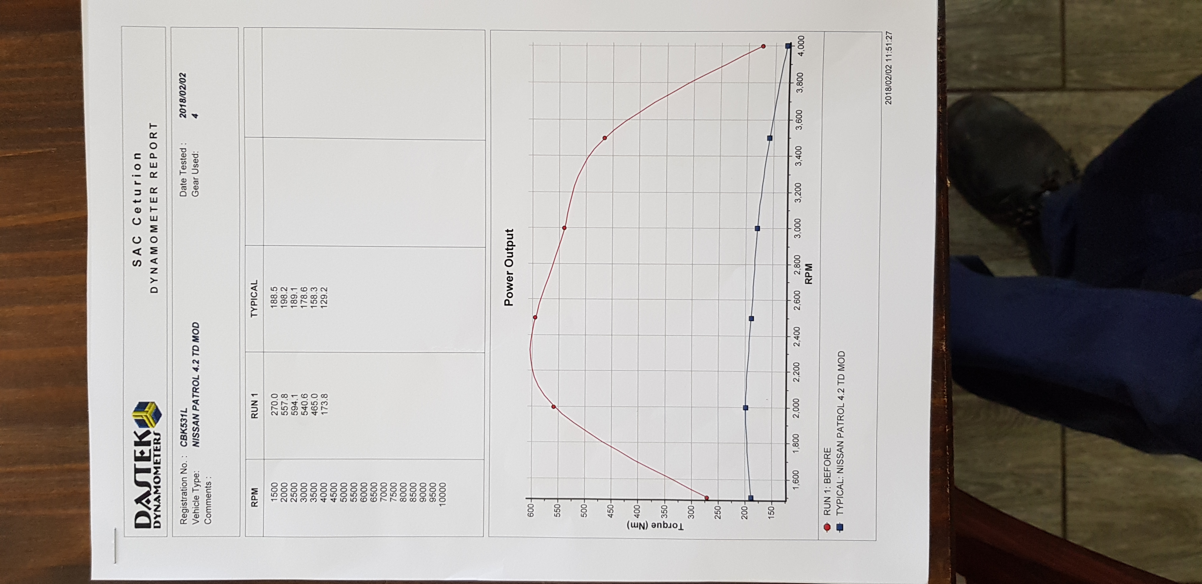

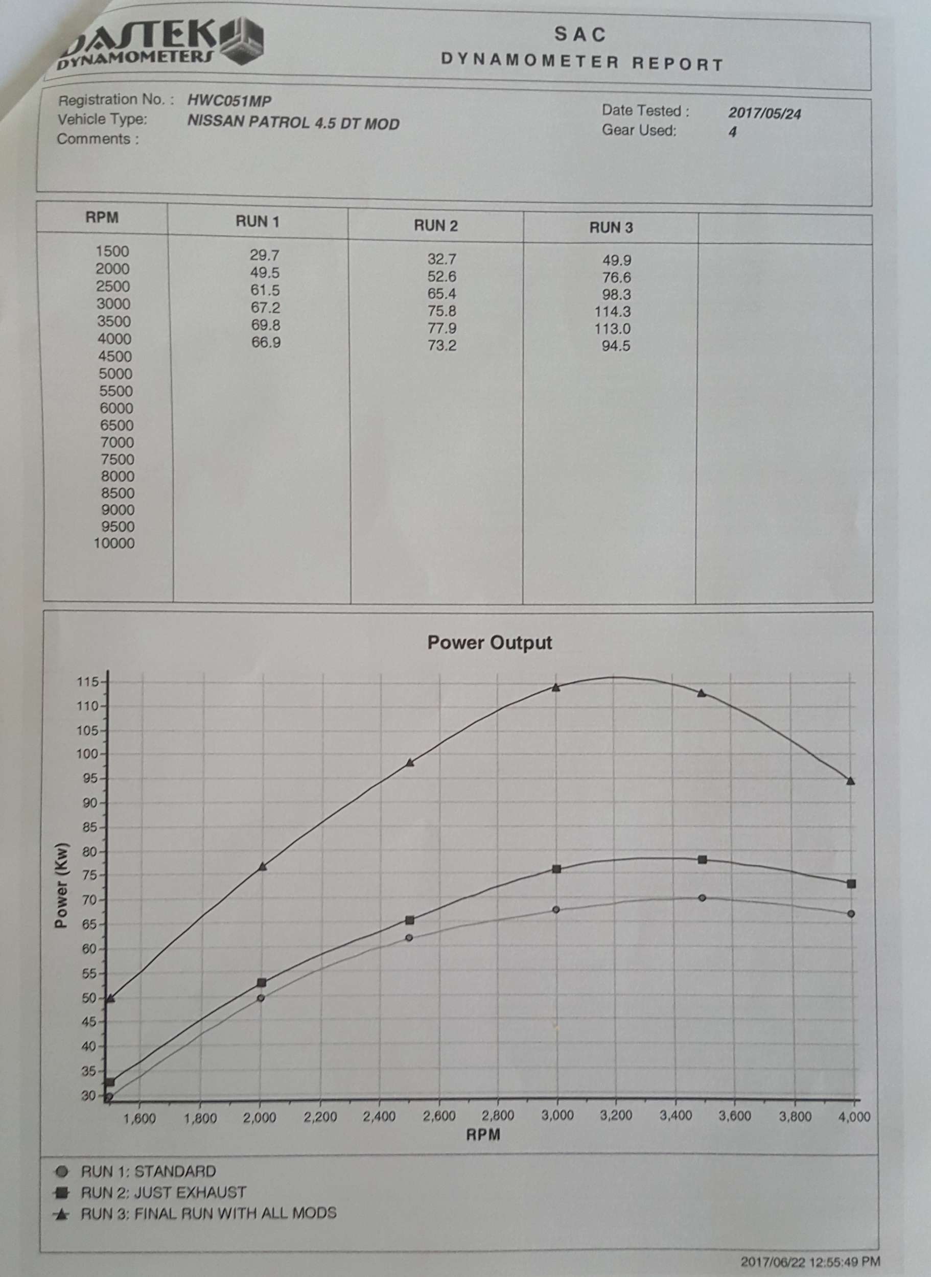

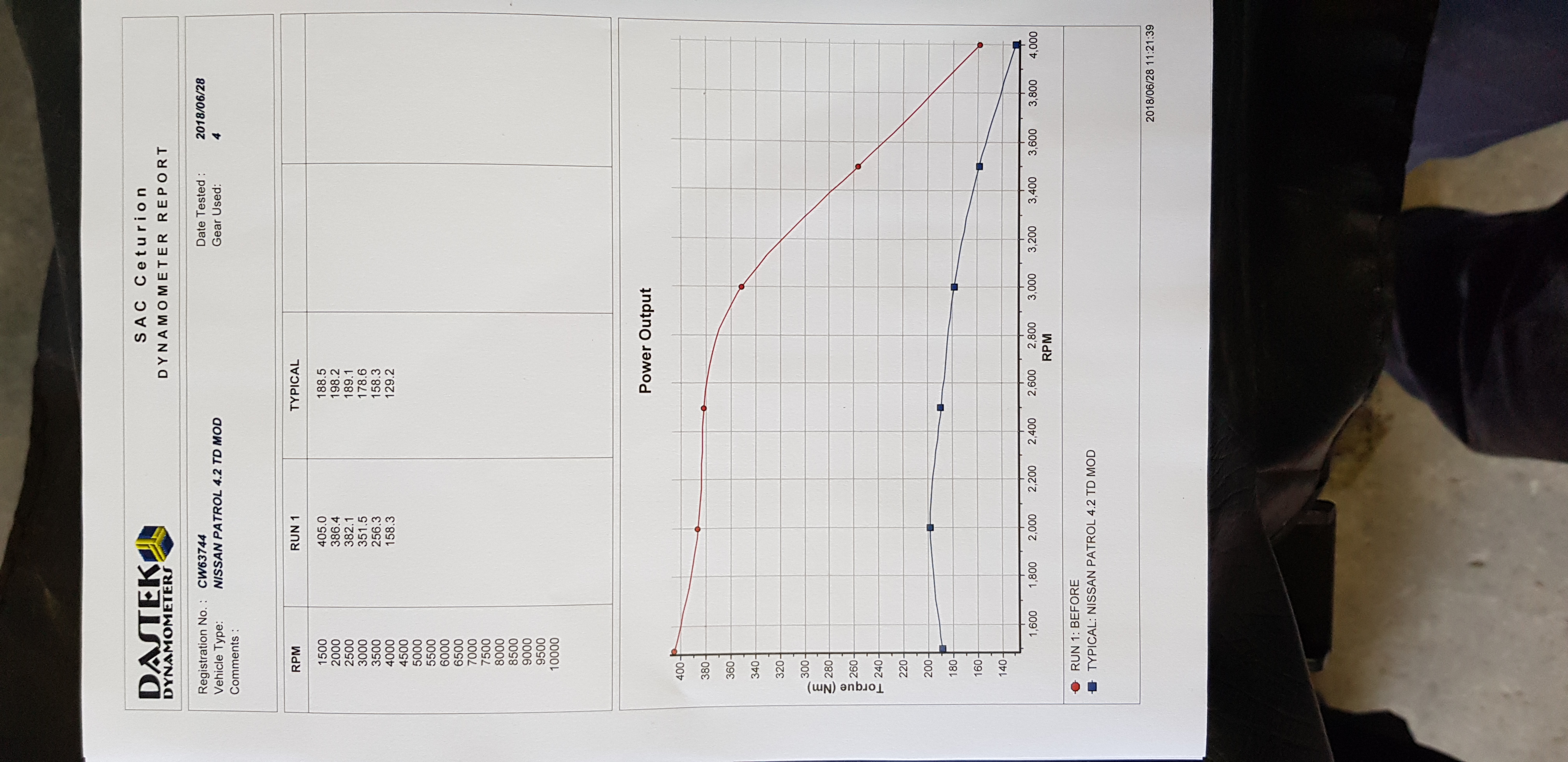

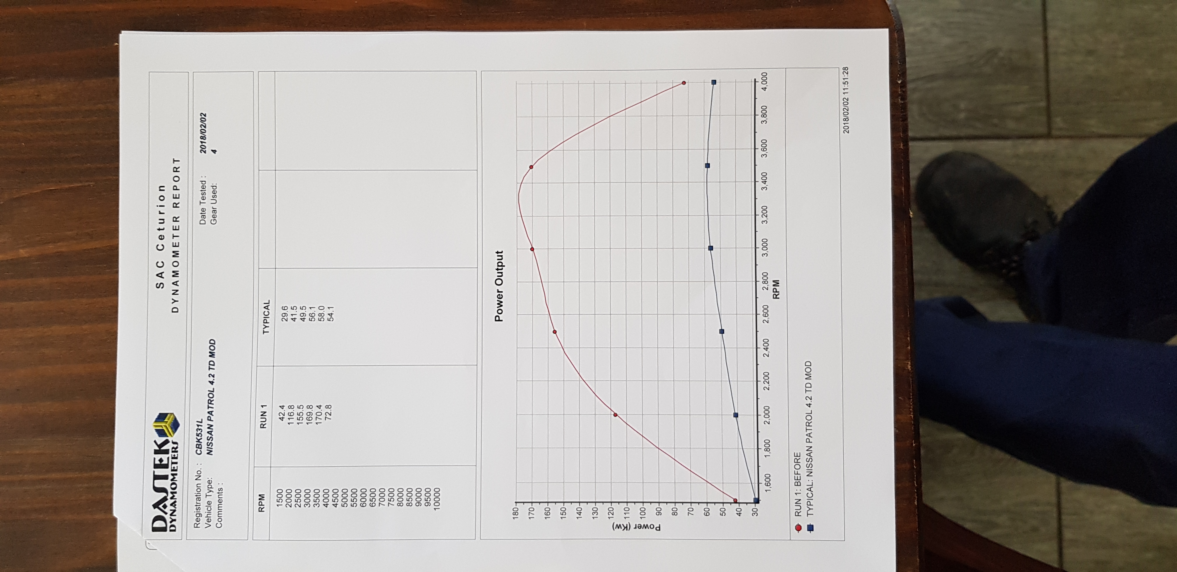

Ok so here are a cpuple of dyno runs from verious TD42's.
All were done in 4th gear.
I think all have a pre and post run.
The reason why I am not sure how they get their torque figure is because comparing two vehicles, the one makes 110kw and 350Nm at one stage where another makes 120kw and 557Nm....... does not have any relation.

Re: 4.8L Performance upgrade options
I wasn't saying all will be the same..
What I was saying is if for eg. one Patrol makes exactly the same kw at the same Rpm as another their Torque graph must be the same or very very similar.
It has to be.
Similar peak power must produce similar peak torque.
While these are all turbo charged 4.2 Diesels not one is the same, they are all over the place and I cannot provide any info as to why.
Is it different wheels that make it so random?
Normally, similar vehicle produce similar results, some a little better, some the converse.
The graph showing 180 kw at 3300 rpm on the wheels is questionable in my opinion and the torque drop off looks too severe.
On the other two at 3000 RPM they are within 5 kw peak but like you say there is no correlation as to the Torque curve.
How do you with such random results interpret anything?
Just a question, the one showing huge power, is that a completely different Turbo to the other two as that will account?
Whatever.. power on that one looks amazing.. Can it be believed though is the question?
Speaking to Steven, he will tell you that this certain car will make that..give or take a few.. anything out of that would be be suspect.
It has to be.
- Posts: 6168
- Has thanked: 1141 times
- Been thanked: 1049 times
Power and torque on all the graphs above tie up exactly.
I calculated the torque of each engine from the power at two points, being 2000RPM and the point at which it makes the highest power on the tables rather than the graphs, and the results do tie up.
And for reference, 180KW at 3300rpm translates to 521Nm, which seems to be what the graph says too.
This is why N/A petrol engines tend to have higher power outputs than TDI's of the same capacity. They usually make their peak torques at higher RPM's, but more importantly, their torque doesn't drop off as rapidly as the TDI's...
