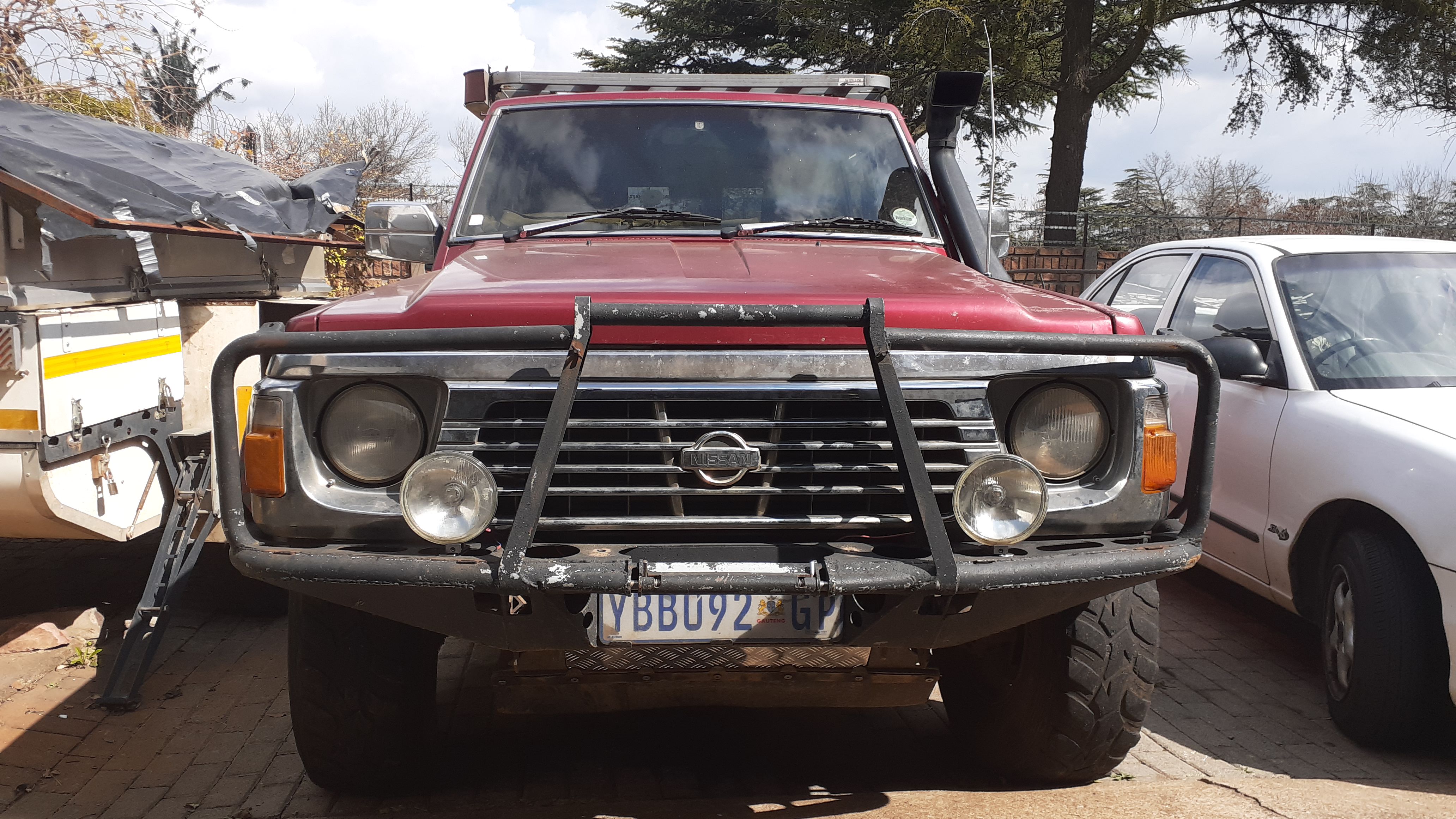

Yes, but you need quite a lot of it and where do you carry all that water? And what happens when the pump fails or it runs out? That kind of thing is fine on a race car, but not for long trips.offroadbiker wrote: ↑26 Apr 2020 12:06 Would water onto the radiator help to cool it down?
Sent from my SM-A530F using Tapatalk
Graham, my temps are similar to Tijmens. I believe they are actually similar to Dirk's as well, but he travels slower than I want to. So this is a known issue of the GQ.
And to be honest, it is possible to control the problem with one's right foot. As mentioned though, I am an impatiant bugger. I want to get the long tar sections before one gets into the bush over and done with with the minimum fuss, stress and wasted time possible.
Next mod is temporarily done. Spotlights have been moved away from the radiator.

Graham, in the last couple of months I have had the opportunity to drive Michael's car for a day and Tinus's bakkie on quite a lng trip, down to Hoedspruit and back.
Both have substantially less issues with temperatures than mine, despie having considerably more power, and me using that additional power.
I think it is primarily a GQ thing, and I think there are three major contributing factors:
1) The GU has a bigger radiator.
2) The GU has a longer nose. Thus the three radiators have considerably bigger gaps between them. In the GQ, the radiators almost touch eqch other.
3) This is something I may well be wrong about, but if you look at a GQ's grill, the top 100mm is solid. The total height of the grill is only about 300mm, and I think a lot of the air that could possibly go through the radiator is forced over the top of the bonnet.
I could be wrong about this last bit, because air does funny things sometimes, but plans are afoot to test this theory. However, it can only be done after lock-down ends.
