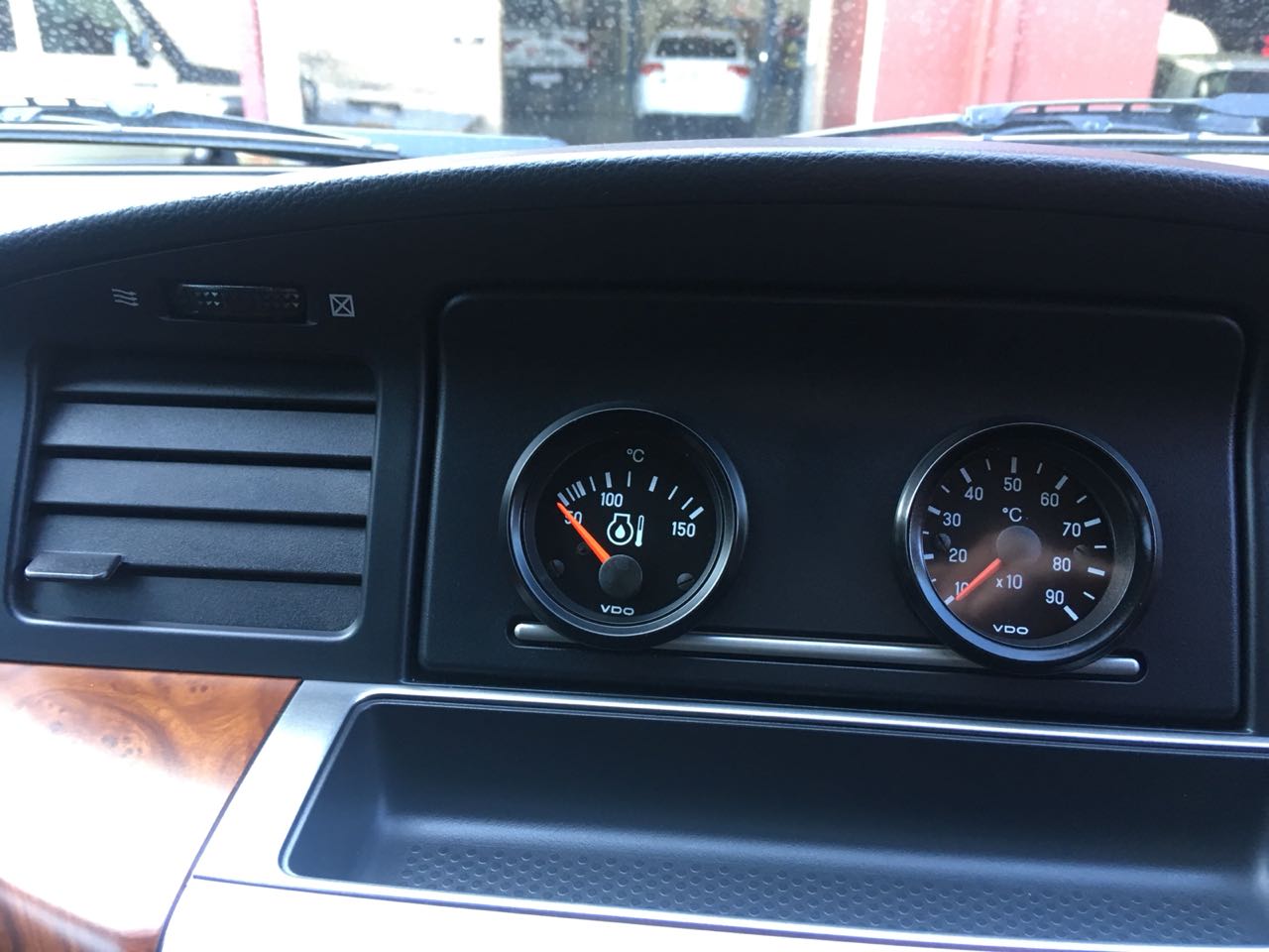

Hope I am not taking away from Carlo's thread
Attached see ling of my Patrol dyno tuned today.
First run after fitment at RGM Motorsport
Tomorrow will be a couple of hours of Road Testing and applying settings "on the road'' where you car is set up "tuned' in real world driving conditions
And then finally back onto the Dyno for final checking that you havent ''lost'' anything or to carry out improvements in a more controlled environment.
I'm showing 249 kw on the wheels, you will see it in the video linked below.
I'll post graphs when I get them but still a week or two away as I'm doing all diff oils, trf case etc. etc and changing engine oil to Liqui Moly 5w40 after everything has been done.
Didn't want to run new spec oil in the engine and have it screaming on the Dyno for the first.
So at the moment ordinary 15w40 in there.
In 10 000 km time I'll be making even more power.
Also plut in an EGT Guage and oil temp Guage to monitor everything, went analogue as personally I hate the look of the madman.
Would have been better if fitted slightly higher but the radius and meat behind the hinge was a bit in the way.
Still.. I will live with it for a while and see..
