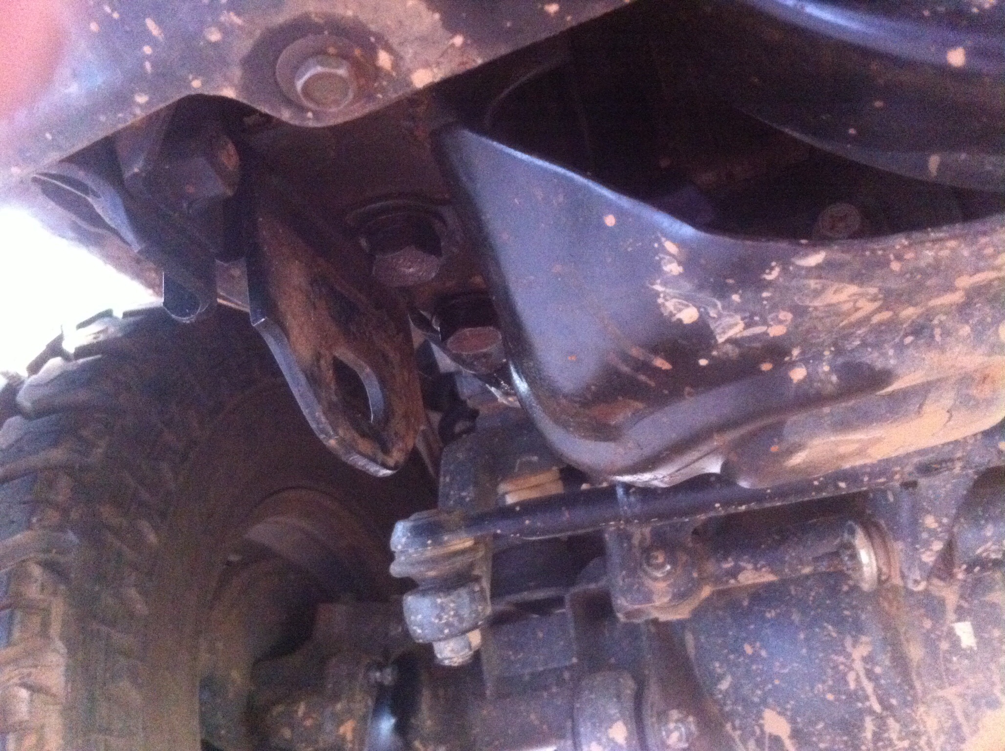

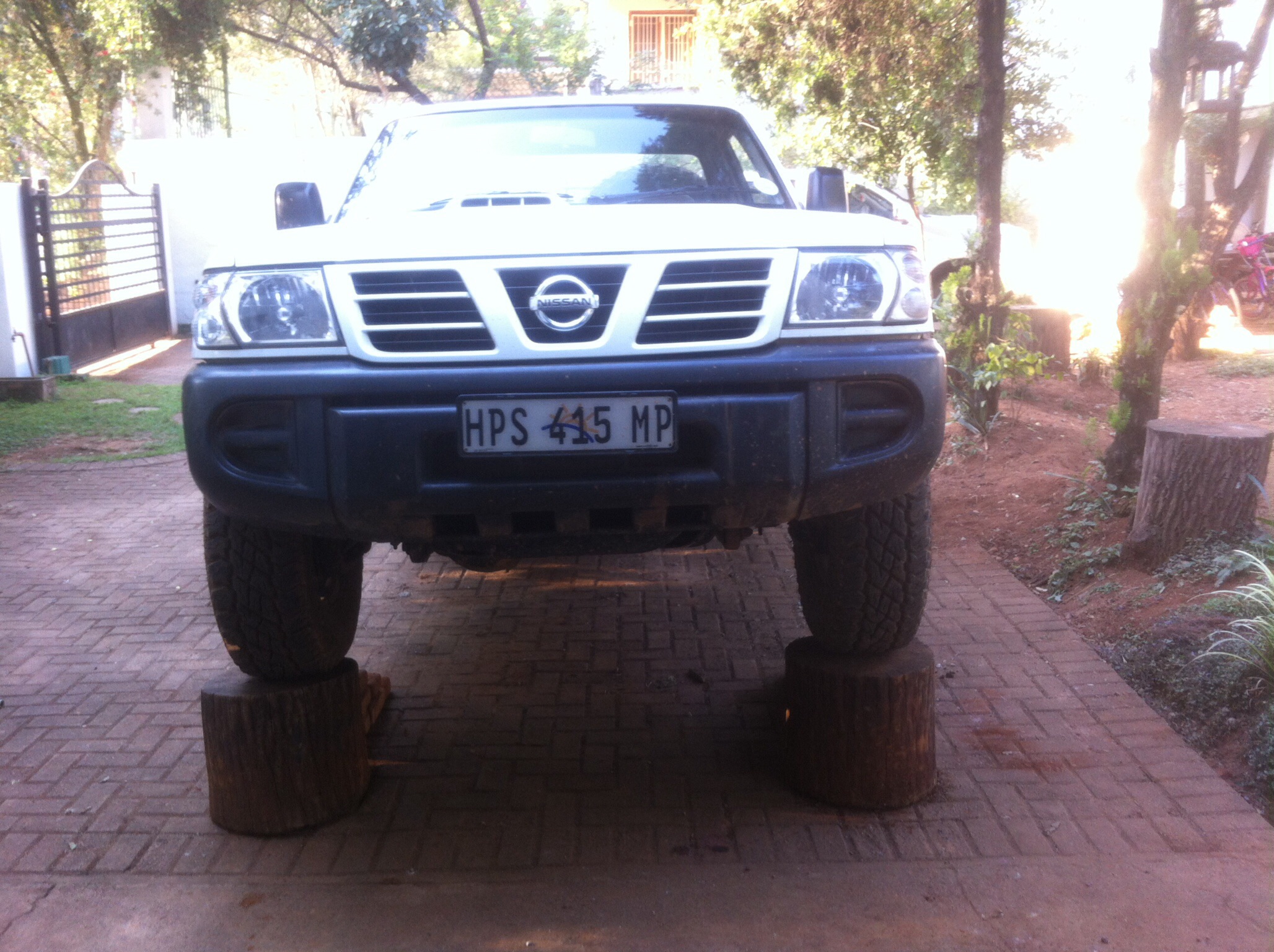

Decided to remove the bullbar. Now i must just get a recovery hook. (Or have someone make me a recovery point.)

I think it looks 10x better without that tube bar bud. Nice!... I looked at some recovery points from 4x4 MegaWorld the other day. They had 3 bolt holes, but as seen in your pic, the patrol would use two of them, so the 3rd could be ground off i guess, as it would be longer than needed.
The ones 4x4MegaBucks were selling were basically just 8-10mm plate bent in a radius at 90' with a good size hole for your shackles and two holes for your HT bolts (on the chassis). But any engineer should be able to make this up for you. However, saying that,.. im not sure if it needs to be oil quenched, shot peened or what not, in order to make them extremely tough... perhaps one of the engineers on here could advise.
The Pigtail on the Patrol (Not shown) is good for using a pull strap but not for snatching. The point shown in your pic is purely for transportation pick points during shipment from japan.

It looks from your photos as if Nissan are now using the 4.8 Patrol's chassis as the basis for the pickup chassis.
Therefore, the 4.8's standard recovery points should fit.They use the same bolt holes that hold the plate under the radiator. You can buy them from Nissan for about R550 each, and I promise they are stronger than anything you can buy anywhere else.
You will need to buy longer bolts as well, M14 x 2 (I think but the first fine thread anyway), you will need 35mm long or more.

Re: My Patrol Pickup thread...
Pete,... Please explain if you able to ....
1) What is different about the 4.8 chassis to all other Patrol chassis?
2) FRom looking at the pics, what indicates to you that the Pickup shares the same possible chassis?
3) Any idea what the 4.8 recovery points look like?
4) If i was to purchase 4.8 recovery points from Nissan would i be able to safely/confidently snatch a loaded patrol pickup out of a mud bog? (i'm very nervous of snatches at the best of times so i'm always looking for the strongest/safest additions to my truck).
5)Would they attach at the two bolts shown in the pic? or elsewhere?
Anyone got a pic?
Anyone got a pic?
