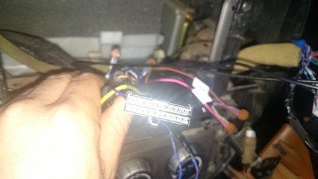

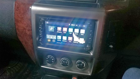

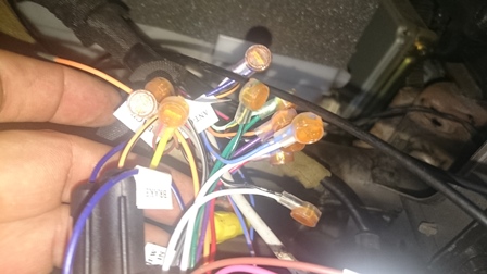

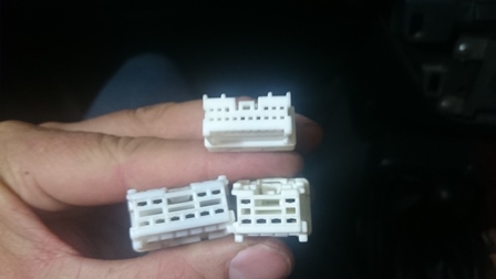

Hi guys
Thought I'd add to this thread instead of creating a new one. Last week I got a gift from a Chinese customer/friend in Hong Kong after complaining about the old school tape deck/cd shuttle in my 4.8. It's basically an Android tablet that plays DVD's. Total Chinese job with no branding whatsoever, but the damn thing works brilliantly! For now anyway. Even the steering wheel controls function correctly. GPS and navigation already has SA loaded, but you can connect to the internet and download any update or other navigation system you prefer.
Biggest mission was sorting the wiring, which was of course totally different. Luckily one of the previous owners already had the wires cut and joined again, so I didn't feel too bad about removing the old connectors to attach to the new one.
Finding the correct version of the workshop manual and which supplement to use took the longest, but eventually found the correct one and joined the old and new with Scotchlocs. Thought I'd post the wiring and connector setup on here in case someone ever needs it.
